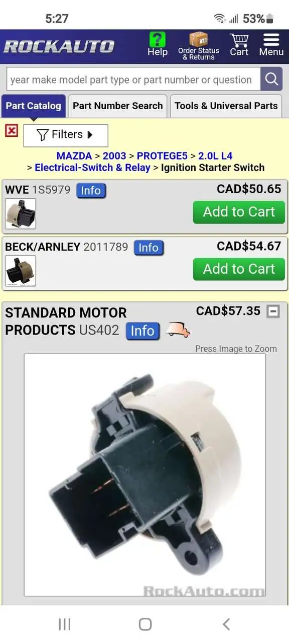

I'm thinking ignition switch.
You're right may be the cause of the car dying, but I guess it'll leave me still with the voltage problem if I change it
Probably, but it's possible that a bad ignition switch can cause the alternator to misread the voltage (because the regulator is in the ECU)
If the ECU is reading voltage coming from a faulty ignition switch a voltage drop across a bad connection in the switch can make the ECU think the voltage is lower than it is.
The ignition switch is relatively cheap (37-43 USD) and is pretty easy to replace.
If that doesn't fix your problem, then look into a new alternator.
A Lot of people have had to replace their ignition starter switch.
It's 20 years old and it wears out causing all kinds of weird electrical problems, and it's a safety issue.

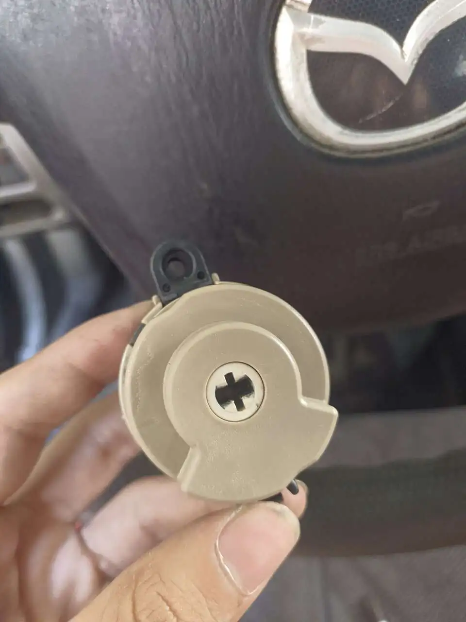

Replaced the ignition switch (old has some kind of grease as in other thread)and it started right up and reached normal temp. I shut it off and started again without issues but after some time it died and didn't wanted to start again, after some minutes it worked again... So I guess it wasn't the switch, still need a voltage reading

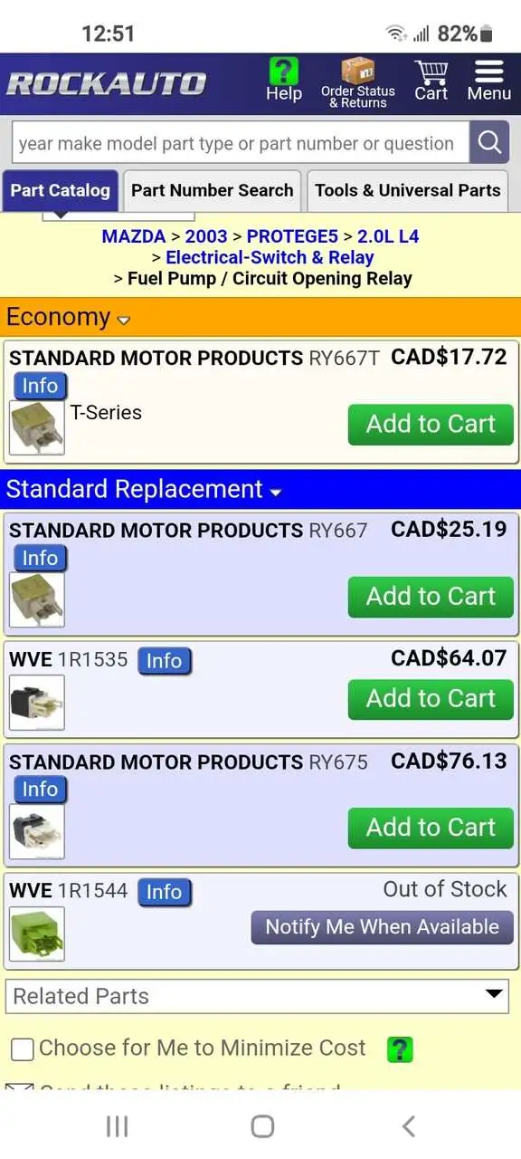

Also my fuel pump relay may not be working properly, I put the keys in on position and doesn't hear anything from the pump (i lifted the cover), only after I start the car I can hear a soft hmmm. Tried the test with the DLC and the keys in On position and a more loud sound can be heared from the pump
Good call.
I forgot about that.

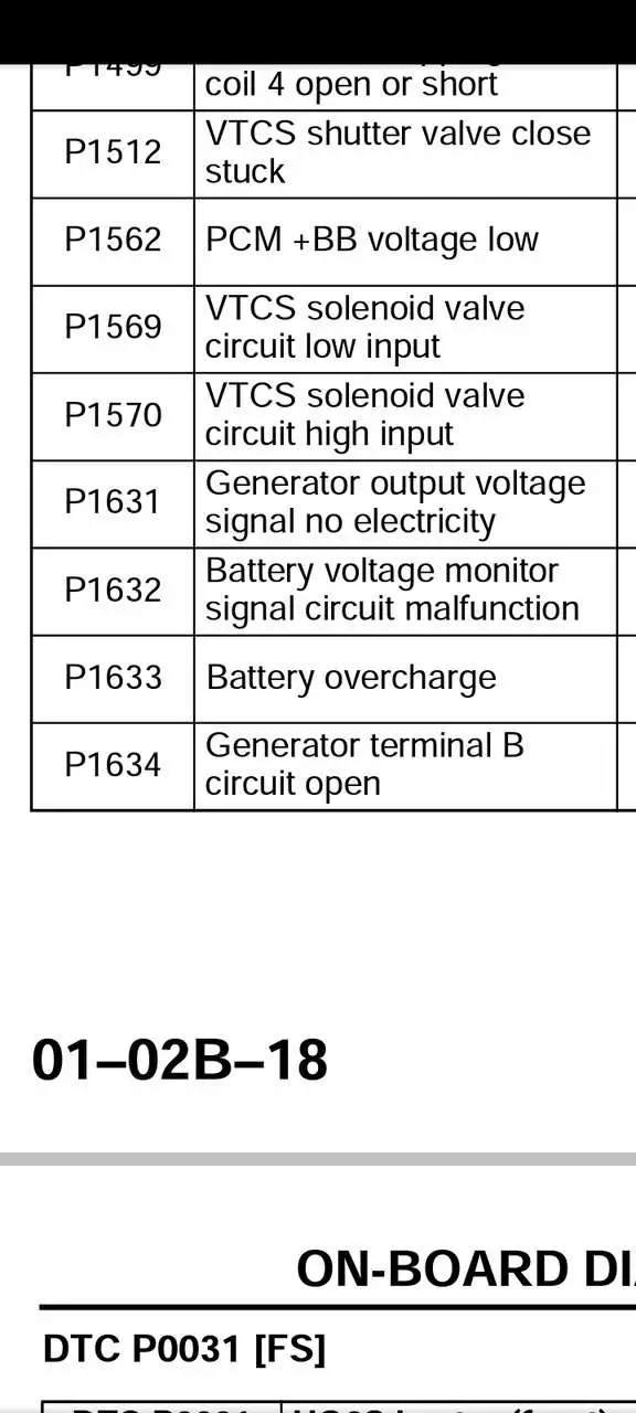

The battery light does come on if the voltage climbs too high.
It happened on my car when my alternator crapped out and the voltage shot up to 17.5 Volts.
I don't know what the voltage has to be to trigger the battery light?

That didn't resolved the random no start, haven't been able to find a pump relay (ironic with the popularity of the car where I live). Mine is a L kind connector.

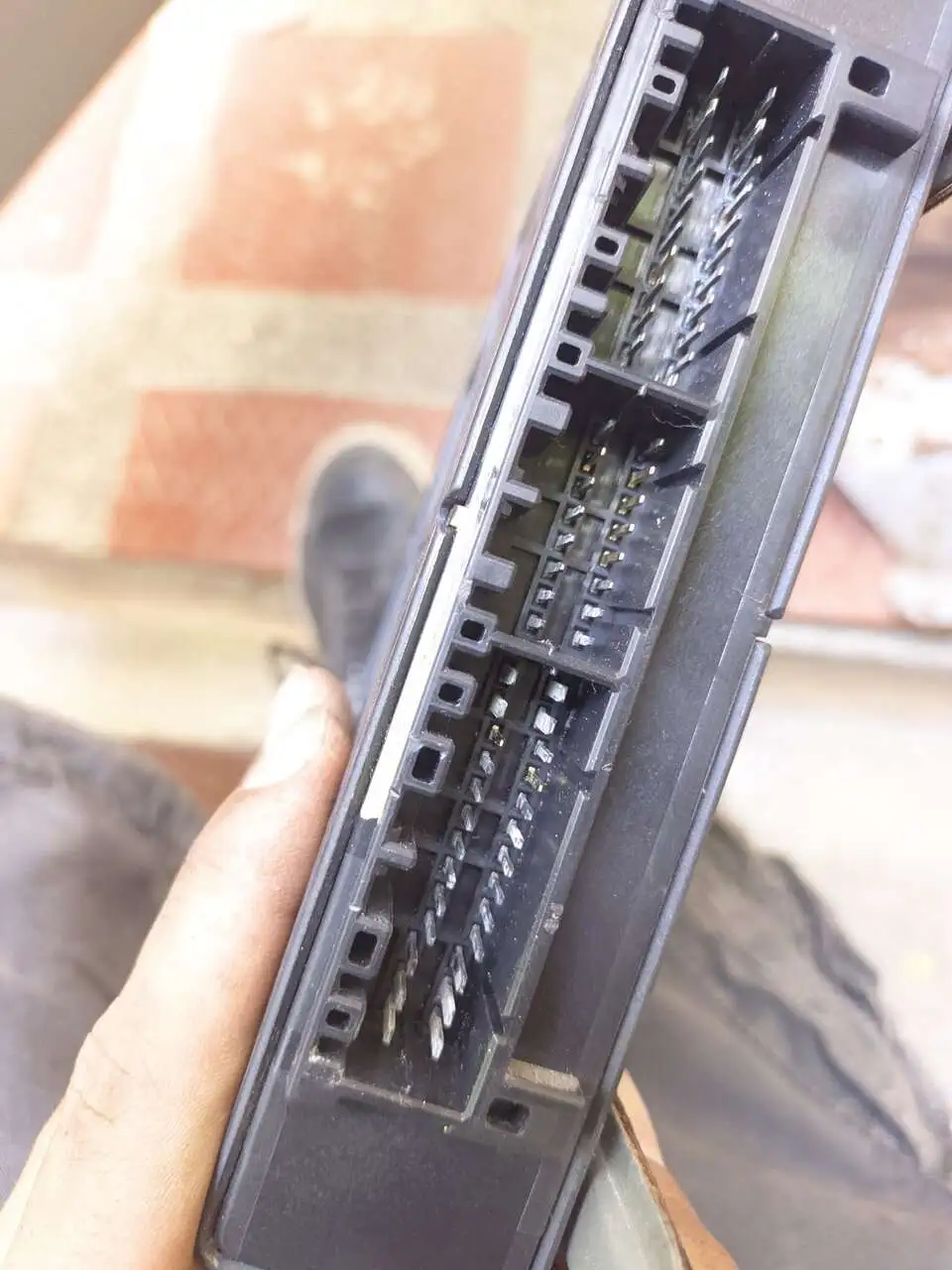

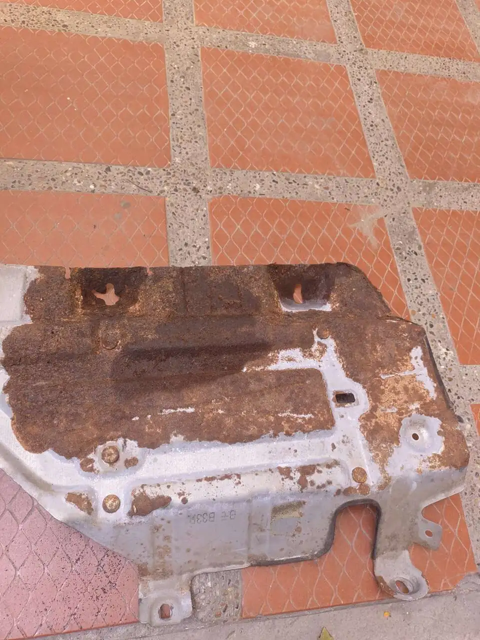

Wanted to check the ecu and found rust... But the ecu doesn't look bad, sprayed some contact cleaner and reconnected it. Now something weird, if I move the ecu the battery light comes on but not sure what is the cause

Tried to find a new Main relay with no vail, ended buying a new one for a different car that the shop said will work. So I'm testing that one but as the problem is not consistent may take a while to knew for sure

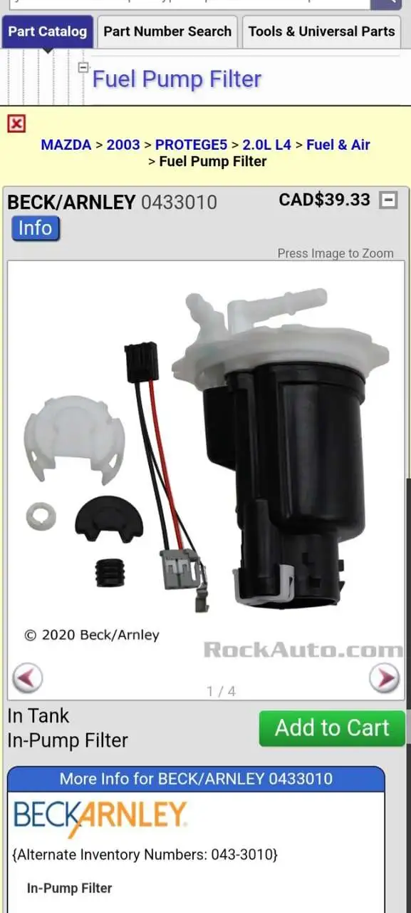

I'm thinking my next option is to change the whole fuel housing in case it's clogged or something. But someone recommend me to add first an second filter between the fuel tank and fuel rail so it can be assured is the housing.
Has anybody tried this on the Protege? What is probably the best location for the second filter?

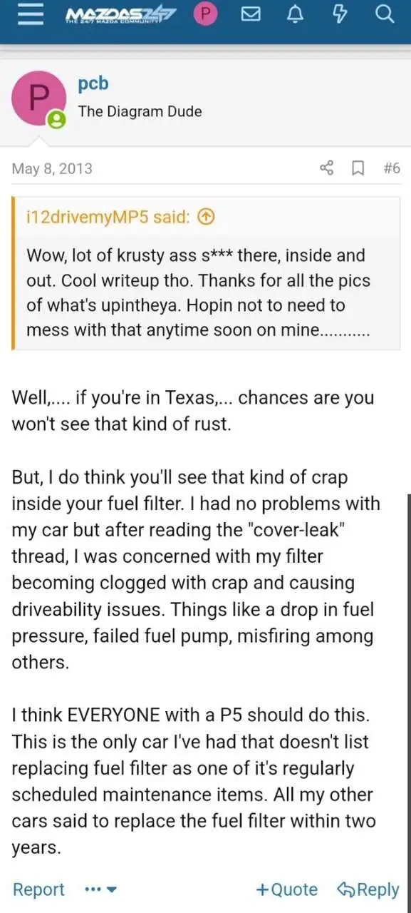

If your car is stalling due a lack of fuel pressure caused by a clogged high pressure fuel filter, then adding a second in-line fuel filter won't help.
A proper high pressure fuel filter is less than $30 USD at Rockauto and takes less than half an hour to replace if your car isn't a rusty turd like mine was.
Make sure that you use a proper JIS screwdriver or you will strip the heads of the screws, then it will take A LOT longer to replace.
The second filter is to 'probe' if the high pression filter is the problem.
The idea is placing it in a location such that if a stall happens I can check it to see if there is fuel or it just happens that the main filter is clogged.
The price for me is more like 70 usd, so i guess is better to be sure before

I replaced my fuel filter/fuel pump housing without having any driveability issues.
I figured that it was like an air filter or an oil filter.
Remember it's just the housing, it's not the entire fuel sending unit.
Some guys were being sold the entire fuel sending unit.
Even the Mazda mechanics didn't know that the filter housing itself could be replaced.
Generally, the fuel pump is shot after being stressed pushing fuel through a clogged filter, so they sell you an entire fuel sending unit for up to $700.
