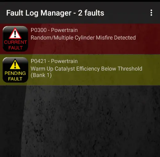

Got the scanner in the mail yesterday but I didn't get home from work until after dark. Here's what I got for codes
