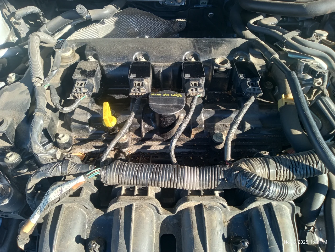

I took the engine cover off today. Never considered doing so until I read a discussion here about rodents under the hood.
The white insulation material behind the cover is breaking down into dust particles. I don't see them settle on the engine, but they shed upon the lightest touch.
The cover doesn't seem to help keep debris out. I use a vacuum and toothbrush to clean the top side. It also doesn't seem to help direct air flow for cooling purposes, the insulation layer is puffy and leaves minimal space for air flow. I wonder if the debris can exit more freely without the cover.
It probably does help reduce the noise. I am ok with noise. On my MINI, I run a DIY short ram intake (no box or shield) that is quite loud.
There's no lining on my hood. I read somewhere about how the cover and lining help keep heat away from the hood to protect the paint. My paint is white. There are already two blemishes left by a metal object that bounced off the road. If the hood looks any worse, I will just cover it with a flexible solar panel.
Edit: The engine sounds the same without the cover. The removal did not impact water/oil/atf temperature on my 150+ miles drive.

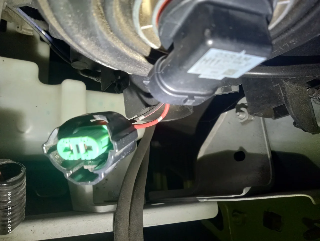

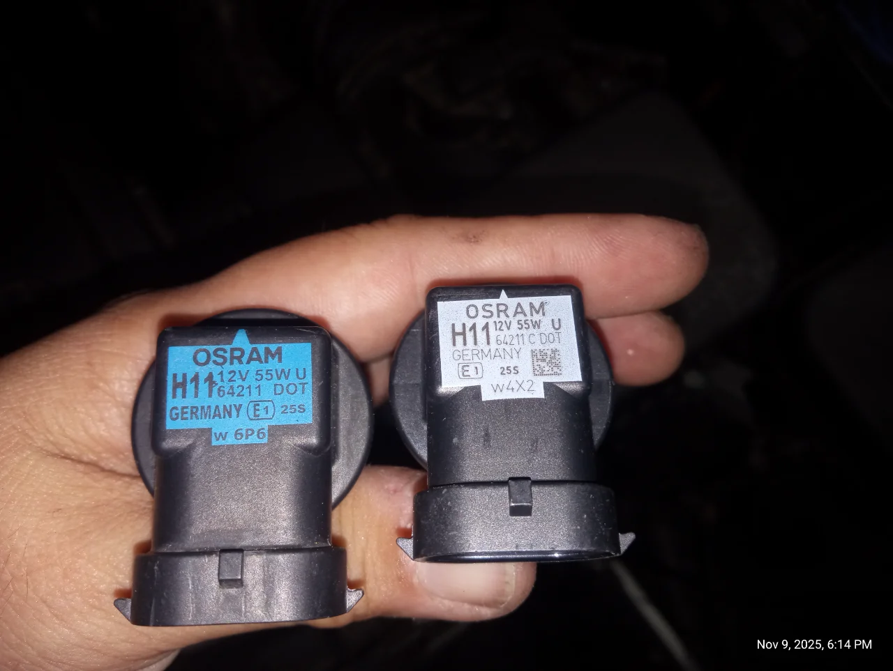

Replaced the pair of headlight bulbs (low beam) because the driver side is burnt out. Wanted oem (warm white) look and got exactly that. The low beams are the outer set of lights. Press down the tab on the electrical connector to pull it down. The few wires to the connector are not wrapped in tape (from factory) because the location does not provide a good footing for rodents to chew on these. I cut a short section of sleeve to wrap them anyway. Better safe than sorry if a turbo charged rat comes along.
Also replaced the intake air filter. Don't know how many miles I have on this one, but might as well put it in the same entry. While watching a YouTube video a few days ago someone commented that a dirty intake air filter is filtering out more debris, while a clean filter allows more debris to go through, basically the dirtier the better. For two seconds I thought that makes sense. 🤣

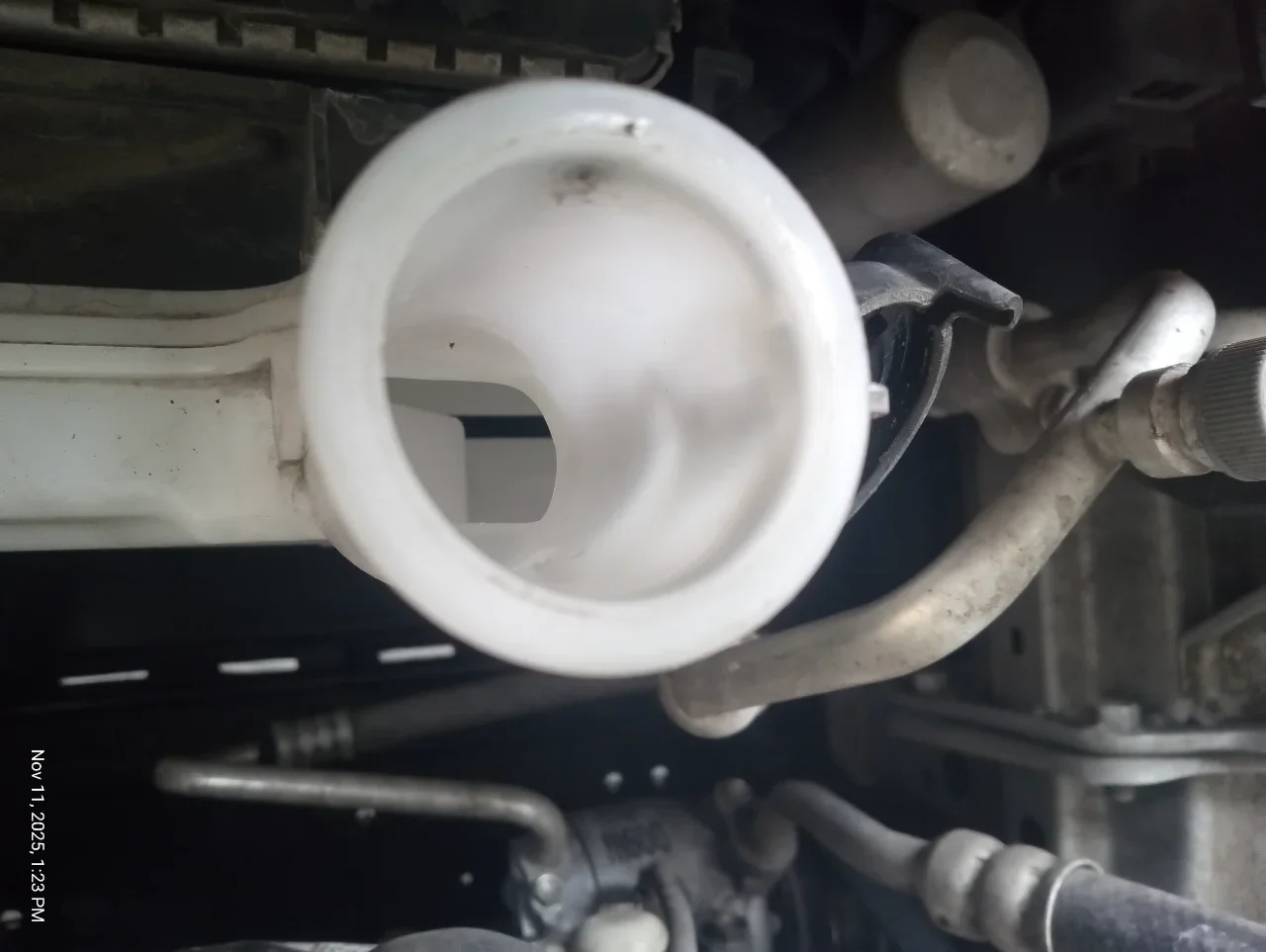

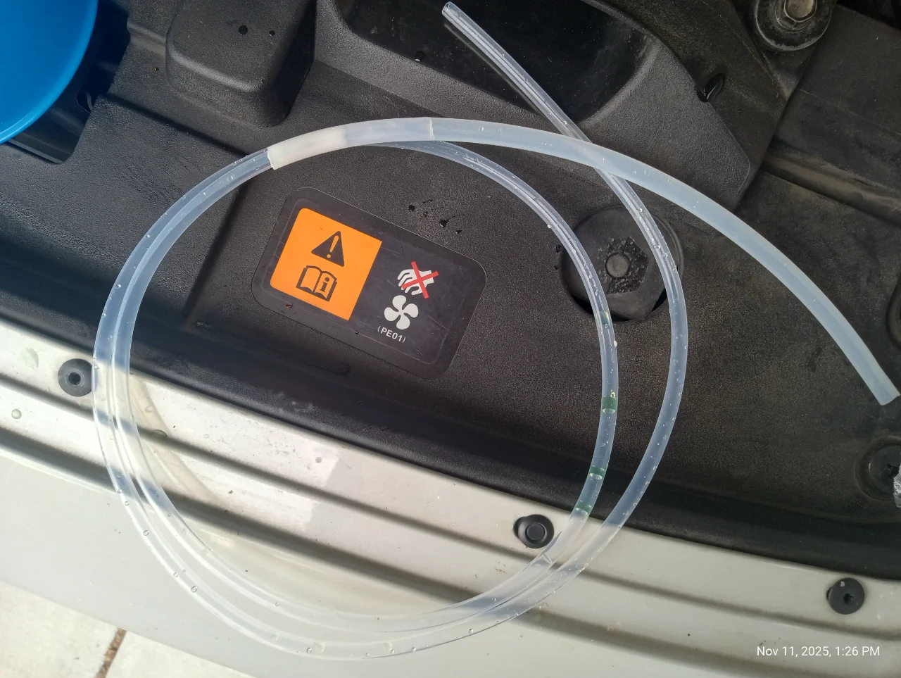

Tried using this USB fluid transfer pump with the coolant. It has a soft hose to dump fluid and a skinny hose (with a section of soft hose as the lead) to draw fluid. It would have fit into any narrow diameter opening that is damn STRAIGHT.
The radiator cap sits on a short arm that extends from the radiator itself. The skinny hose is a bit too stiff to get in the L. I was only able to draw a small amount of coolant out. It was enough for me to add two oz of cooling agent. My other two street cars are both running distilled water mixed with cooling agents.
Then I tried to draw from the reservoir. Again, it is not a STRAIGHT shot from the cap, there's some barrier blocking the way. I tried aiming for the gap before poking the skinny hose randomly, hoping that it'd squeeze by the barrier. It worked and I got almost everything out from the reservoir. I don't think Mazda engineers wanted us to do this from the top. 🤦
I believe the pump will work with engine oil and ATF. I know that the ATF port to pan is straight. I hope there's nothing tricky down the oil dipstick hole. The skinny hose might not be able to pick up chunks of sludges though, if there's any.
How do you clean the pump? I was thinking if I have to buy one pump for each fluid (I.e., oil/ATF/coolant). I can also just pump a small amount of the different fluid to run it through and then dump that fluid. It's hard to tell how much fluid remains in the pump itself. The hose are easy.
My next ATF drain/fill will be with this pump.
Edit: For the ATF, I would cut a 2 ft section of soft hose to use as the inlet. It can go in the dipstick and rest in the pan. The skinny hose is too stiff and tends to coil up. I can try to tame it though.

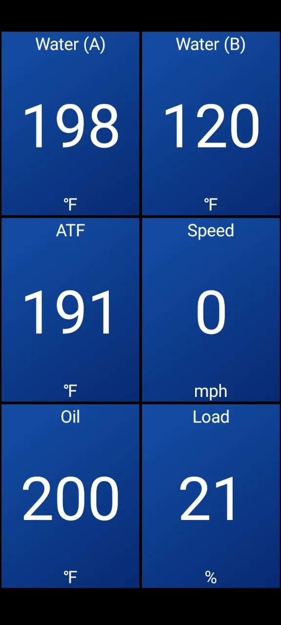

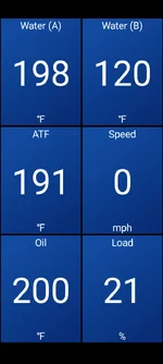

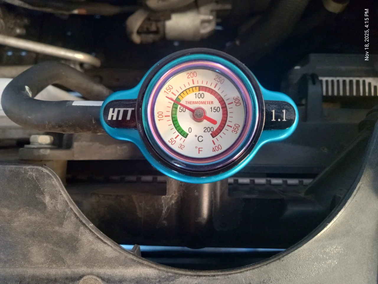

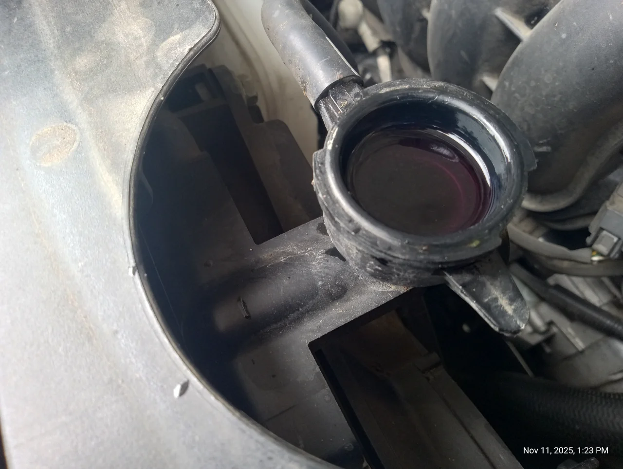

Replaced the original radiator cap at 167K+ miles. When I put the new one on, I realized that the original one had become quite loose around the plastic neck. No fluid leaks. The new one was so tight that I thought I got the wrong size. The coolant level was all the way up for the temp sensor to be fully immersed.
Not sure the displayed temp is accurate. This is within ten minutes after shutting the engine off at 198. Could the temp have dropped to 140 in 10 minutes? Was 198 not the actual temp? 😅

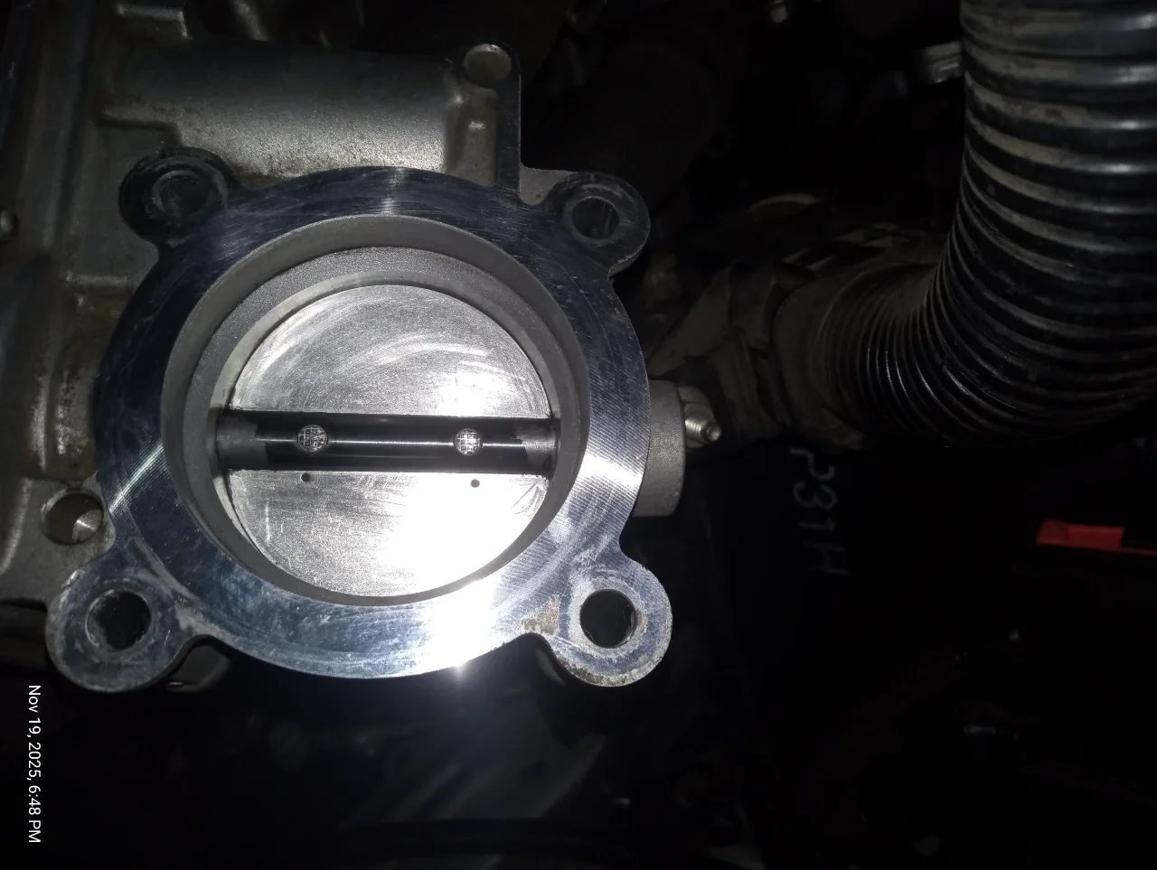

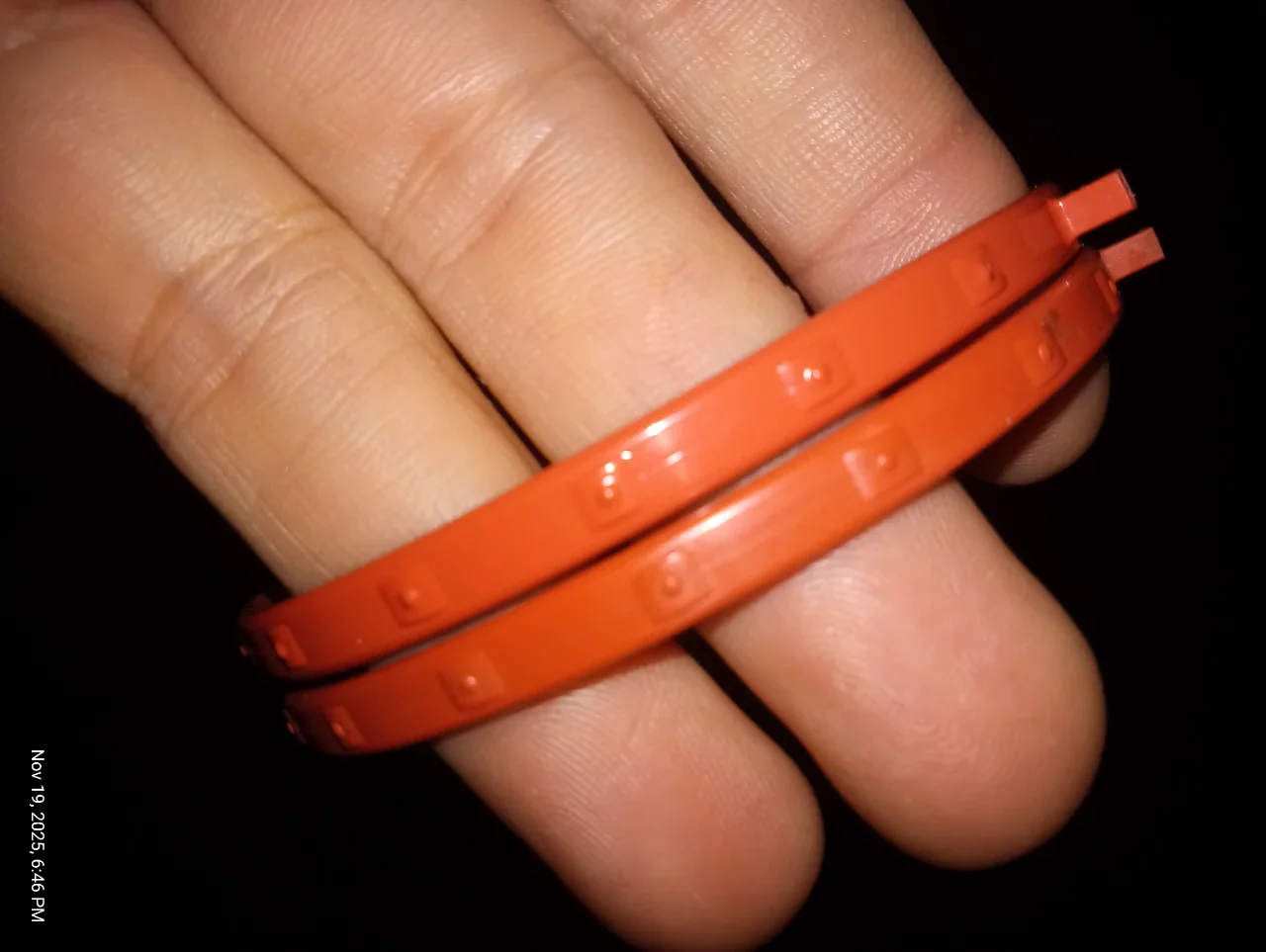

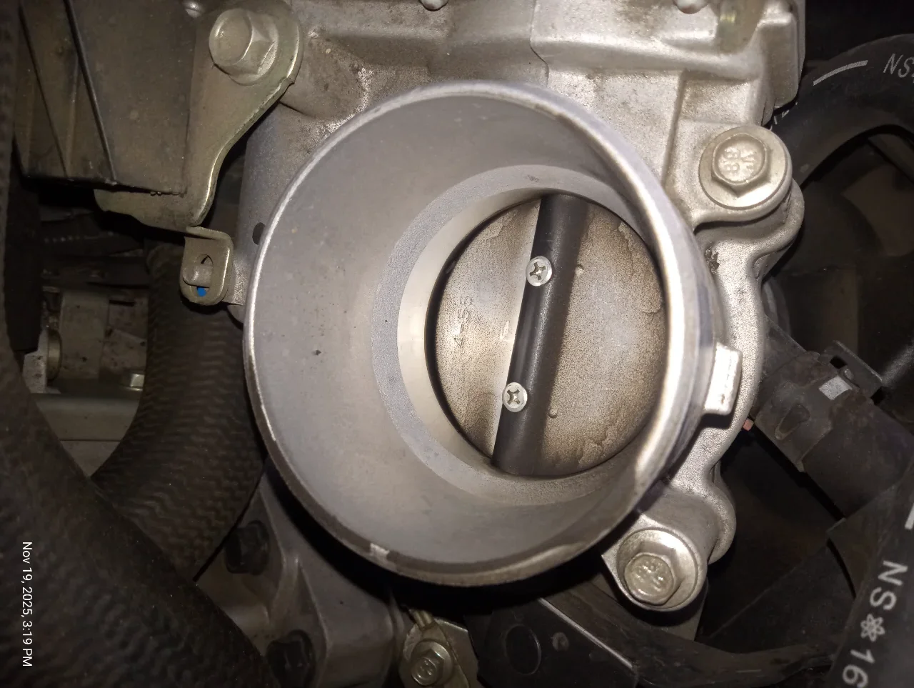

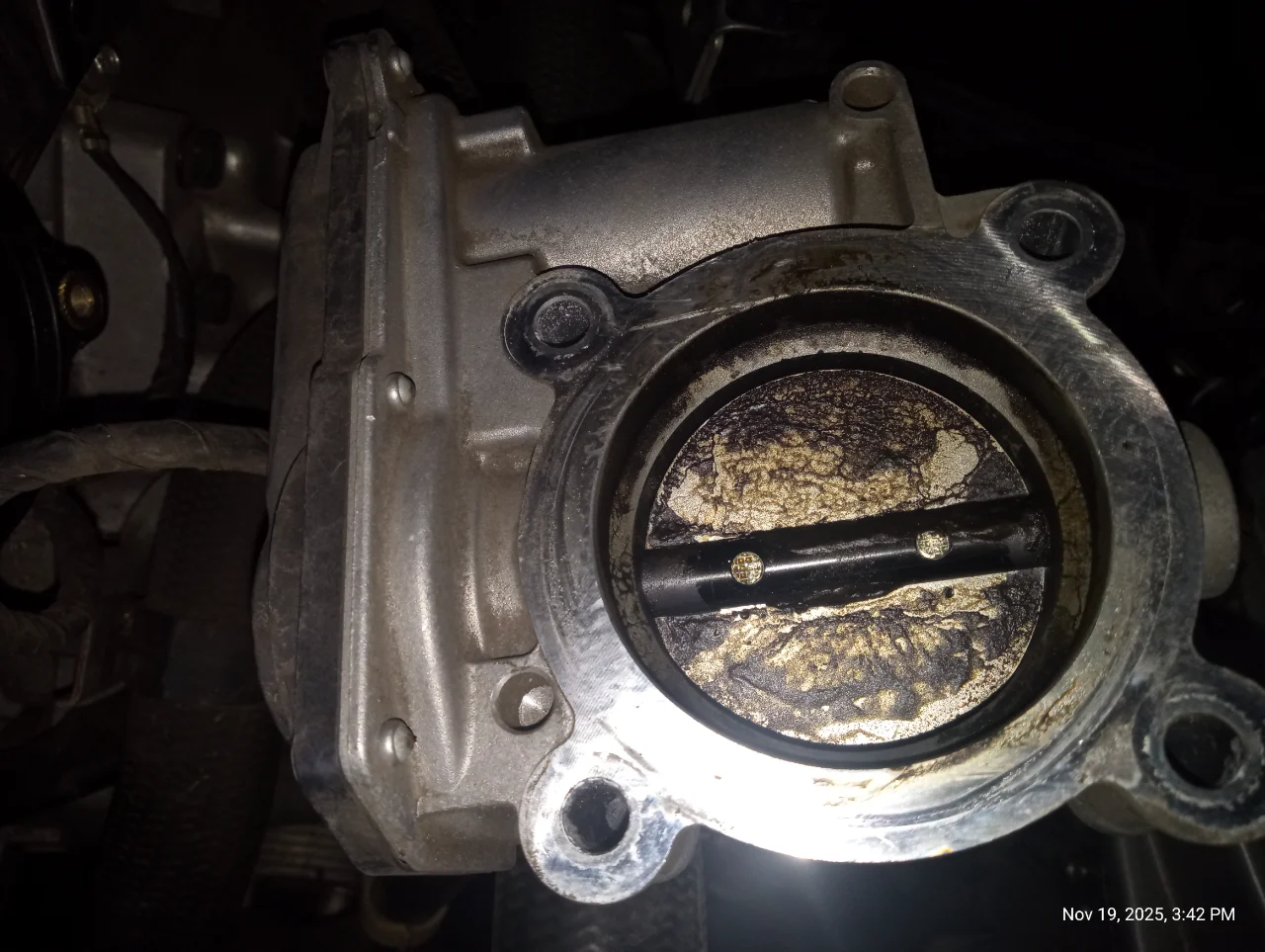

MAF sensor cleaning: easy
Throttle body cleaning: not so easy
First ever cleaning at almost 168K miles
I wasn't able to disconnect the TB wires and had to do the cleaning above the rad hose. The corners where the ends of each half moon meet the rod are most difficult to clean. I couldn't find my box of cotton swabs, and they probably would have been too soft. Plastic razor blade did the job. Also wiped down the tunnel to the engine (only as far as my tiny hand could reach from the opening). The surface was sooty/oily.
The OEM gasket is $13 on Amazon. The old one looks just fine but I like to collect rubber gaskets. This one fits loosely as a bracelet, might be too tight as an anklet. The oil filter housing gasket on my R56 is the right size as an anklet.

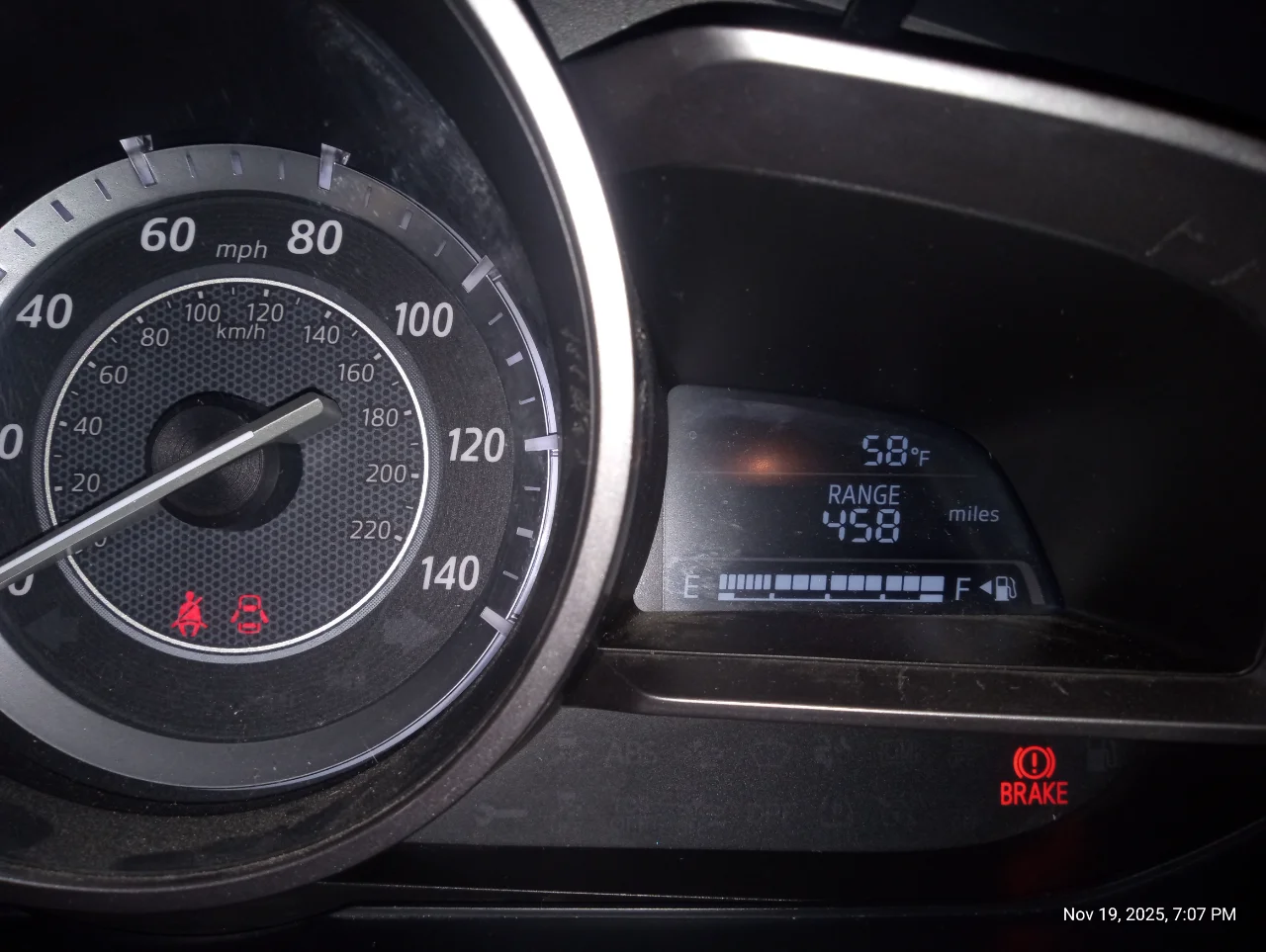

Before the battery disconnect, my full tank estimate was 370 miles. Let's see how long it takes for the ECU to learn that 458 is a fairy tale.

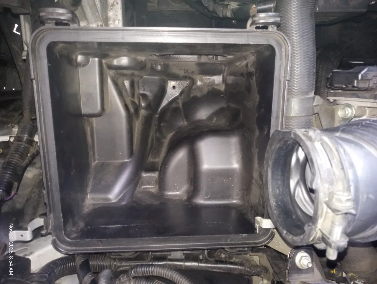

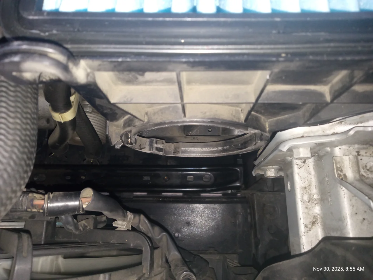

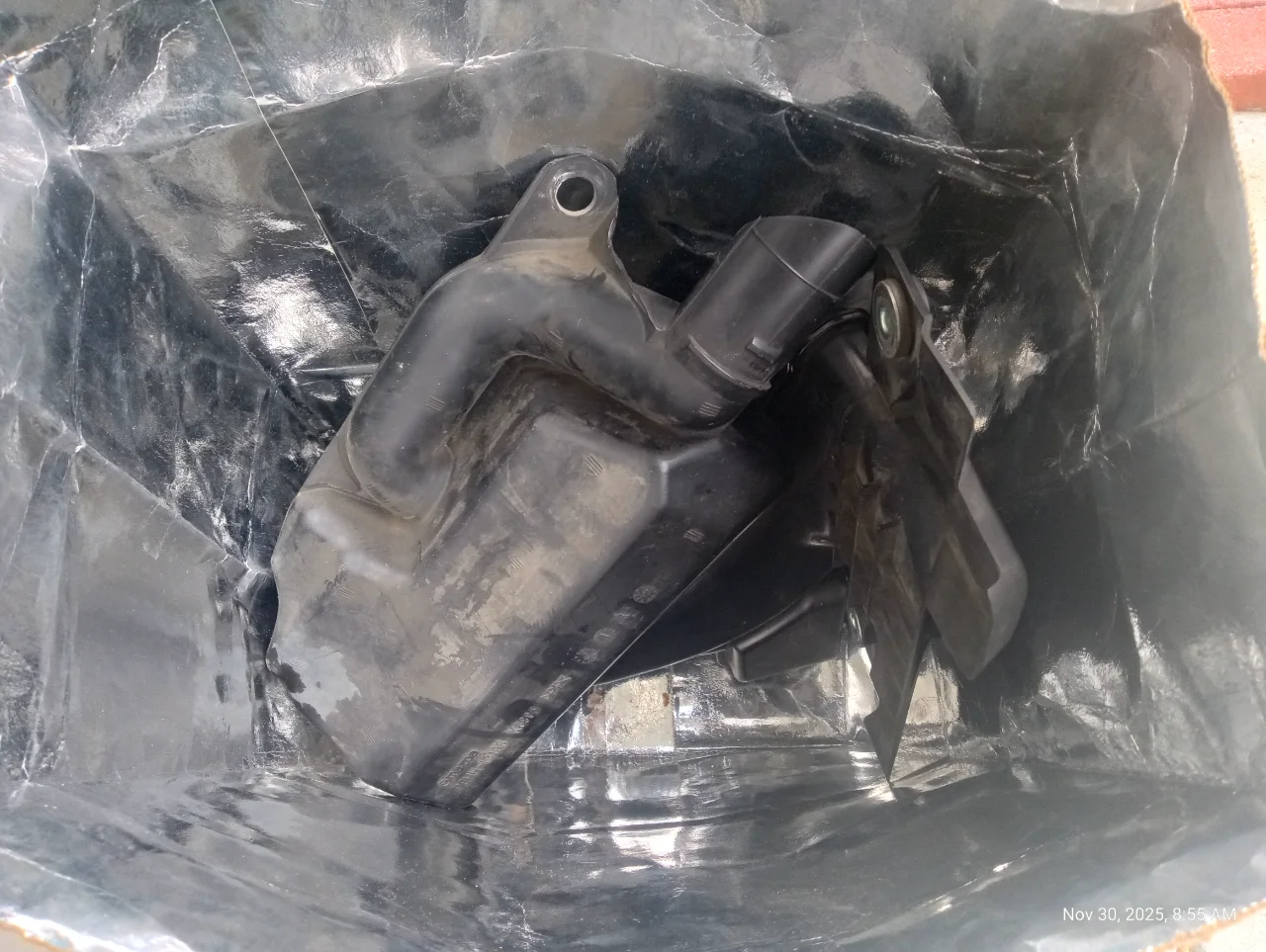

Today I removed the inlet parts of the intake. Will see what difference it makes beyond sound/noise.
The rubber tube from TB to MAF has become harder to remove. It used to be easy, now I have to pry and push with two hands. Don't want to use a flathead yet.
There are a couple of reasons why I am doing this now. My two other street cars (manual and loud) are currently not available. The R56 doesn't start and the RX-7 is stuck behind it. I used to be able to take either out to satisfy my needs. Since August, I have urges left unfulfilled.
I recently discovered that the radiator for the CX-3 is used sparingly on an as-needed basis. The temperature there is usually 10 to 20 degrees higher than intake temp. When there's a need to lower engine coolant temp, it goes up but starts coming back down as soon as the episode is over. Looking at the location of the airbox, I don't think it gets much hot air. Will monitor intake temp this week.
All the parts that came off are in a paper bag. Two bolts for the inlet opening and two trim fasteners for the silencer. Will need them when Smog is due 2/2027.
Edit: The driving sensation is different. I read that someone felt a loss of low-end torque. I think that's it. Previously with only the resonator off and hole taped up, there was no impact other than slight noise increase. With the inlet snorkel also off, there's a lot more noise and noticeably less low end torque. Why though?
There is a chance that I am shifting earlier now due to the louder sound. I need to adapt to the new noise. Let's give this a week. Hot air should produce some increase in mpg.

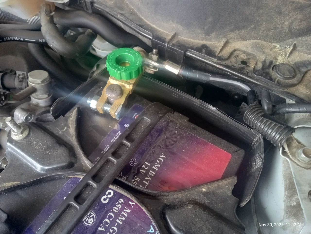

Also added the quick-disconnect for the negative terminal. It is basically two pieces connected together by the green knob. There's a plastic barrier between the two pieces. When the knob is off, ground is disconnected. They are tight as of now, but I will need to recheck. When the knob is off, the cable piece also falls off. It isn't supposed to be like that. This was not a problem when I installed it on the R56.
Edit: I took it out. Both ends were tight but I just didn't feel good about it. Every bump on the road made me wonder if the vibration was going to knock it loose.

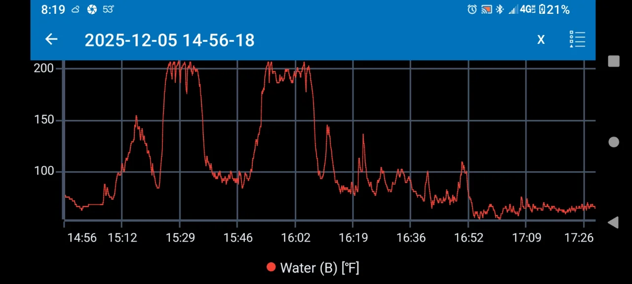

Went to AutoZone before work this morning and picked up two jugs of pre-diluted Peak OET Asian Green. The drain-fill that I did in July was incomplete, only one round, less than one gallon, and a generic formula.
Half an hour was enough time for the fluid to cool down. No need to lift the front if you can lay flat by the bumper. 10mm socket to loosen the bolt on the door. A turn knob to open the valve. A low profile drain pan can go directly under the valve and accommodate your hand when you open the valve. After draining, I poured in about 2/3 of a gallon. The capacity is 5.8L, so two more rounds to go.
Update: I poured the old fluid out and measured about 2.4L. That is less than half of the system capacity.
For the CX-3, there doesn't seem to be much need for burping the system. Draining from the bottom of the radiator only empties the radiator and nowhere else. Very few bubbles came up when I l squeezed the lower and upper hoses. Fluid in the engine does not seem to be accessible to the radiator when the engine is off. My observation is that they don't mix until engine coolant temp is high and car is moving at low speed. During my long drive on Friday, the radiator temp went over 200F during traffic, and that was when the fluid got mixed together. I have been checking the level at the rad cap and it barely went down.

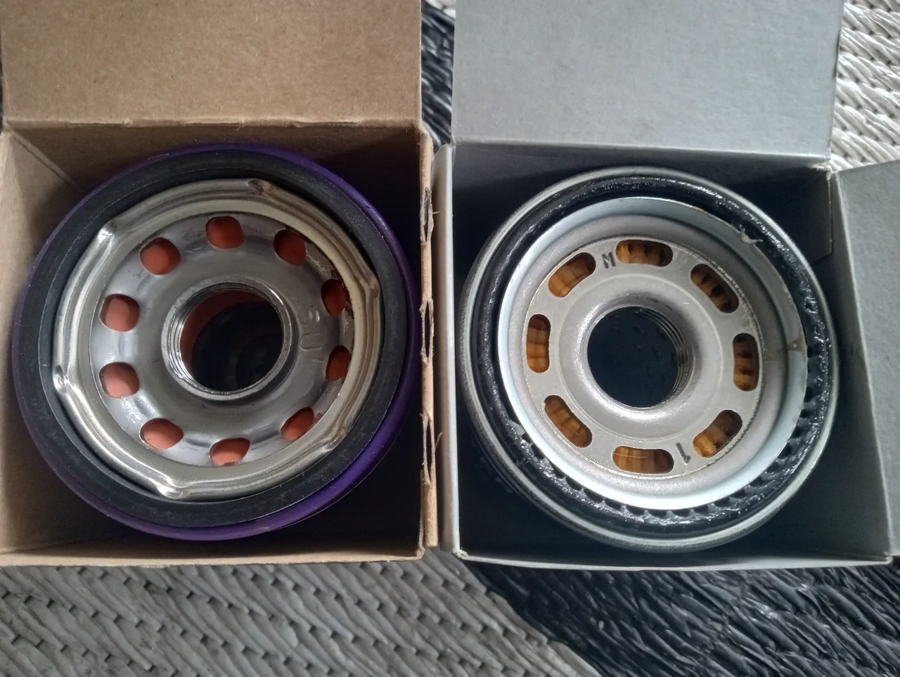

5K miles oil/filter change today (from 165,550 to 170,526 miles) Using VRP for the first time. The oem filter was still tight and came off by hand. It is going to Pete once fully drained.
Start to finish took about one hour. Got some yard work done while waiting. I used to wait for the drip to stop, now I don't. With shorter OCI, the small amount of dirty oil left over doesn't bother me.
Collected a sample for the lab.
There wasn't any noticeable difference from using Idemitsu 5w30. It wasn't quieter than RP 0w20. No additives.
I imagined it would be a bigger burden to go from 7.5K OCI to 6K or 5K. It is not. It takes the same amount of time to do the job. I was actually excited about getting fresh oil/filter in.
On Monday I drained the first round of VRP after about 5K miles. Took the OEM filter out but couldn't cut it open with the specialty tool. Did the blade go dull after cutting open only 3 filters? Or is the can particularly strong? Will try one more time tomorrow before using the circular saw. 🤦
EDIT: I checked between the pleats and saw nothing alarming.

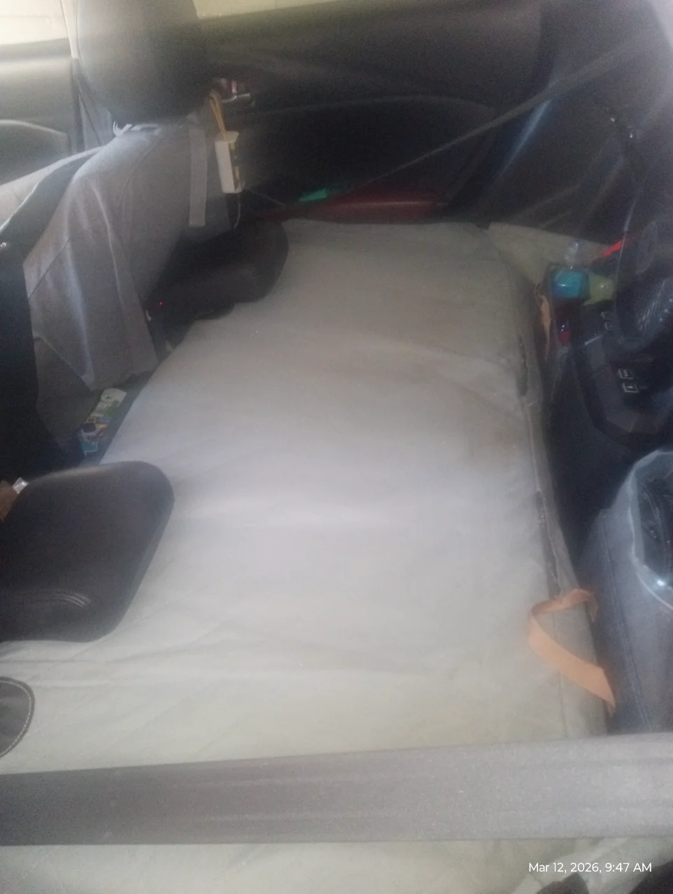

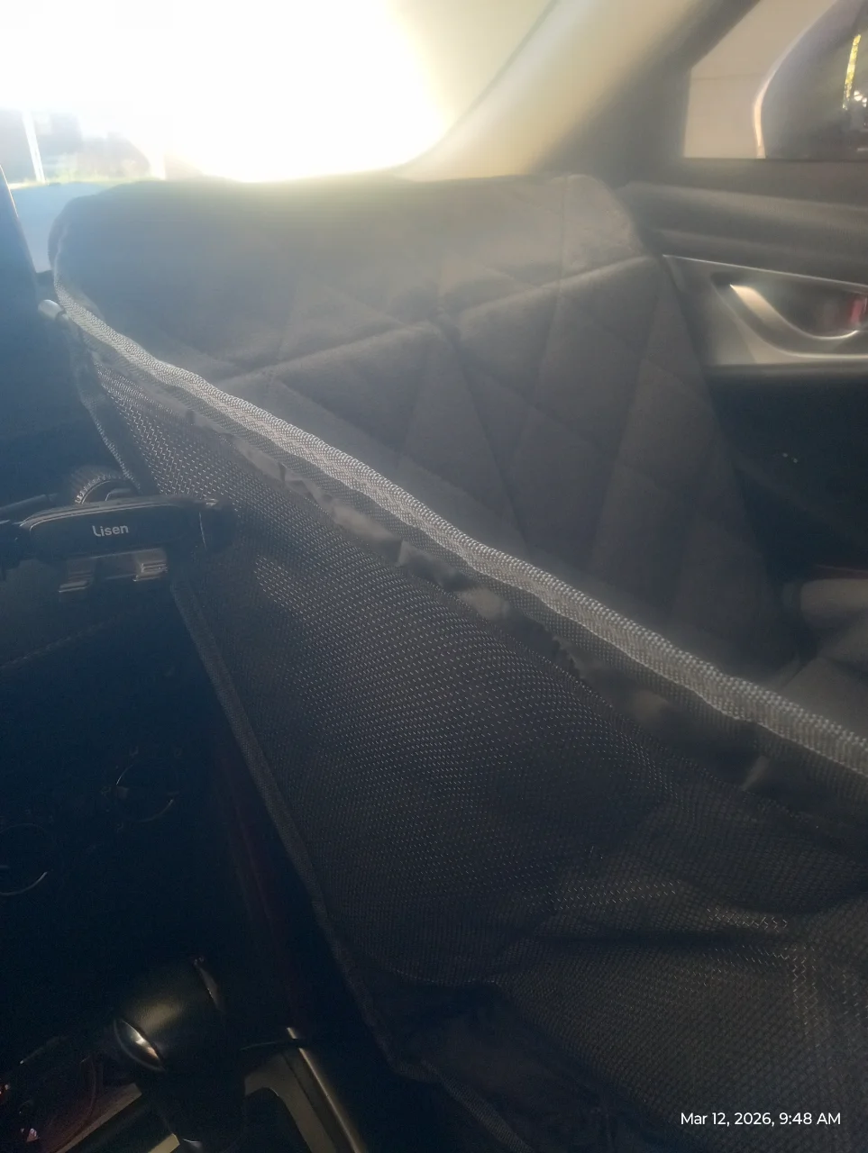

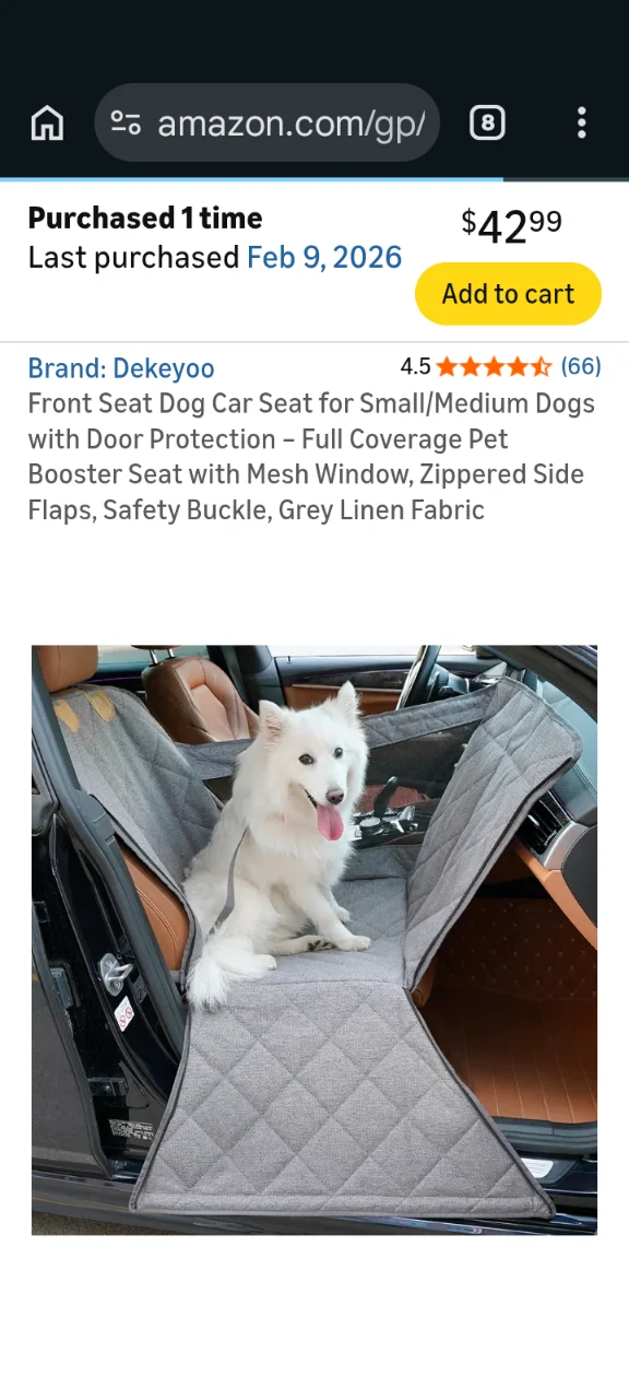

Yesterday I set up a new carrier in the front passenger seat to contain my dogs. They used to ride in the backseats but I need to haul large items this weekend. All my gears/supplies/tools are organized in the trunk.

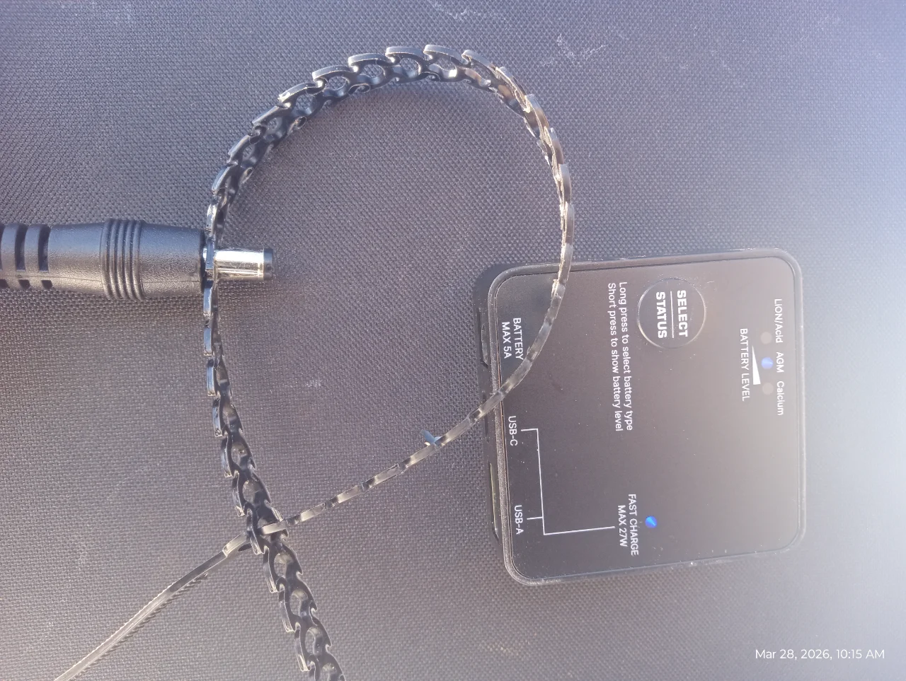

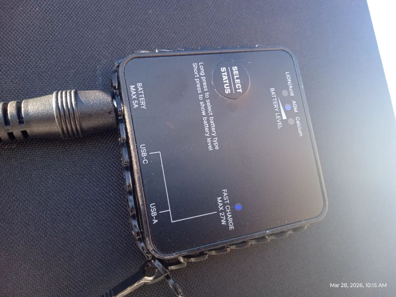

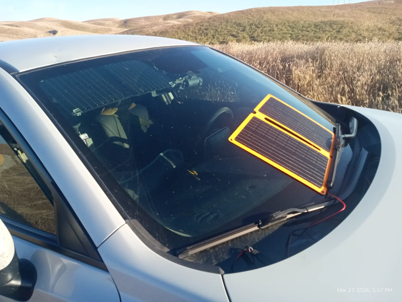

I noticed last week that my battery gets kinda low when the car is off. The OBD2 reading in the app was 12, but when I changed the setting to show one decimal point, it turned out to be 11.5. 🤦
The plan is to change the alternator and all the relevant/impacted parts. Until I am ready for the task, this will give a bit of boost when the car is parked in the sun at work. The panel sits behind the windshield. The wire is routed into the cabin from a rubber flap in the rain gutter through a gap by the door.
At home the car is parked in the shade, so this device draws from the battery to power the panel's junction box. I saw the reading go from 11.4 to 11.3 before I unplugged it.
Running a slow maintainer now.
The slow maintainer only got the level up to 12.1. A stronger maintainer is pushing it to 12.4 now. It is getting power from my home brew solar setup (2*100w panels in parallel, 10a charge controller, 100ah battery, 400w inverter.)
EDIT: Brought this to camp and it helped a tiny bit. The battery was low at 11.6 and the panel kept it up to 12 under full sun until about 5 pm. It's coming back down. Yes I have a battery problem.

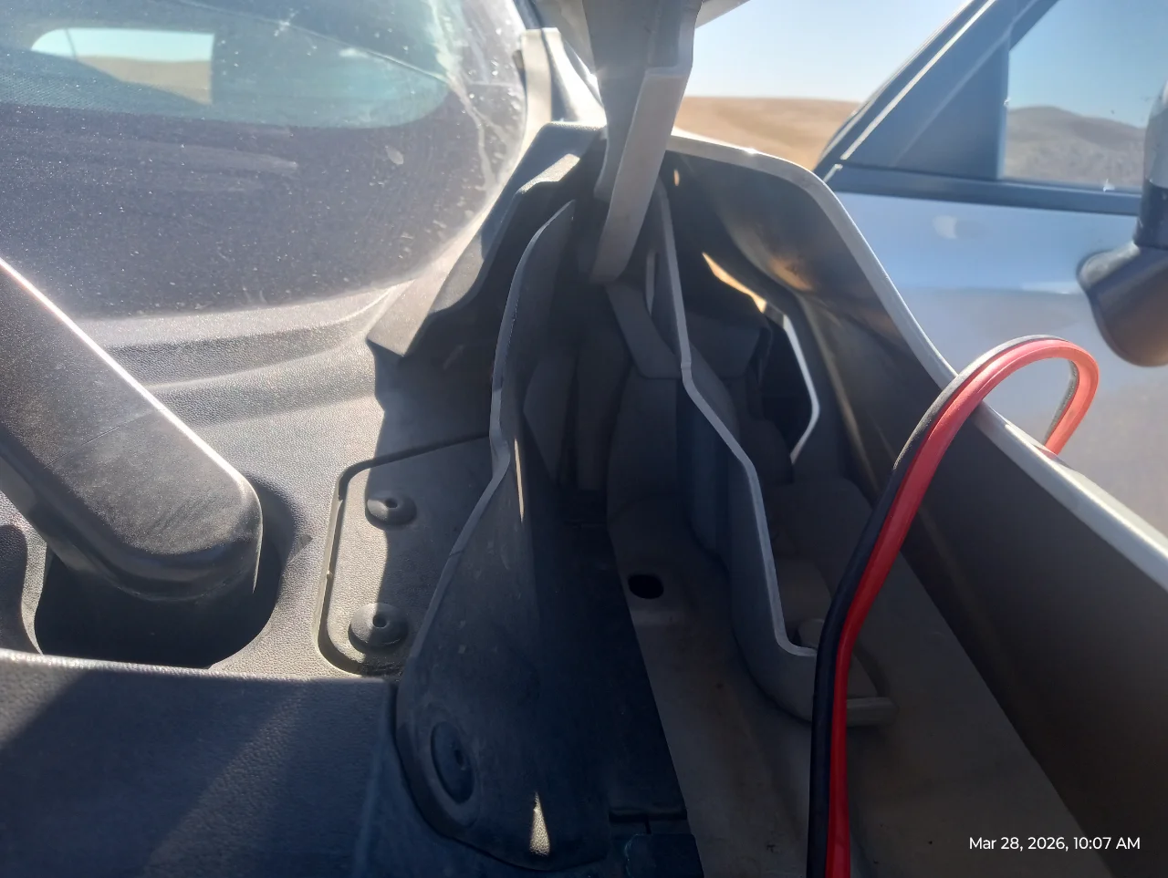

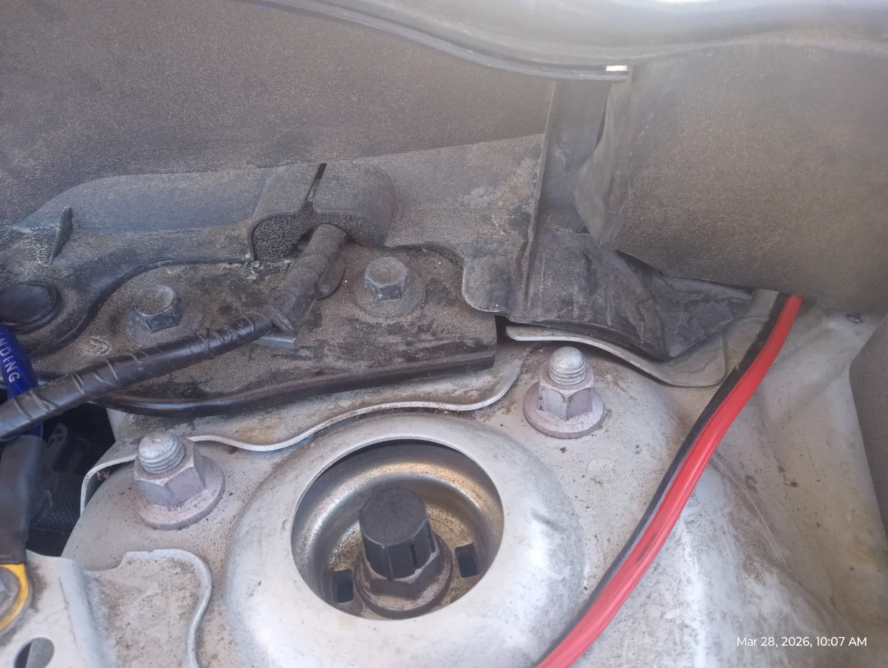

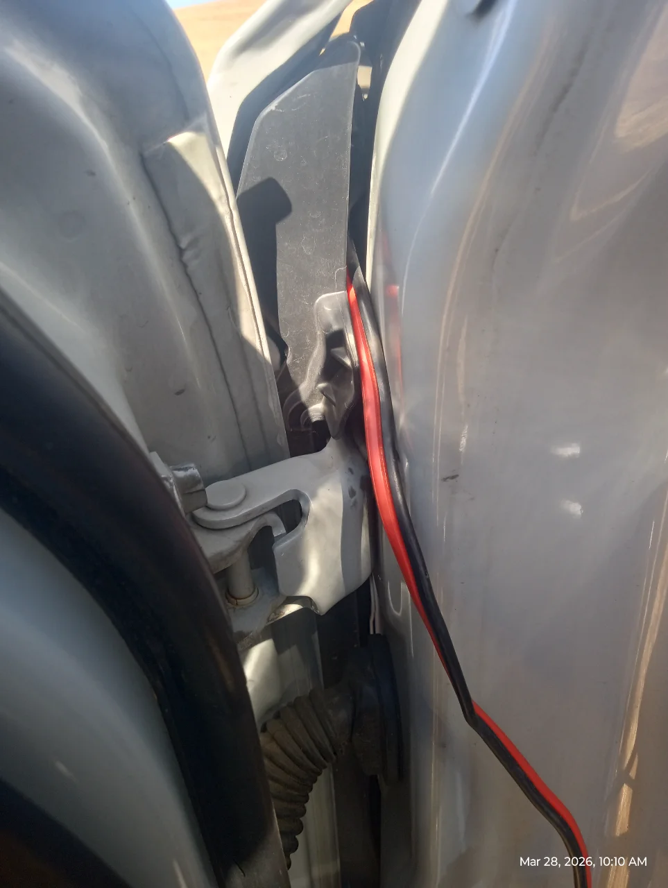

Today I re-routed the SAE ring connector-wire to the passenger side. When I back into my covered car poet, the solar inverter & maintainer are on the passenger side. This way I can connect to the maintainer while at home and switch to dash-solar when I head out. The maintainer got the level up to 13.3 and now let it settle at 12.6.
