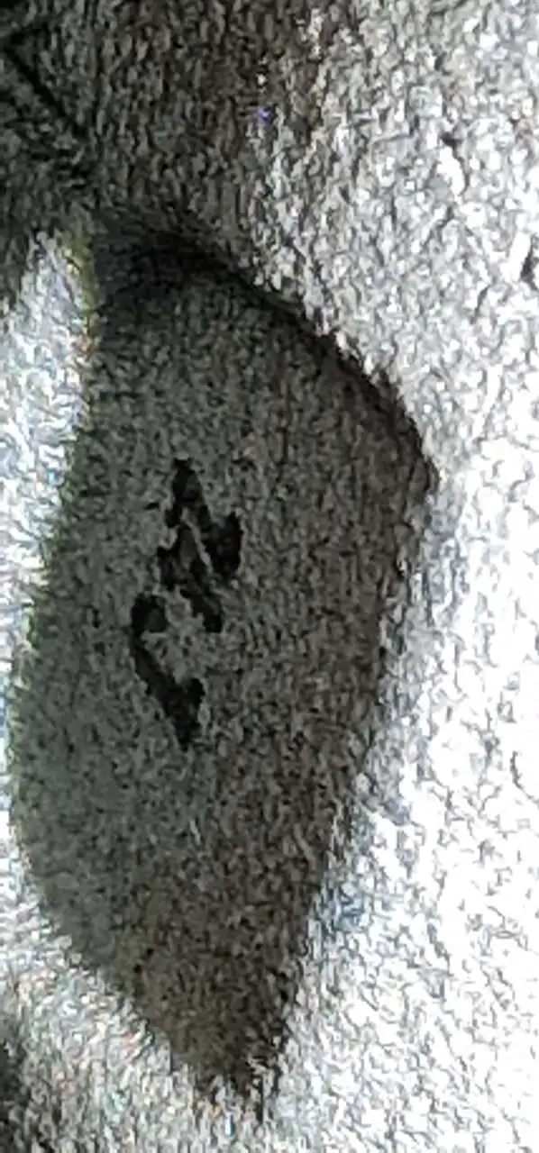

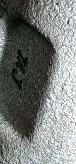

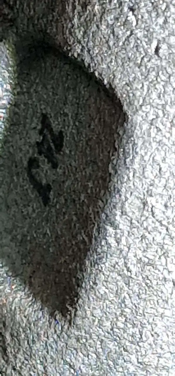

Hi all, 1st post here so hopefully I have this in the correct section.
I was after some help if anyone can it would be very much appreciated.
So unfortunately I have the known defective cx5 electronic parking brake calipers and the right rear malfunctioned.
I replaced this caliper as per the Mazda technical bulletin for a brand new one from www.getoemparts.com however upon fitting I did not check the date stamp on the caliper.
The caliper performed just as it should for 5 months however the fault has now returned giving all the same faults as the original caliper.
This then promped me to reinspect this caliper and the 1st thing that come to mind is that I didn't check the date stamp to check weather or not this was the updated caliper.
So now we get to my issue. The caliper is date stamped what appears to be 24J which makes no sense as the Mazda technical bulletin only shows this stamped as 3 numbers.
I will include some pictures of this to show you what I mean, sorry the pictures are not the best but Its difficult to get a good picture with the low light.
I really hope Someone can help identify this date stamp so I then know what direction to go about fixing this.
Many thanks
John

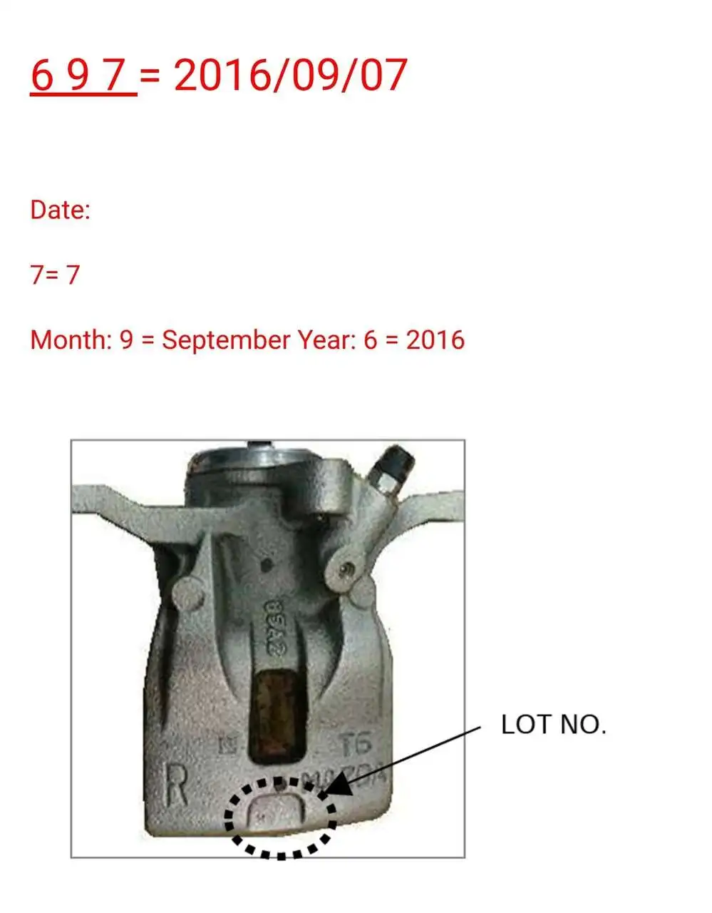

My guess would be your date code of 24J would be 2022/04/20 date of manufacture. (Last digit is day of month and since there are [up to] 31 days in a month and only one position to indicate that they use 1-0 then switch to letters for 10-31... A=11, B=12 and so on).
Unless it was 2012/04/20 ? Didn't start making CX5 in the US until 2013 model year though IIRC.

I agree with what HyFlyer has said on the date code part. Besides, it’s 2022 when you got the caliper, and it’s hard for a Mazda dealer to keep a caliper manufactured before Sept. 2016.
If you believe your 2016 CX-5 with a new right rear caliper now is having the dragging issue again after 5 months of replacement, the culprit should still be the defective caliper. Not sure if you can ask the seller which is supposed to be a Mazda dealer giving you the parts replacement warranty which normally is 6 months to 12 months. It doesn’t hurt to contact them and ask.
BTW, what kind of dragging symptoms listed in the TSB do you awarer? Is it possible you also need a revised rear caliper to the left side?
I got lucky that my Mazda dealer was willing to replace the rear calipers、pads、and rotors on BOTH sides of my 2016 CX-5 right before the new car warranty expired when I presented the TSB. That would be what I do, replace both potentially defective rear calipers.

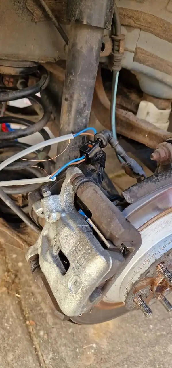

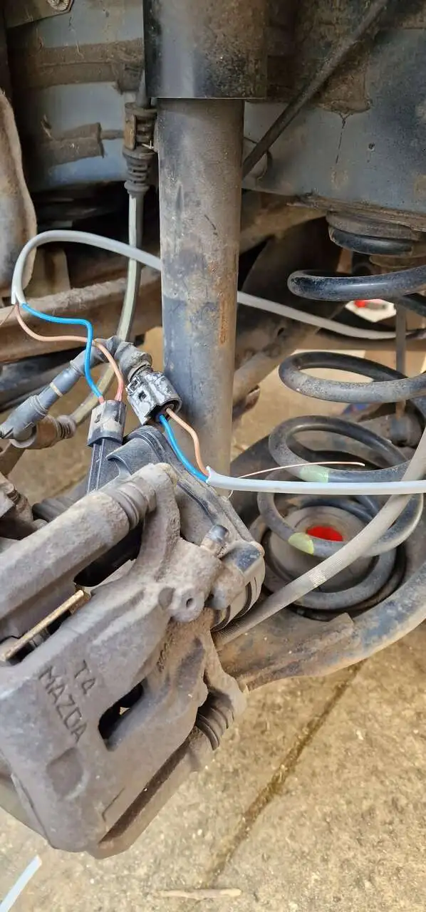

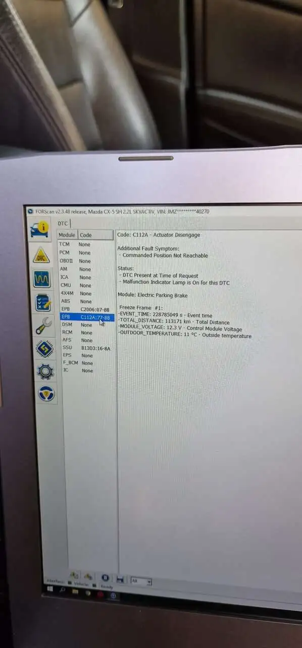

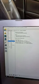

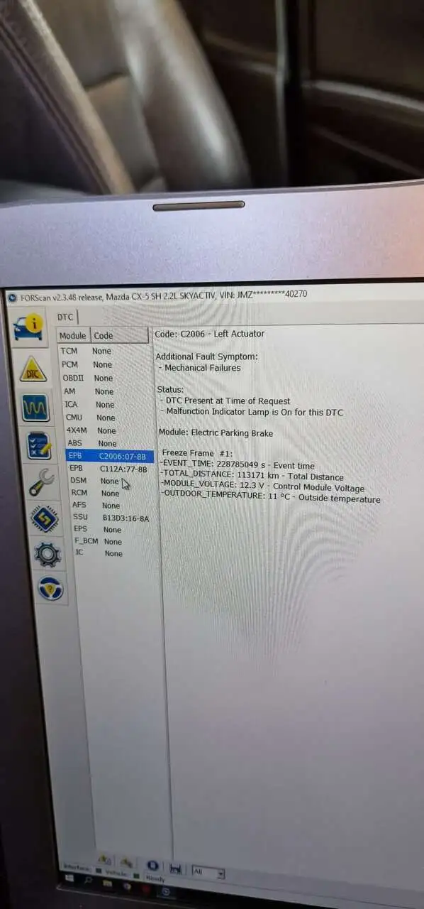

Hi all, so an update on the issue. (I found some time to have another look)
So after spending a lot of time operating the 8mm drive shaft on the back of the caliper. (Motor drive shaft)
I was convinced that neither caliper had any sign of mechanical fault so that then got me thinking that as the fault is always showing only on the right side if I could rig up a way of connecting the right side electrics to the left side and vice versa I could then see if the fault moved to the other side.
If it did then the culprit would be the module.
So I managed to rig it up and test it and hey ho the fault moved to the left side, meaning that it can only then be the module at fault as I'd tested all the cables for signs of damage already.
I will include some photos of my very bodged up testing but it worked for what it wanted it to do.
Now the question, does anyone know if a new epb module needs coding to the car?

... So I managed to rig it up and test it ...
Good work on diagnostics 👍
I see you're using FORscan (full version). How do you like it? I have the android based "lite" version and also bought the cable for the laptop in case I ever want to download the full version.
Thanks for the update. Glad you found a way to verify the culprit should be the EPB module. Do you plan to get a used EPB module or a new one? The very first TSB for this brake dragging problem was to replace the EPB module with a revised one, I seem to remember something needs to be programmed to accept the new EPB module. You can ask such question at a Mazda dealer, especially if you plan to get a new EPB module there. Let us know how the thing is going from here.

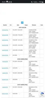

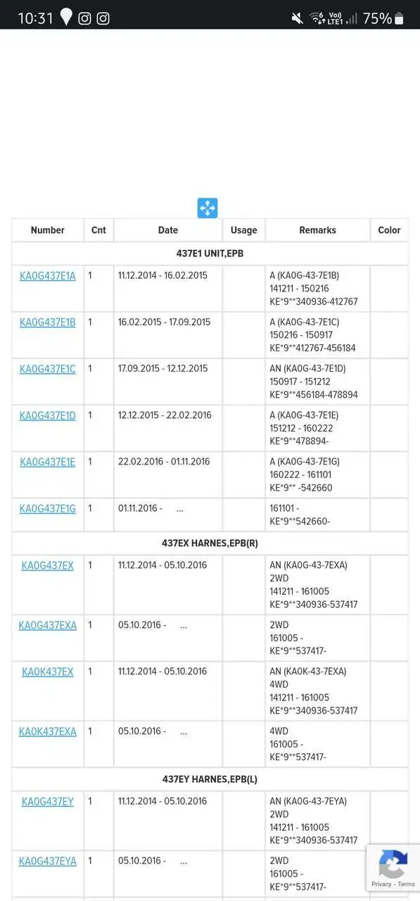

Hi all so I just wanted to follow up on this post incase it can provide some help to anyone else with the same problem.
So after many many hours and lots of trial and error I've finally found the problem with the calipers and it was indeed as suspect the module.
I dont exactly know what happens to it but it becomes intermittent and never fully fails.
Looking into this it appears that Mazda does know about this and like to keep it as secret as possible.
However I did find this parts info online about the modules and it appears they are now on Thier 6th revision of this module and I can only guess that is because they have had issues with all the ones previous.
I order the latest version G and now it is working perfectly again. (Finally)
Mazda UK wanted to charge an obscene amount of money for a new module (£500) so with a bit of searching around online I managed to find a Mazda dealer in Dubai selling this exact part but at a much more reasonable price. £195 including postage and all import fees.
It even arrived quicker then Mazda UK quoted as was at my door within 3 days!
Extremely easy to fit, just required the center console part dissembley (guides for this online) then it's just plug and play, no coding required. Just connect it all up with the battery disconnected. Ignition on, wait 30 seconds, ignition off, ignition on then cycle the parking brake button.
Hopefully this helps someone in the future and if you have any questions feel free to ask I'll be happy to help if I can.
Really appreciate your update! Is the ignition on / off cycle through the steps to reset EPB control module? I remember someone had mentioned that his new EPB control module needed to be re-programmed after the installation, could be just the dealer didn’t tell him the truth.
