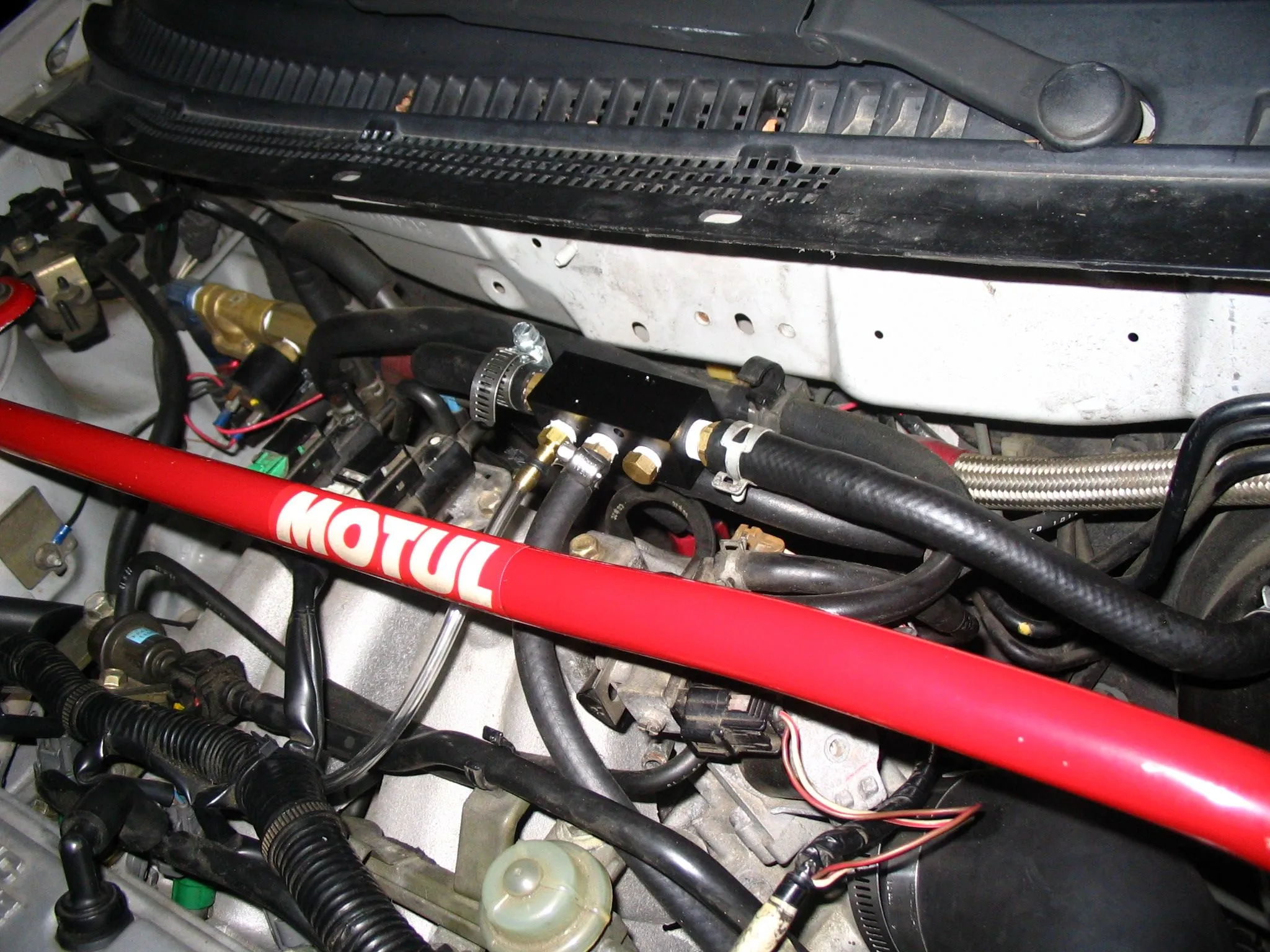

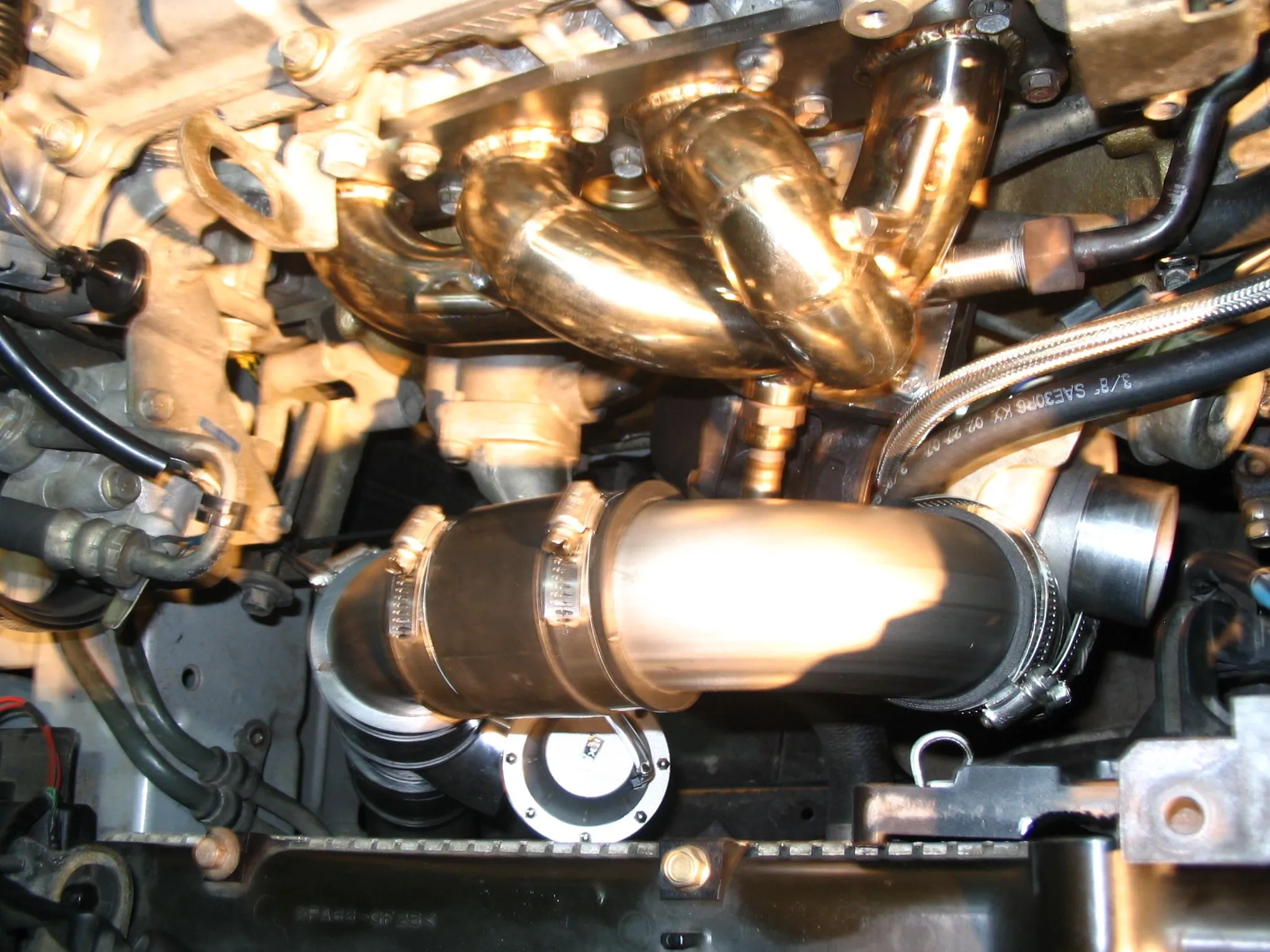

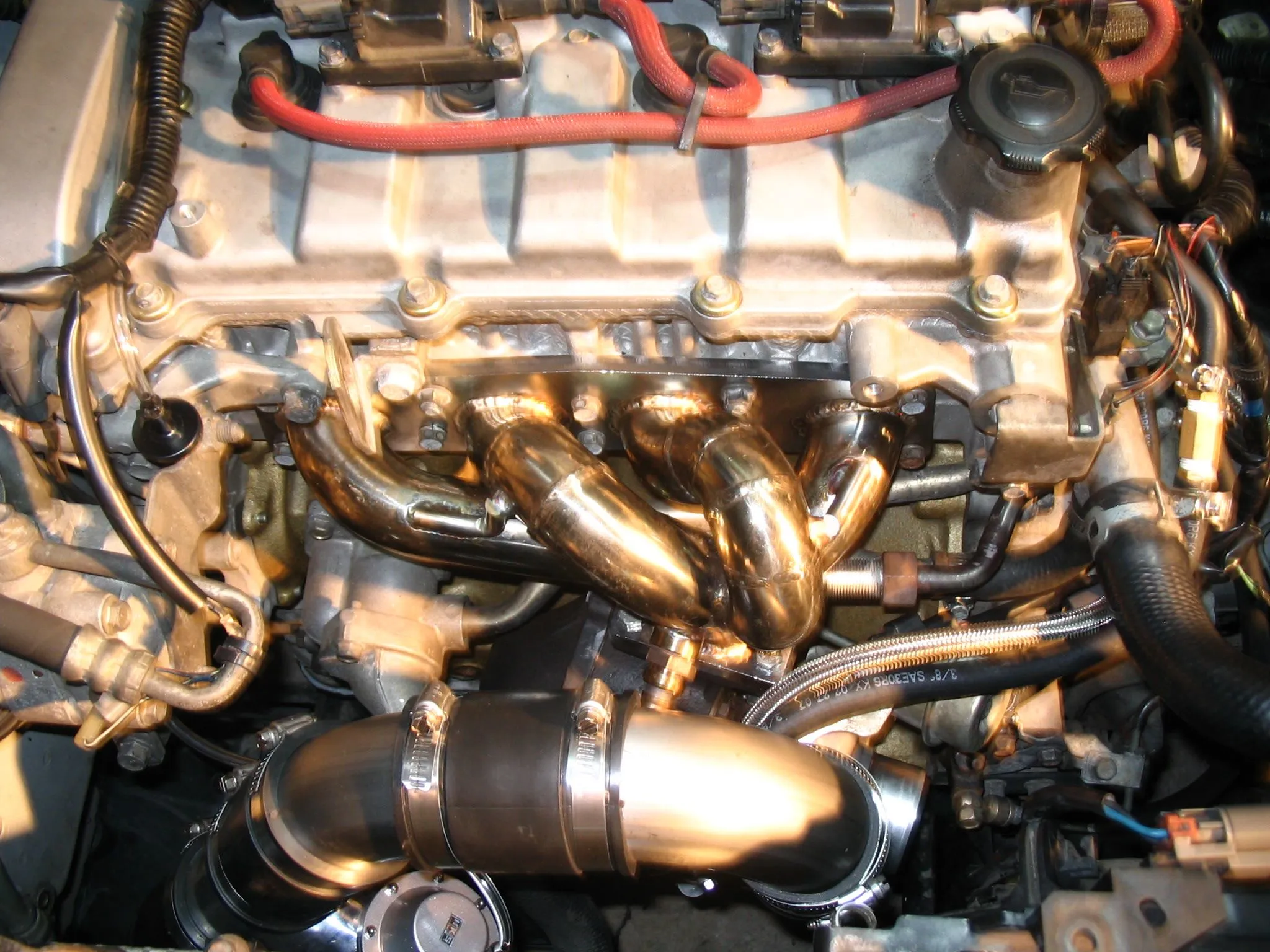

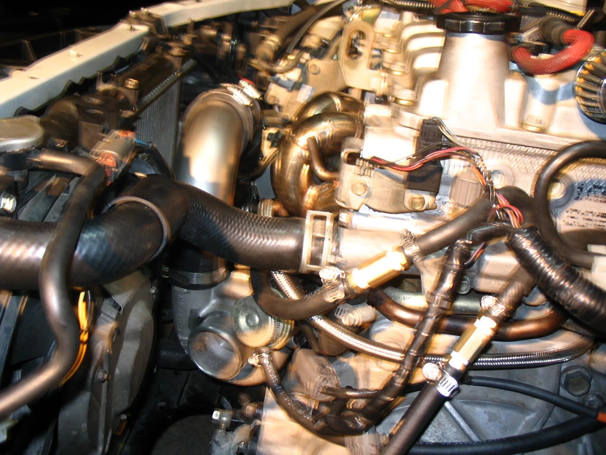

Sorry for the night time pictures. I'm waiting on 2 more boxes to come in and I should be able to take her for a little test drive. Here is the pictures of most of the work so far. Hot side piping all routed, BOV mounted, and vacuum block rigged up and ready to cause leaks I'll be chasing down later. I noticed I had a nice little oil drip out of the return bung in the oil pan. It's nothing that needs immediate attention, but I will be redoing the bung when I get to the first oil change.

Justin, make sure you use lock washers on the bolts holding the turbo to the manifold. It will get loose slowly if you dont over time, and either crack the mani due to vibration, or break the bolts. Also do yourself a favor if you havent, and use a gasket between them both as well. It will save you hasstles man.
Here is a guy that sells the gaskets we used.
http://cgi.ebay.com/ebaymotors/T25-...020QQitemZ300134854206QQrdZ1QQsspagenameZWDVW
Looking awsome by the way. Great job!
I've got a gasket in there and I'll see about getting some washers for the bolts. I used the OEM nuts there which are the oval style exhaust nuts. I figured they would hold good enough since the factory didn't use washers there. I'll go back and fix that.
Hey,
I highly suggest that you use silicone couplers by the turbo instead of the ones you have now. Better yet, weld the pipes together if you can afford it. I had the same ones when I first built my FMIC kit and they always shrink and leak boost as the manifold gets hot. Plus, the more couplers you have in the system the greater the chance for boost leaks there is.
Good luck with everything else and let me know if you have any questions.
I am planning to upgrade the whole piping system once I get everything worked out and operating the way I want. Until these couplers become a problem though I'm not going to worry too much about them. At this point I know exactly how to cut the piping and what lengths I need so I can redo it at my own convenience and while still driving the car while the pipes are being ordered/welded.
