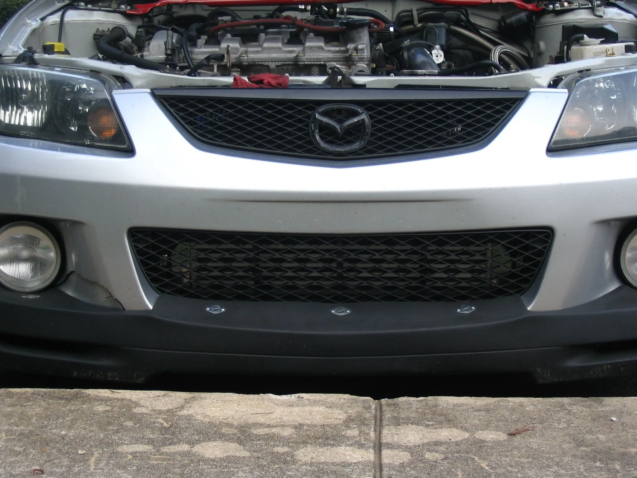

All righty! Had to gap the spark plugs down to .028" and she runs just fine now. Pulls strong up to about 8psi. You can tell the ECU is running way too rich though. There is a big flatspot in the midrange where it just doesn't pull as hard. Good 'ole MSP ECU for you.
I love my car now.

Next major thing I need to get installed within the next week or two is an oil cooler. I'm not sure where I want to mount it though. I'm running out of room behind the bumper and I really don't want anything else in front of the radiator. I'm thinking I might mount one over the hole where the CAIs usually go into the fender well. The I could run some ducting up to it and maybe a small fan on top of it. That would look pretty trick.
Well I measured and there just isn't enough room between the headlight and the fuse box for a cooler that big. My other two options is to go with a smaller motorcycle cooler in the same spot (probably not enough) or to put a larger cooler behind the front upper grill. I'll be measuring and doing some research on that today.

I don't need either right now. I have to wait until I get the Naca Duct installed so I know how much room I have for the cooler. I've got the ATP wastegate which gives me 8lbs which is plenty for now on my stock block.
