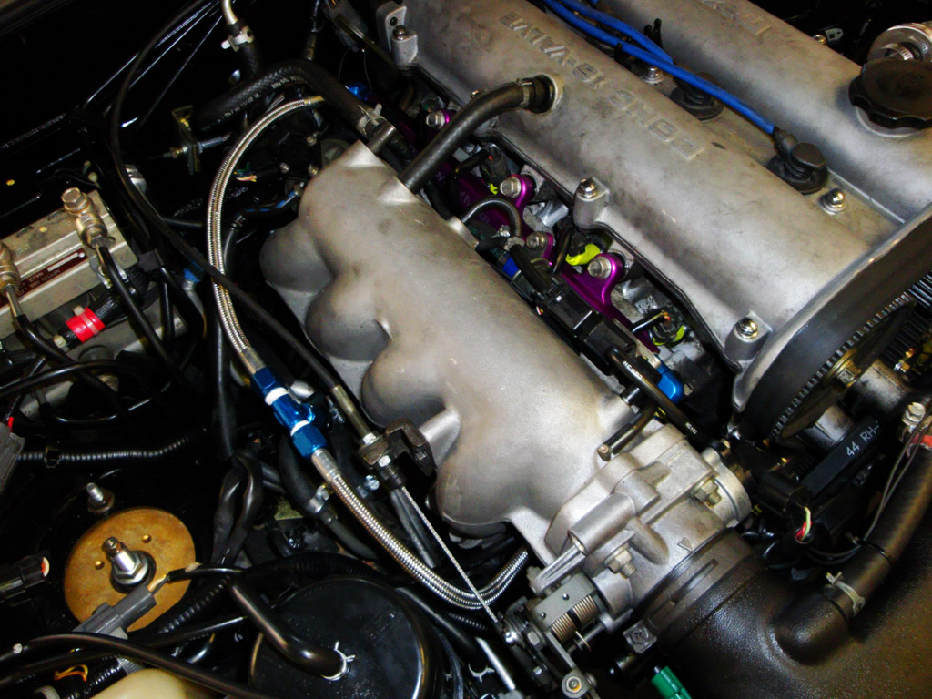

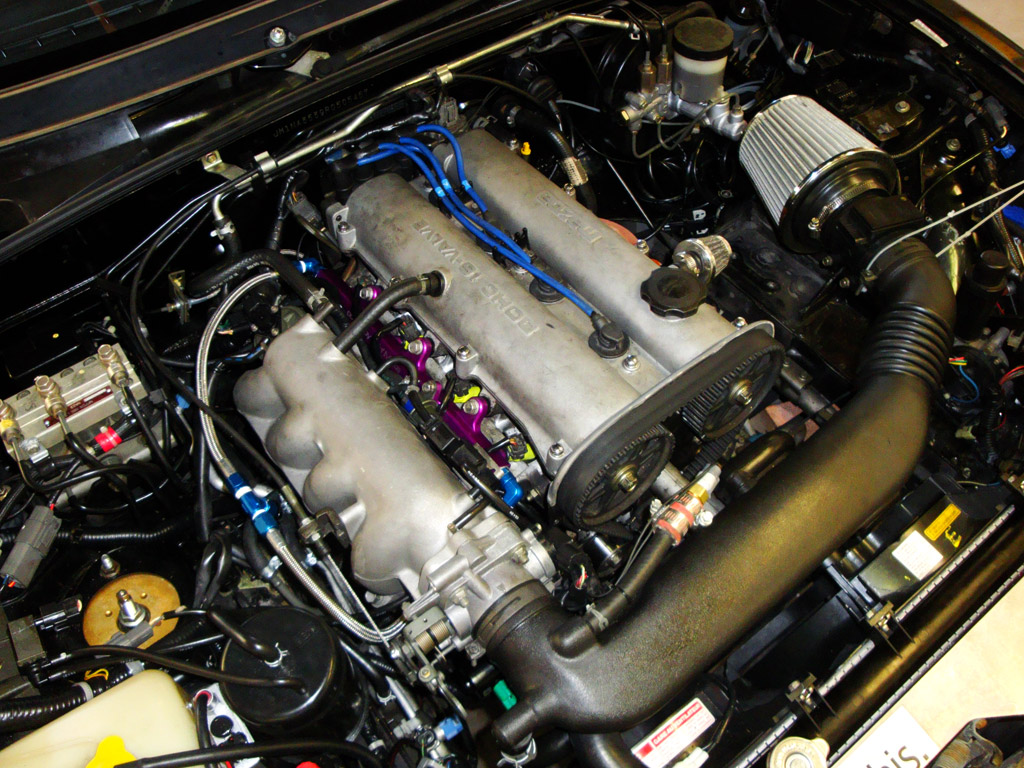

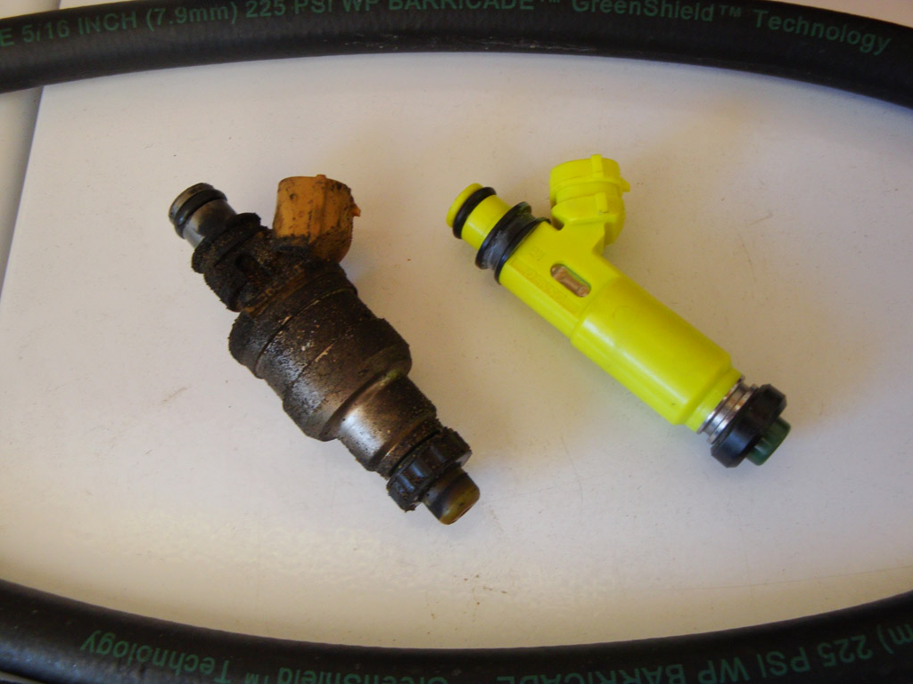

Fuel rail, injectors, test pipe and spark plugs installed today. The last bit of parts that I could install before turbo :)
Old vs. new lol.. after I installed the injectors/rail, I tweaked the mspnp the best I could for the change and my car seems to be running spot on now, so thats sweet. Still have that voltage issue but my idle, accl and throttle response are pretty on point now.

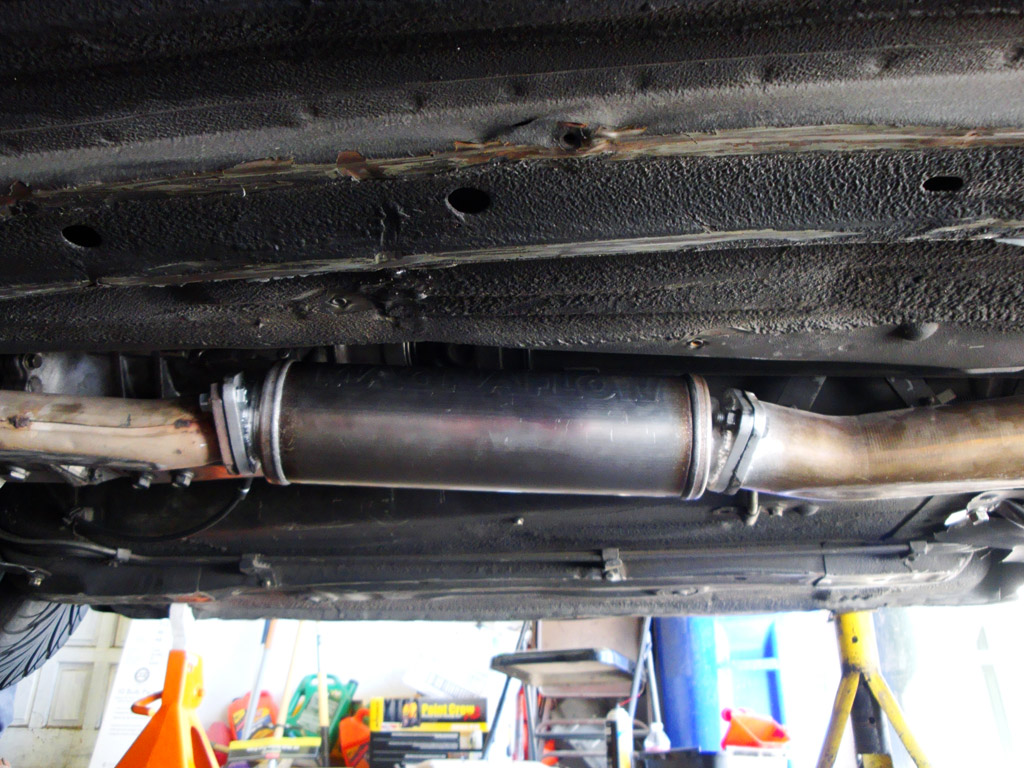

Resonated test pipe by enthuza. The car isn't any louder surprisingly, the only difference I've notice is the raspy at WOT is a lot less noticeable. Now I'm concerned my car may be too quiet after turbo :/ lol

Man... I'm jealous of your intake manifold. I can't get to my fuel rail and injectors with mine.
