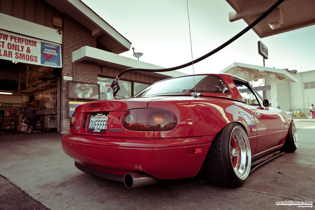

How in the bloody hell do you jack your car up man? Hahaha. I have troubles with mine sometimes.
^ have to roll onto two by fours n s*** and do this whole dance just to get in on all 4 jack stands.
