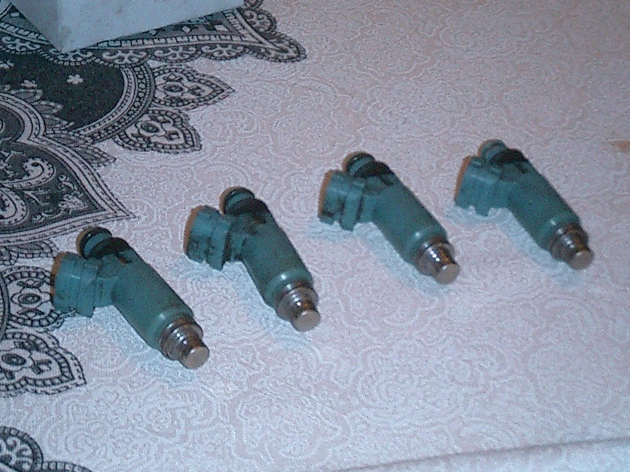

Here is the pic of the 2003 WRX Injectors I just purchased.
Here is my question I have read and PM'ed several members. And half of them said they need to be spaced and the other half said they are direct drop in.
Just looking for some more input.
Thanks.

Everywhere I've read says they are 440cc. I also bought a set and the guy said they were the 440's from his WRX.
The spacing is optional I think. It just depends what placement you're comfortable with. No one has had complaints either way IIRC. Search for YP5 Toronto's thread on them.
