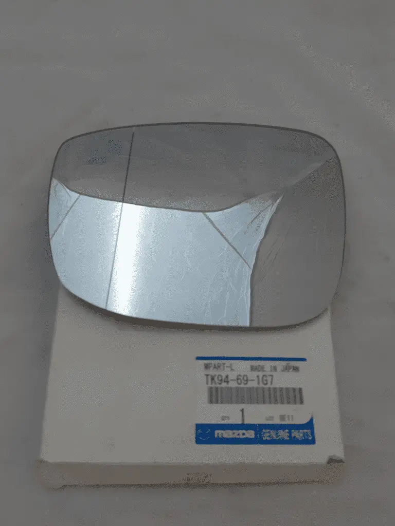

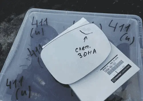

RUDM TC CX-9 / EDM CX-5 part numbers:
Left (aspheric):
TK94-69-1G7 (heated w/BSM)
TK93-69-1G7 (heated w/o BSM)
Right (regular convex, no warning label):
TK94-69-1G1 (heated w/BSM)
TK93-69-1G1 (heated w/o BSM)
General Market LHD CX-5 part numbers:
Left (regular convex, no warning label):
TK58-69-1G7 (unheated w/BSM)
TK56-69-1G7 (unheated w/o BSM)
TL13-69-1G1 (unheated w/BSM)
TL12-69-1G1 (unheated w/o BSM)
I don't think anyone cares for GCC mirrors (arabic "objects in mirror" warning label), so I'm not going to post them.
UKDM CX-5 part numbers:
Left (regular convex):
TK92-69-1G7 (heated w/BSM)
TK57-69-1G7 (heated w/o BSM)
Right (aspheric):
KBG9-69-1G1 (heated w/BSM)
KB9H-69-1G1 (heated w/o BSM)
For aspheric mirrors on both sides, order a RUDM and UKDM mirror, one of each side... otherwise, if you're on a budget, just get one mirror and live with the "objects in mirror" warning label... it's OK... my experience with a UKDM driver's side mirror on my protege had shown that it's so wide, it doesn't let me see effectively more than a regular convex mirror did... I have all 3 versions of those mirrors, except for the GCC convex and AUDM flat one

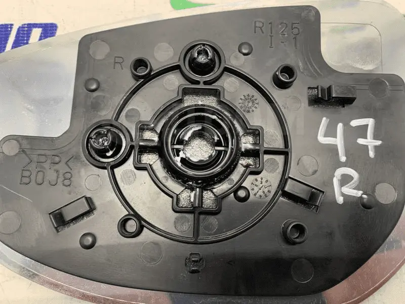

Even if the CX-60 mirrors (assuming they're the same shape) aren't a straight swap, it appears the black backing on the mirrors can be separated trivially:

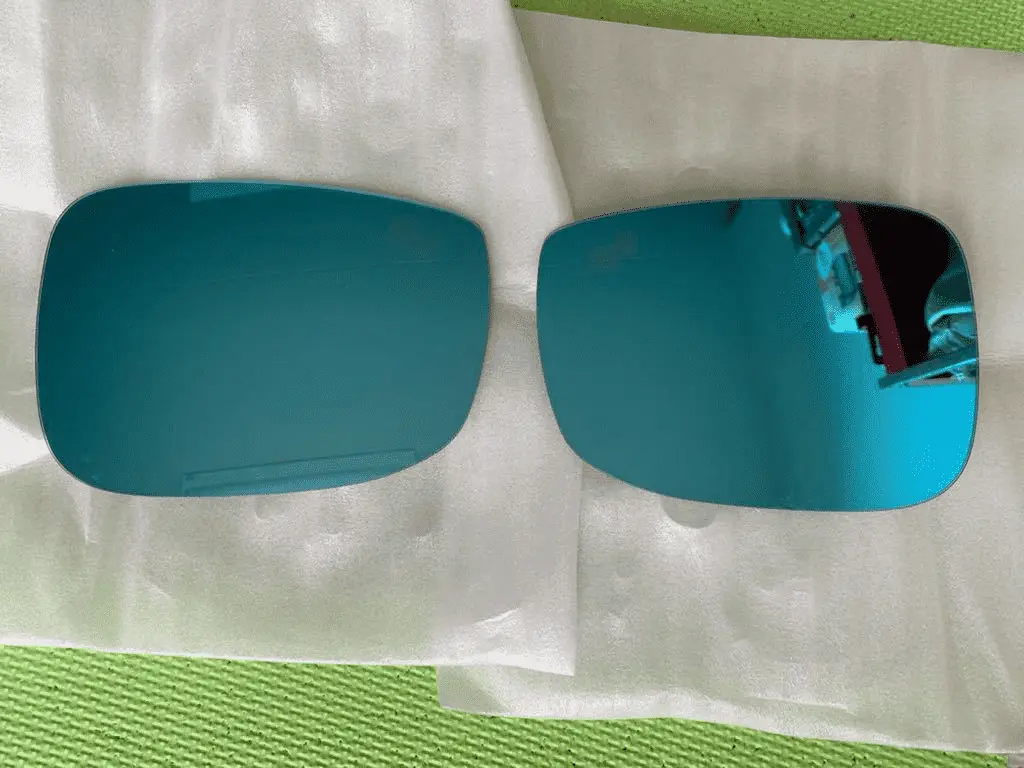

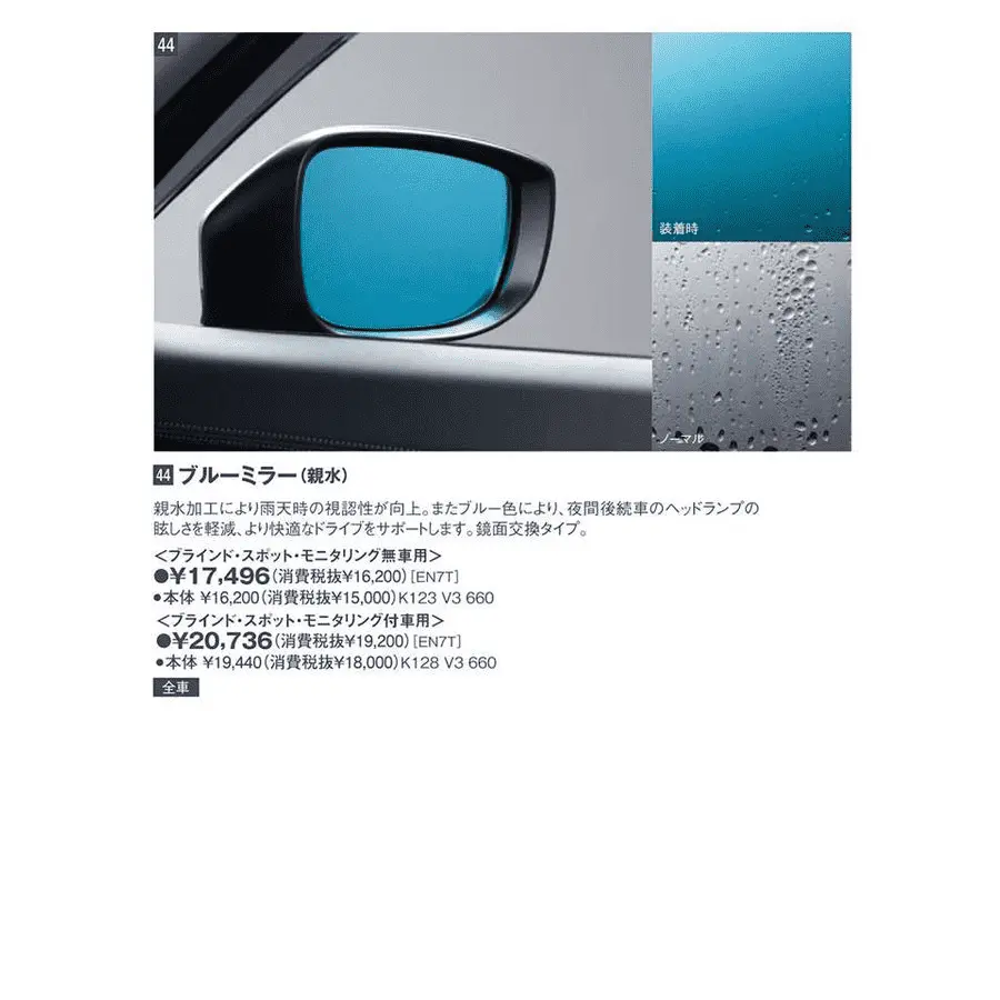

JDM KF CX-5/ CX-8 blue mirrors (OEM accessory kit)
K123-V3-660 (heated, water repelling, w/o BSM)
K128-V3-660 (heated, water repelling, w/BSM)

These ones are not aspheric or convex, right?
both convex only, but probably curved more than USDM or EDM convex glass, as allowed by JIS rules
Japan has not used flat mirrors in passenger cars for probably around 40 years or more

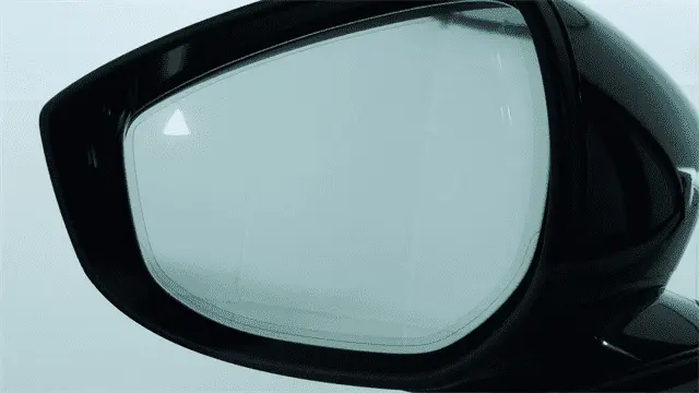

CX-30 and CX-60 mirrors might fit... again, one of you needs to verify parts supplier first, but the glass appears to be the same shape:
CX-50:
CX-30:
CX-60:

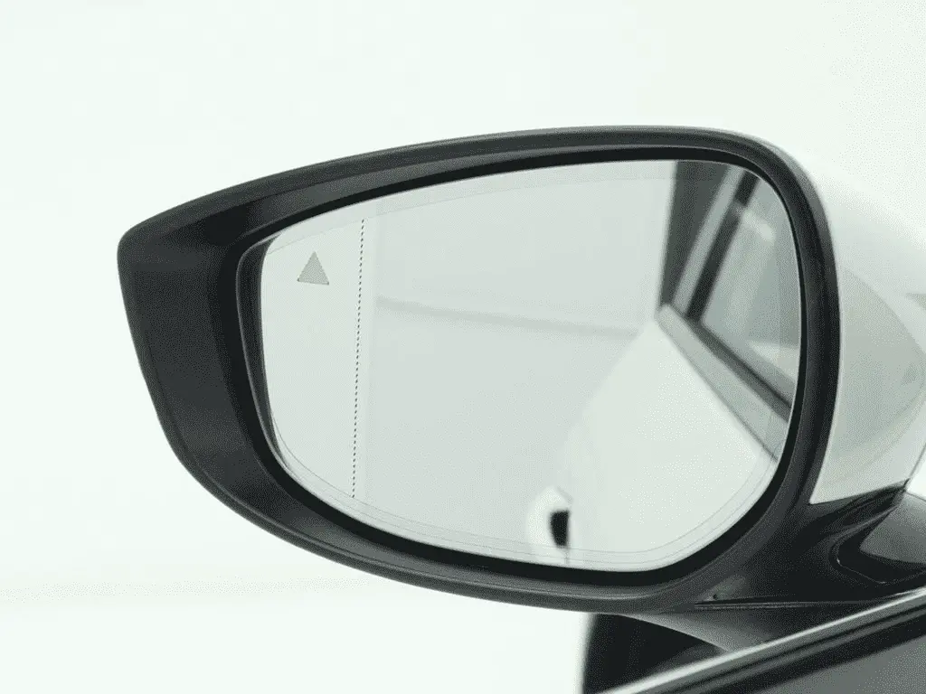

Since it looks like everyone has been busy to go do more research, I went out of my way to stop by the dealer today on the way to do some shopping.
Good news: the CX-30 mirror housings are the same as the CX-50. The supplier is Penstone Mexicana, subsidiary of Ishizaki Holdings Corporation. It has the same ECE type approval numbers, same OES part numbers on the housings.
This means, there is a very likelihood that importing EDM Mexican built CX-30 mirrors will fit!
So, on to the part numbers for the Mexican built LHD EDM CX-30 mirrors:
Left side (aspheric):
DGK9-69-1G7 (w/o BSM, unheated)
DGK9-69-1GY (w/BSM, unheated)
DGL2-69-1G7 (w/o BSM, heated)
DGL2-69-1GY (w/BSM, heated)
DGL4-69-1G7A (w/o BSM, heated, auto dimming)
DGL4-69-1GYA (w/BSM, heated, auto dimming)
Right side (regular convex, no warning label):
DGK9-69-1G1 (w/o BSM, unheated)
DGK9-69-1GX (w/BSM, unheated)
DGL2-69-1G1 (w/o BSM, heated)
DGL2-69-1GX (w/BSM, heated)
As for the getting an aspheric passenger side mirror, using a UKDM driver's side mirror, you will need to take a small risk. The Mexican plant only manufactures LHD cars. All of the UKDM CX-30s are Japanese made, just like some of the LHD ones sold in Europe. The Japanese built CX-30s use Ishizaki mirrors out of their Japanese factory, rather than their Mexican one (makes sense).
I did a Google image search between the Japanese Ishizaki mirrors and the Mexican Penstone (Ishizaki) mirrors, and it looks like the mounting sockets are at the same places:
Mexican made (DG2L-69-1GX):
Japanese made (DFR5-69-1G1):

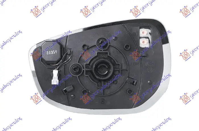

Like I said, there's a small chance it won't fit because of socket size differences. Worst case scenario, heat up the plastic backing with the heat gun, then with a putty knife, scrape it off, then do the same with your stock one, then swap the backing plates over. I have high confidence there won't be problems, however, but you are still at your own risk!
