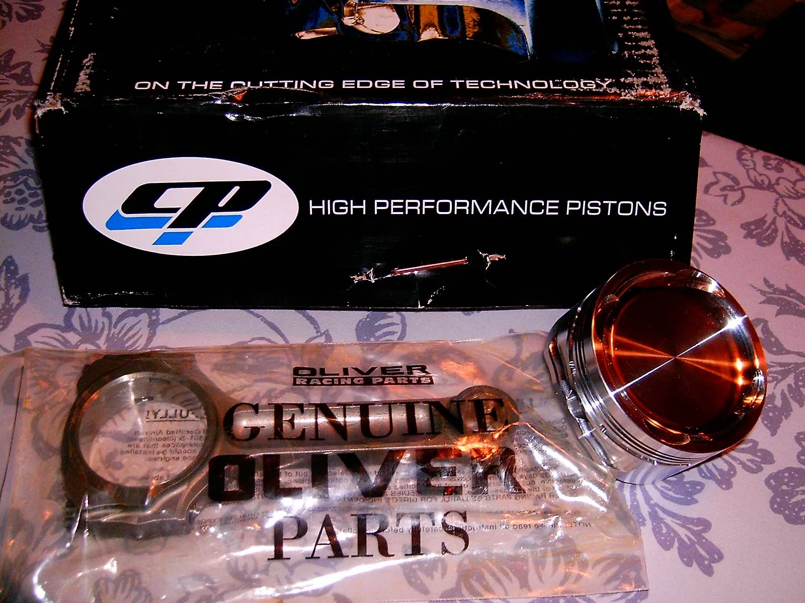

Well I finally bit the bullet and ordered the rods and pistons today.
what did you order? I got my Oliver long rods and my CP 8.5:1 pistons now, they are sweet looking, to bad the motor was not transparent so you could see them at work :D

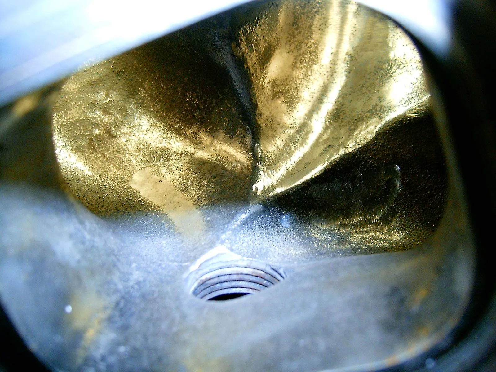

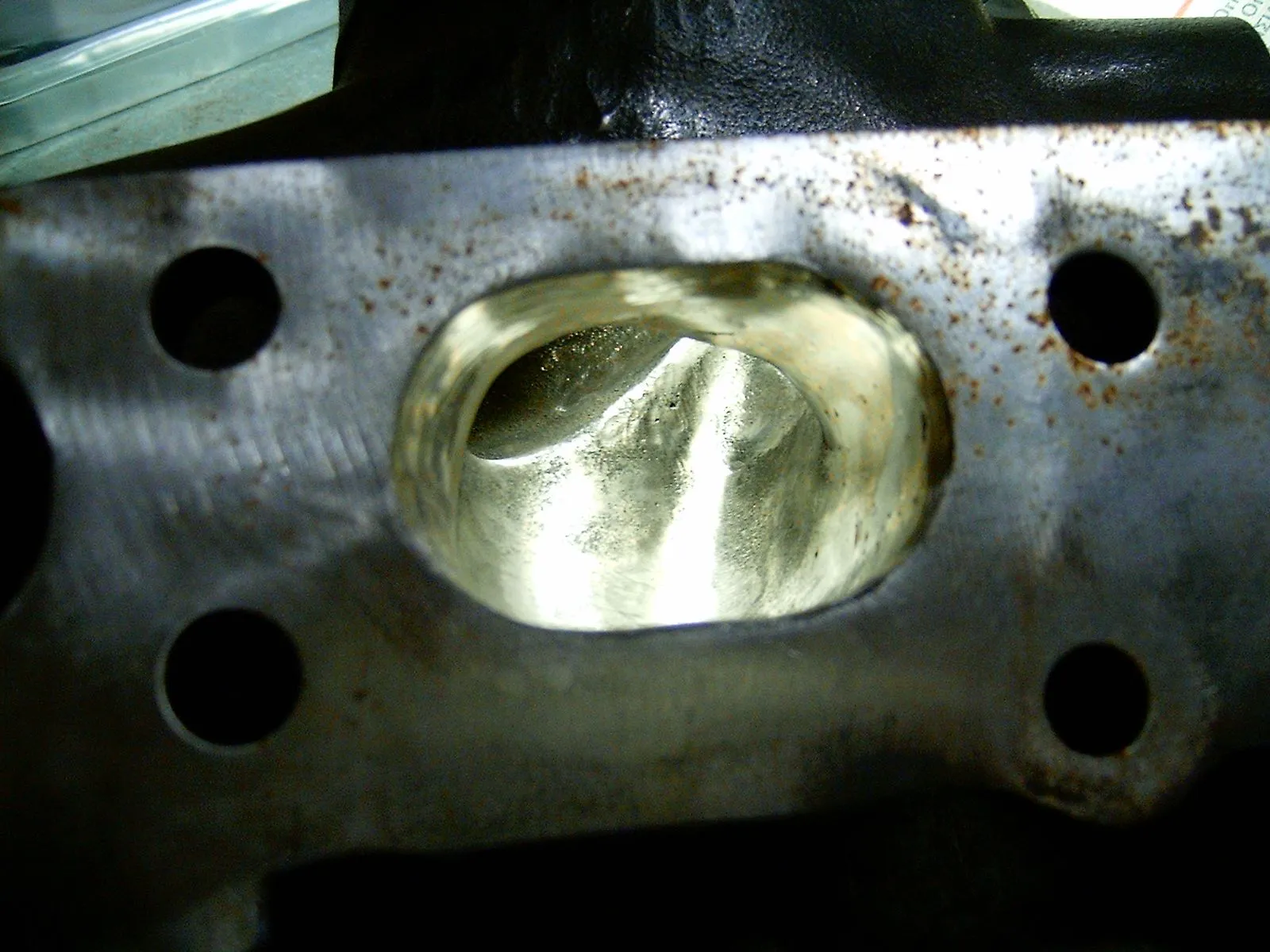

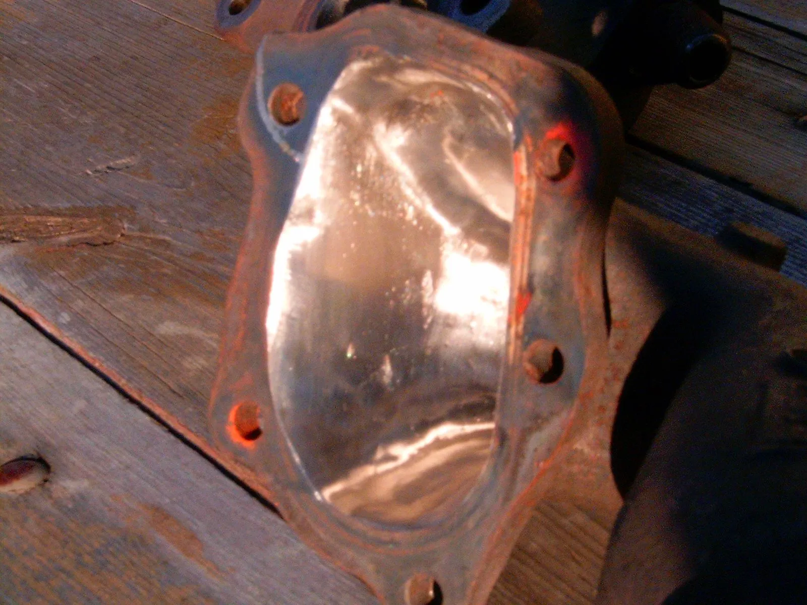

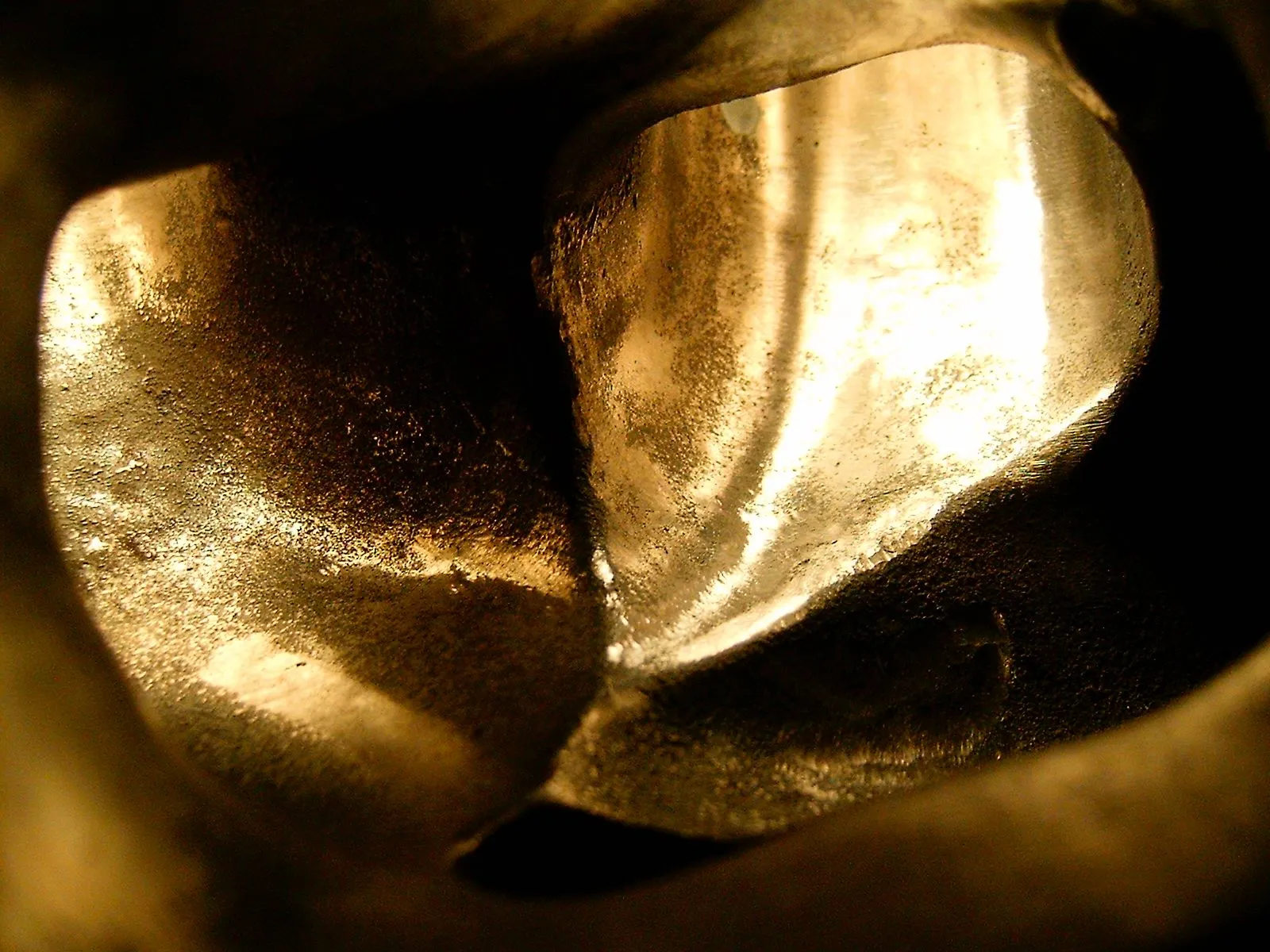

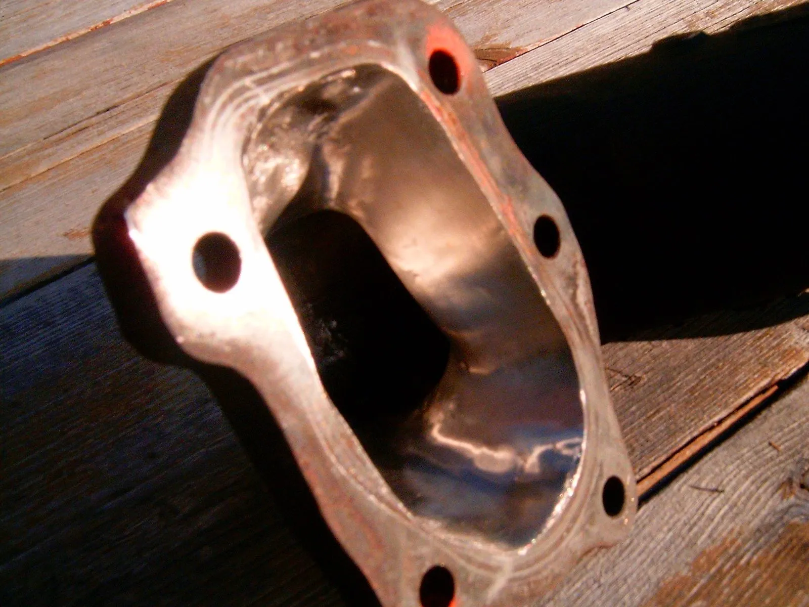

Well I'm pretty much finished on the s-pipe and manifold. If you've seen the inside of the stock s-pipe and it's shape you can appreciate how much work was done.

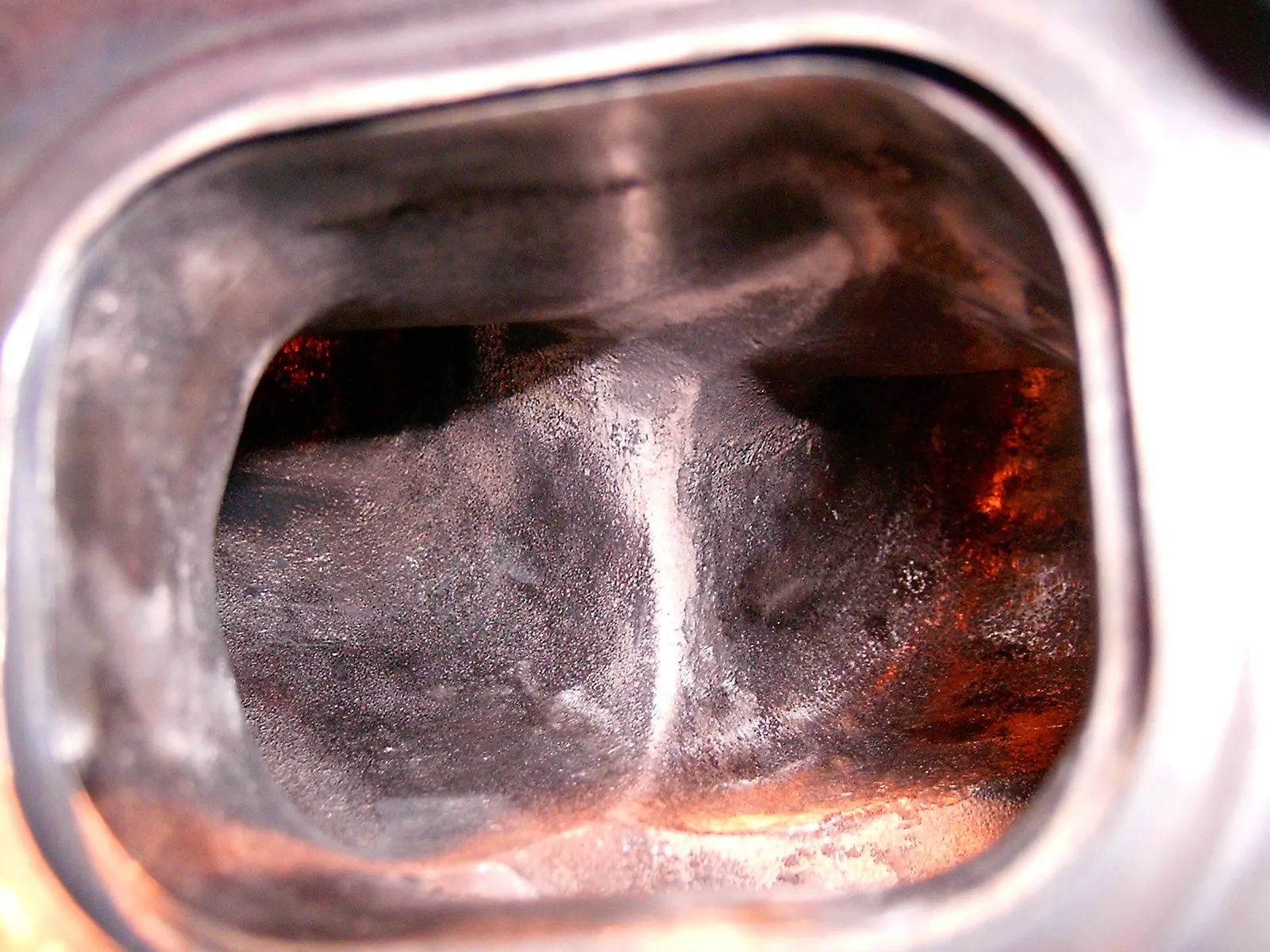

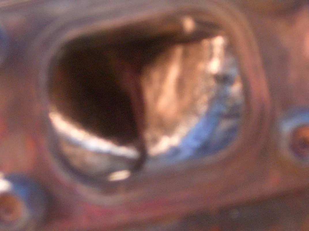

yeah, yeah, I know these pictures suck. Just look at the shiny stuff. This is looking inside the manifold from the turbo side.
here's alittle bit better of a pic.

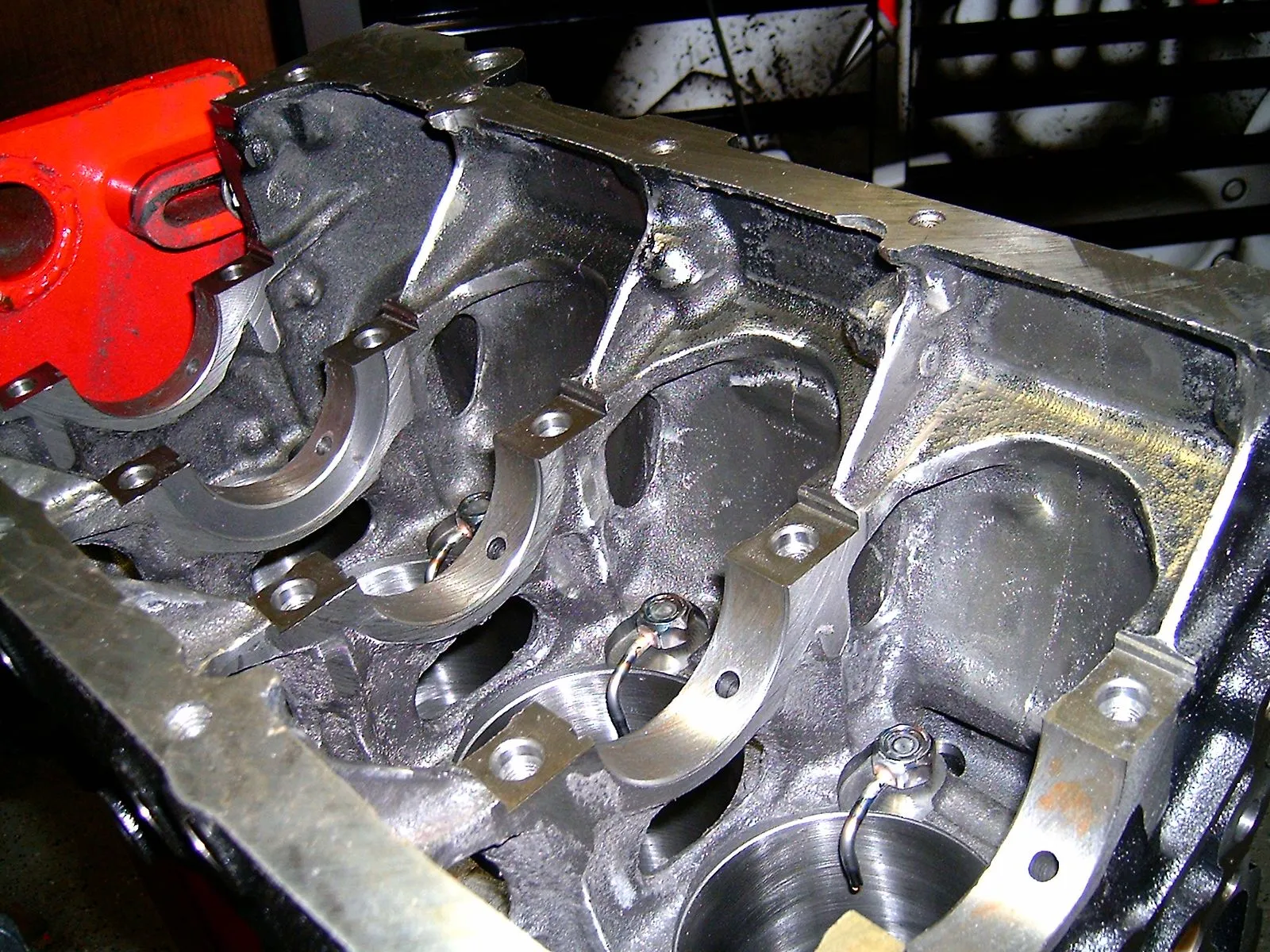

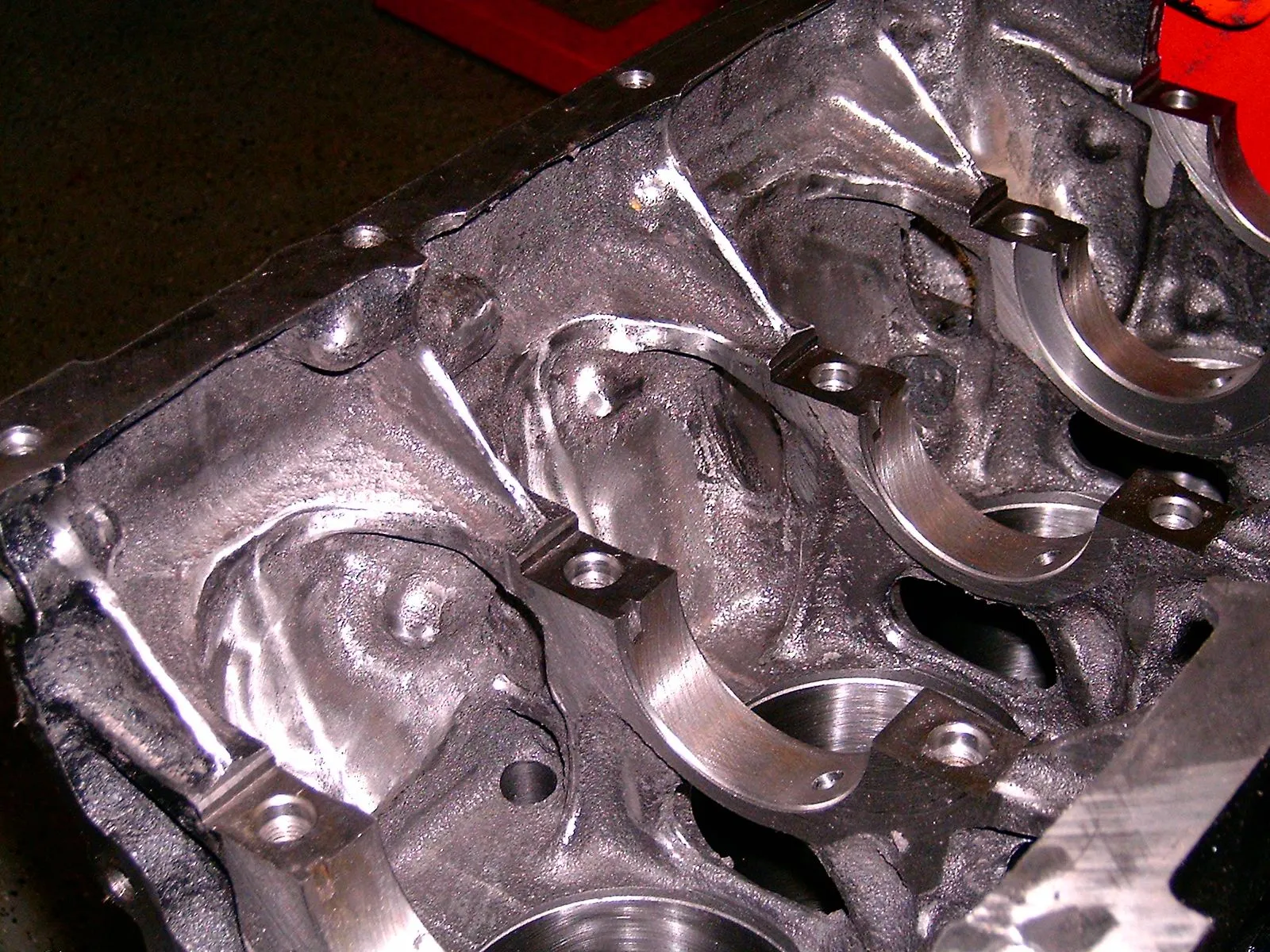

Finally getting to the block... Here are some before pics.

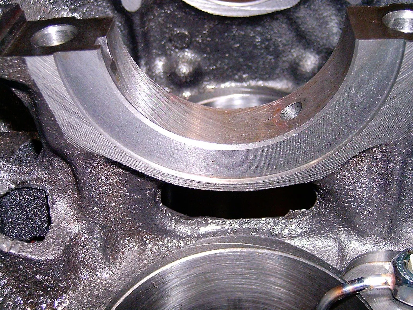

The nasty flashing and lots of stress risers.

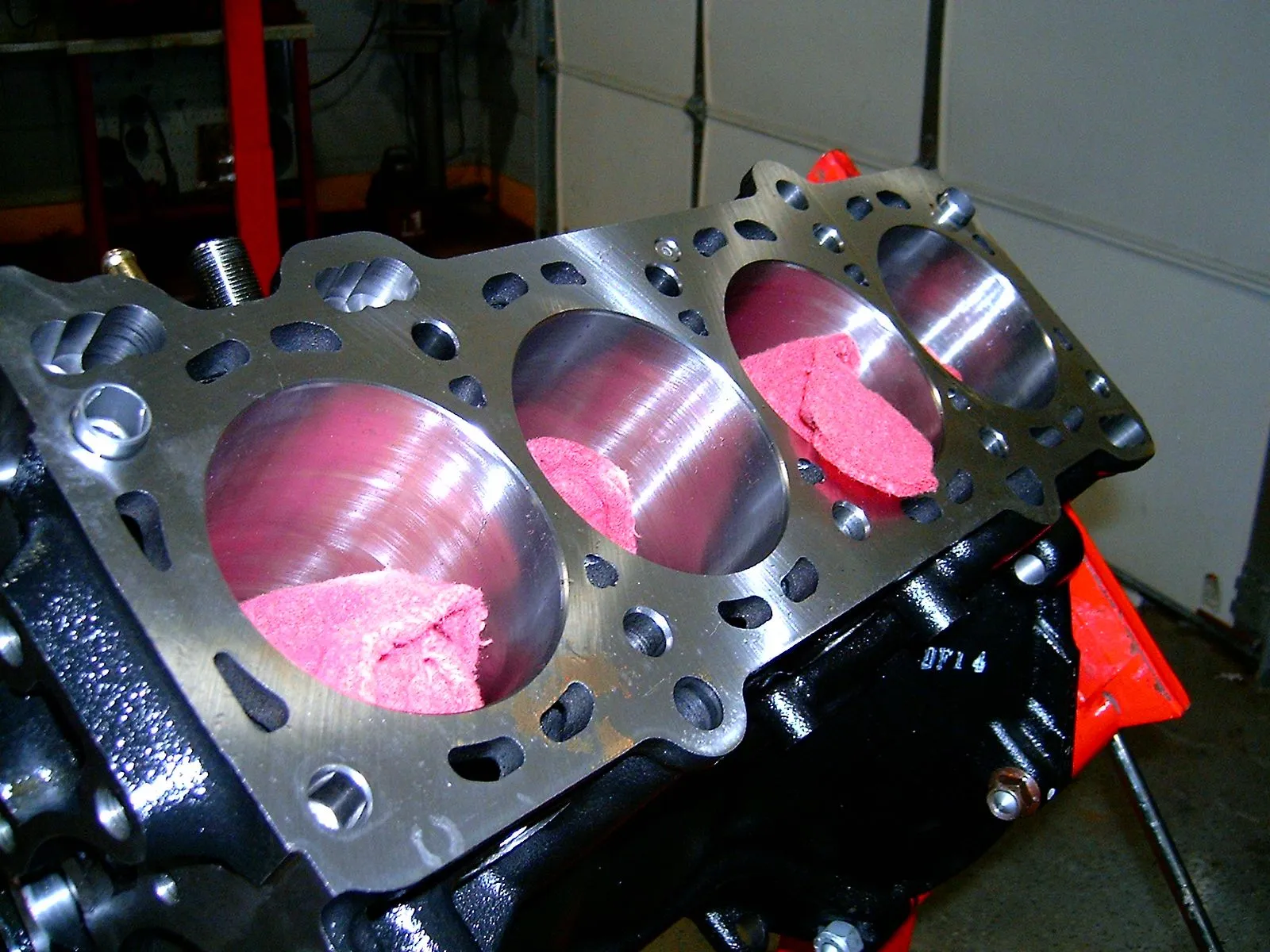

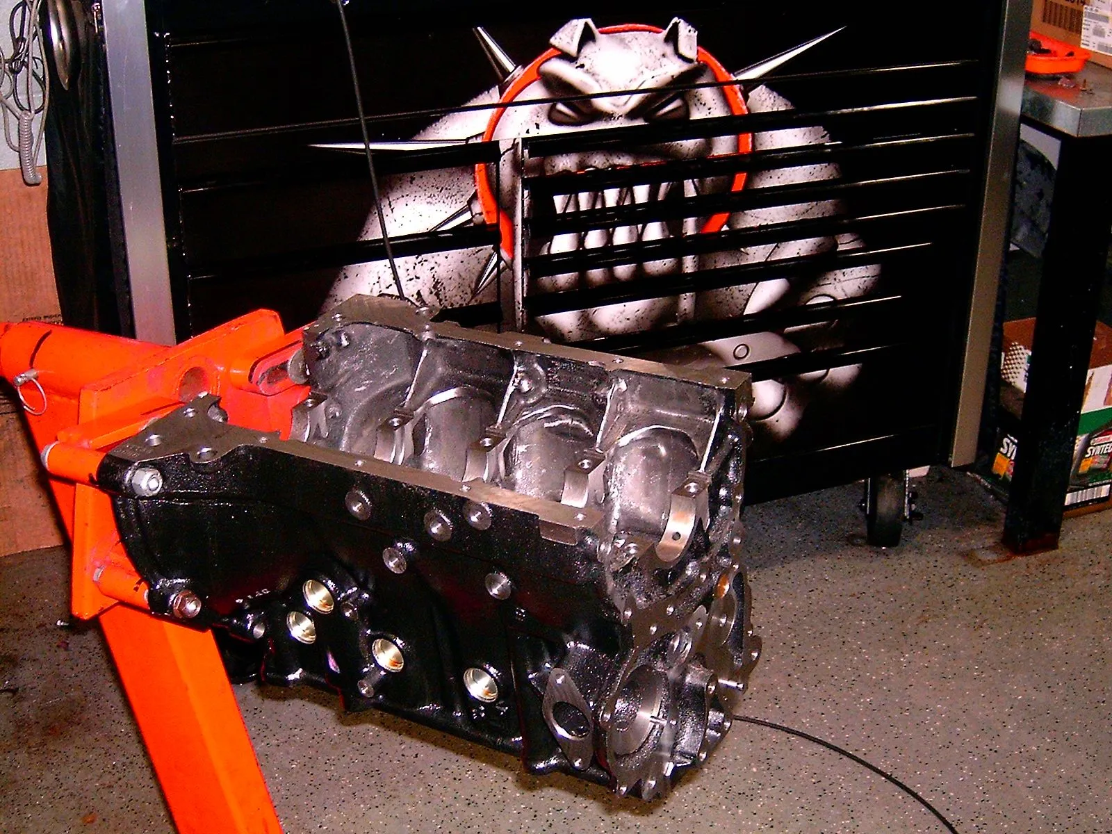

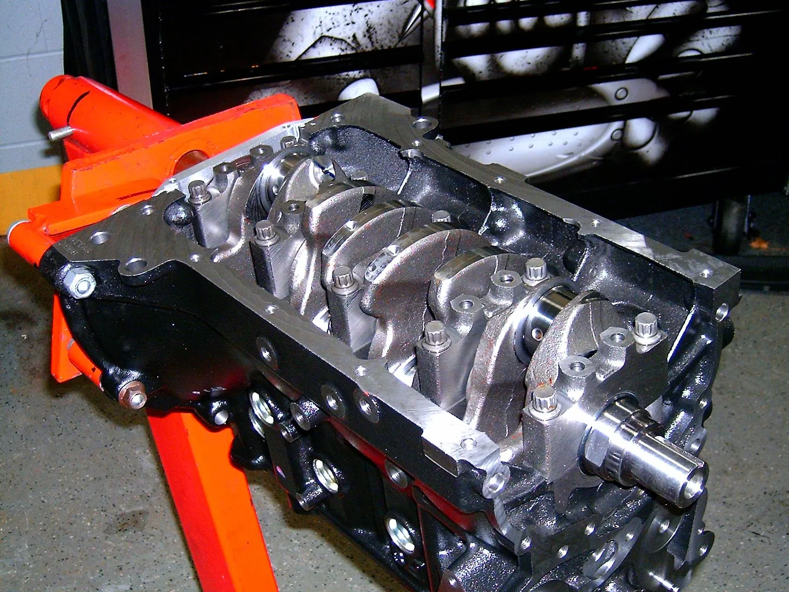

here's some pics of block with prep done.

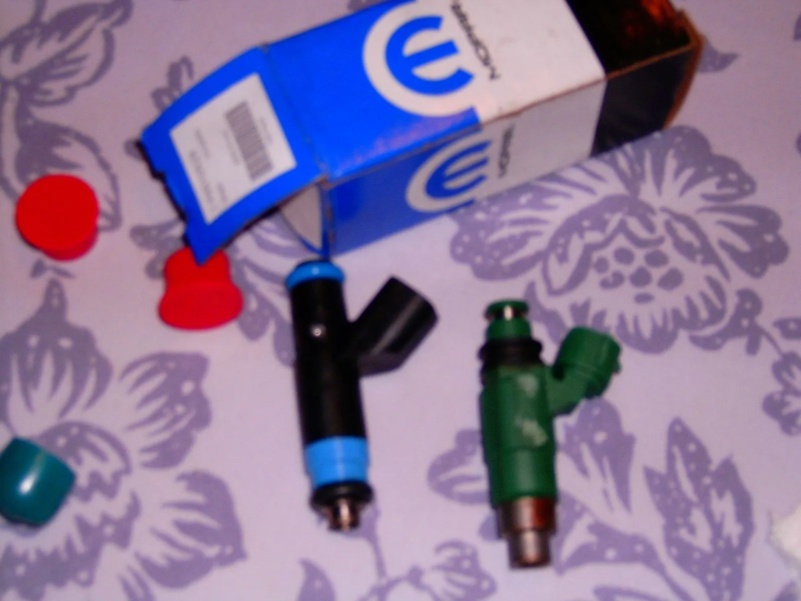

Here's a comparo of the stock injector against the stage1 srt-4 injector (577cc).
I'm going to try them in the primary side, just so when I can't get it right Nick can tell me "I told you so".
