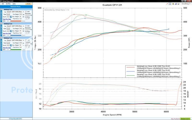

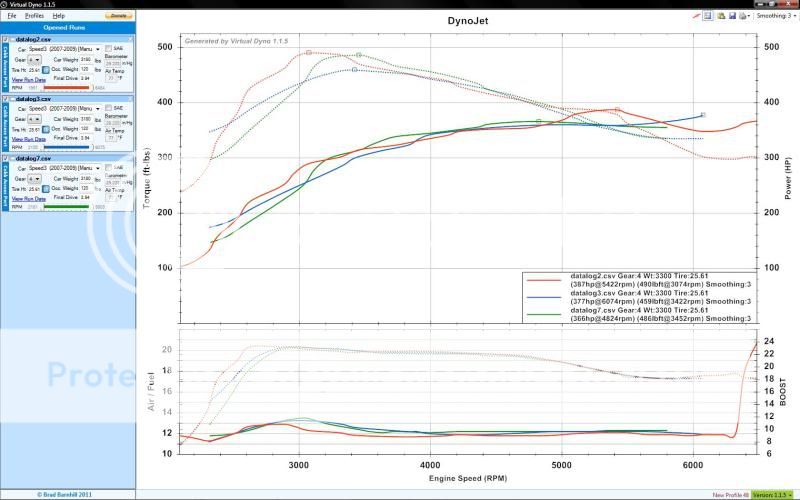

Recent logs: Todays with stupid wheelspin in 4th and yesterdays with the Dynojet correction factor.
AP Wins.
Well, if we correct to 1.01, which is not what most people are doing, I guess, I must confess . . . I come up a huge 7 whp short. 293/303 on that particular 4th gear log. I suspect that's in the margin of error for a chassis dyno variation from one day to another. No excuses, however, it is what it is. The data is the data. The power being made "up top" is due to pretty damn aggressive timing - 16.5-17 degrees above 6,000 rpm which is possible by tapering boost and keeping AFR's rich on the little K04. How are the AP fanbois doing on VD with same correction and similar mods and AP? Post 'um up. Inquiring minds want to know.
Oh, and Domino's opinion amounts to "Don't confuse me with the facts." I continue to laugh when I see how close the can-o-tune HT can come to the mighty AP, and sometimes exceed (not tying to say it's "better" whatever that means, anyway) when we stick to the stock K04 and bolt on mods.
Any day:
CAI/DP/Tune-
93 Octane at 1.09CF:
93 Octane at 1.01CF (Dynojet):
E85 at 1.01CF:
E85 at 1.09CF (Dynojet):

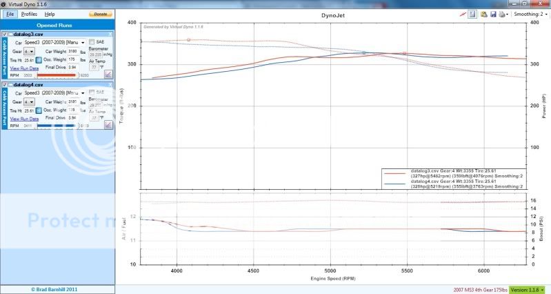

Phate. Thank you. Finally some objectivity and sense. I must point out that my datalog that produced that VD chart was with ambient temp of 90 degrees, so I think the numbers could be a bit higher in cooler weather, and I made no SAE correction for the high temps.
In November I developed a boost leak (fell to wastgate spring pressures) which I chased for a long time before discovering a tiny partial split in the hose from the turbo compressor side ( close to the nipple where the pill is) to the wastgate actuator and another one in the fitting going to my manual boost gauge. Those leaks developed after that October run, so I'm not trying to make any excuse. But chasing them down (finally with a boost leak tester) and fixing them, has dominated my spare time until lately. Now it's the rainy season here. So not much WOT datalogging opportunities since then. I want to replace the plugs and clean the AEM dryflow filter, get some spring weather, find a local dyno that can handle fwd, and maybe track the car one more time. Need new tires too! It never ends, does it?
But maybe a dyno and some new drag strip numbers would sort of lay this issue to rest. I am sort of concerned that boost is building late, as you observed and that I may still have a leak that is unaccounted for. Torque should not be so low when first going WOT, so something is not quite right and I don't think very much of that is in the tune. Maybe I'm wrong. The datalogging software I'm using seems to have a very slow resolution or frame capture rate. We may be seeing boost data that is laggy, running behind rpm and the time slip part of the data. I just don't know. I'm talking to ScanXL Pro (the manufacturer) about that and I may need a faster USB dongle. You'll see that I was only logging about two frames per second and that's not enough. I also think I'll let some of you guys look at an new datalog over on the MSF board if you don't mind a HT user seeking some advice. My wastgate duty cycle data is different than it has been in the past. I'm playing with a Grimmspeed EBCS in two port mode right now.
Anyway, thanks for the honest and straight up post. If I ever decide to try E85, I'll jump to AP and try to get carefully into tuning. I still worry that some guys are oversimplfying the technical knowledge required to do it right and downplaying the risks of making a mistake. Finally, I don't want to be dependent on a tuner that may become unavaillable or rely too heavily on board help. If I can't do it safely myself, I'm not inclined to want to take the risk.
