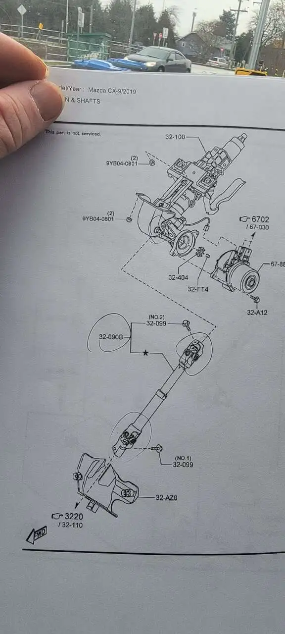

Ez guess would be outer tie rod but thats a new one. If it just all of a sudden happened I would say something is broken and not worn out if that makes any sense. Need a helper to be on the outside to isolate. You think its on the outside? Maybe the steering column spline under the dash?

That's really interesting. I think thats your electric power steering motor. In the old days the steering shaft would go down to a frame mounted gearbox, then the force would be transferred thru a pitman arm. There must be some normal force fore and aft but contained by that steering motor. You have "wander" of the front end on the highway? Hate to see that come apart on you when your driving
Side note I found a YouTube video of someone with a cx5 that the pinch bolt had come loose. The one clamping the u-joint to the motor shaft. It was meduim tight but he said it was creaking for a long time. He gave it a little bump and fixed his noise. Yours isnt that. Yours looks like a bearing or thrust bearing/washer failure. Car ever been in an accident?
I checked the pinch bolt already has no play, never been in an accident.
