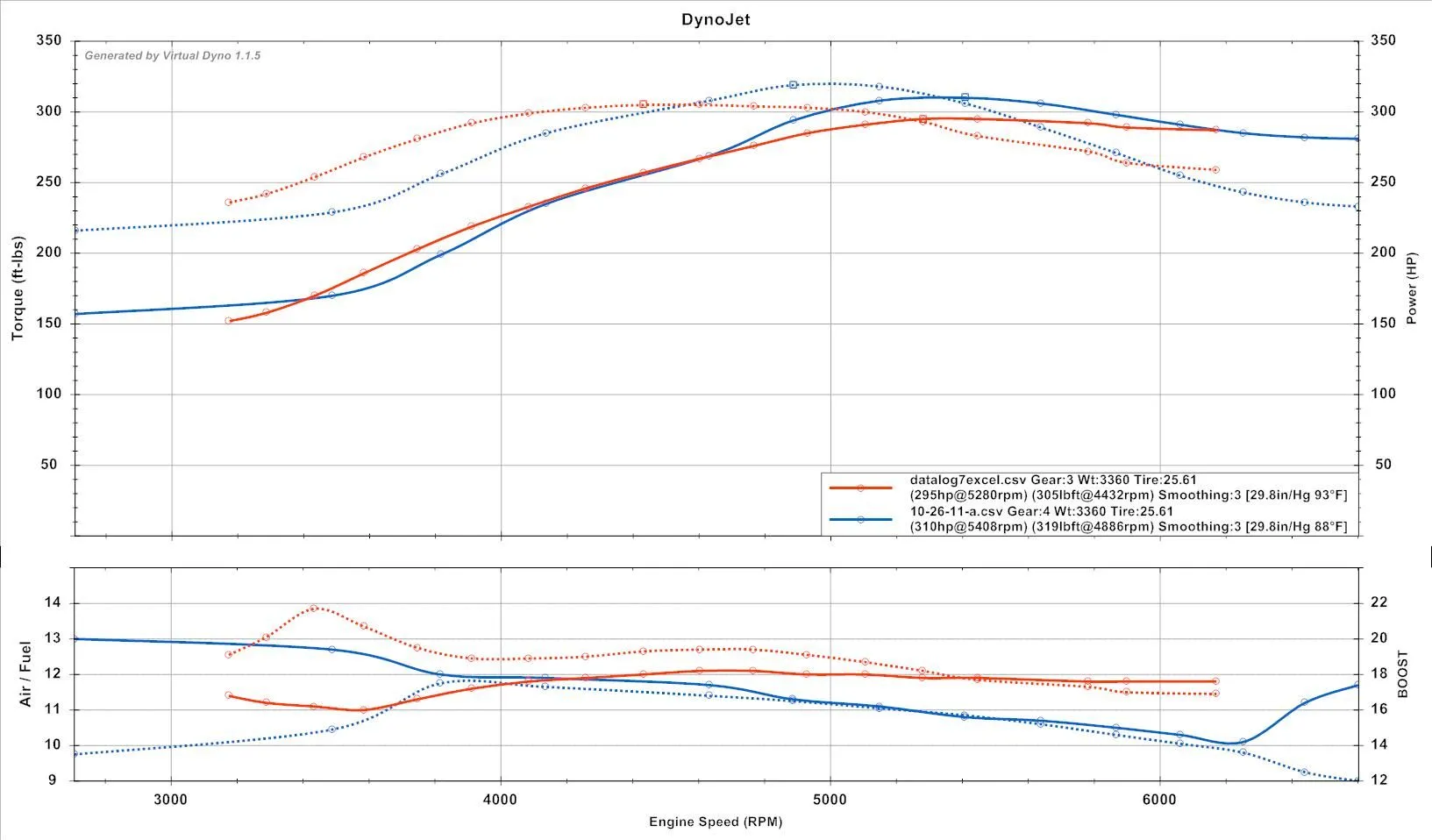

Oh, just for s**** and giggles, so to speak, I ran my 88 degree F. datalog and your 93 degree F. datalogs through VD.
Objective data comparison. VD's assumptions, whether we agree with them or not.
DynoJet protocol. Assumed same barometric pressure as my datalog for both. Assumed my weight for both. Same smoothing.
The chart is attached.
OP's in red
MSMS3 in blue
I'm open to opinions regarding the relative effectiveness of the two tunes. BTW: The boost drop and rise in AFR's out at the end of my log is because I let up on the throttle before I stopped logging!

Please understand ^ that I do not contend to know it all, or even to be sufficiently knowledgeable enough to custom tune with AP. That is, in fact, my very point. I'm very modest about this. It seems to be AP guys with, what I would respectfully suggest, is a certain unjustified degree of arrogant superiority, who are unwilling to admit the capabilities of HT when used with the stock K04 turbo.
If I can achieve essentially the same performance as OP's custom tune on the stock K04 with pretty much the same mods, but using HT, and do it with uber safety by keeping AFR's richer and boost lower and more within the efficiency range of the turbo, then I think HT is a pretty good alternative for those of us who are using simple bolt-ons.
You did look at the VD comparison, right? I'm lower on torque below 3,500 rpm (where I would question its benefit and the need to run 22 psi of boost to get that) but considerably better on torque and hp from 4,000 rpm and higher, especially in the band of 4,000 to 6,000 where WOT is likely to take place under competitive conditions. Not saying it's a lot better, but trying to make the point that AP is not showing me any superiority at my mod level. HT is a reasonable alternative for just about any bolt on mods if running the stock K04 turbo.
Just one opinion. I continute to be interested in comments on the comparison of the two VD charts.

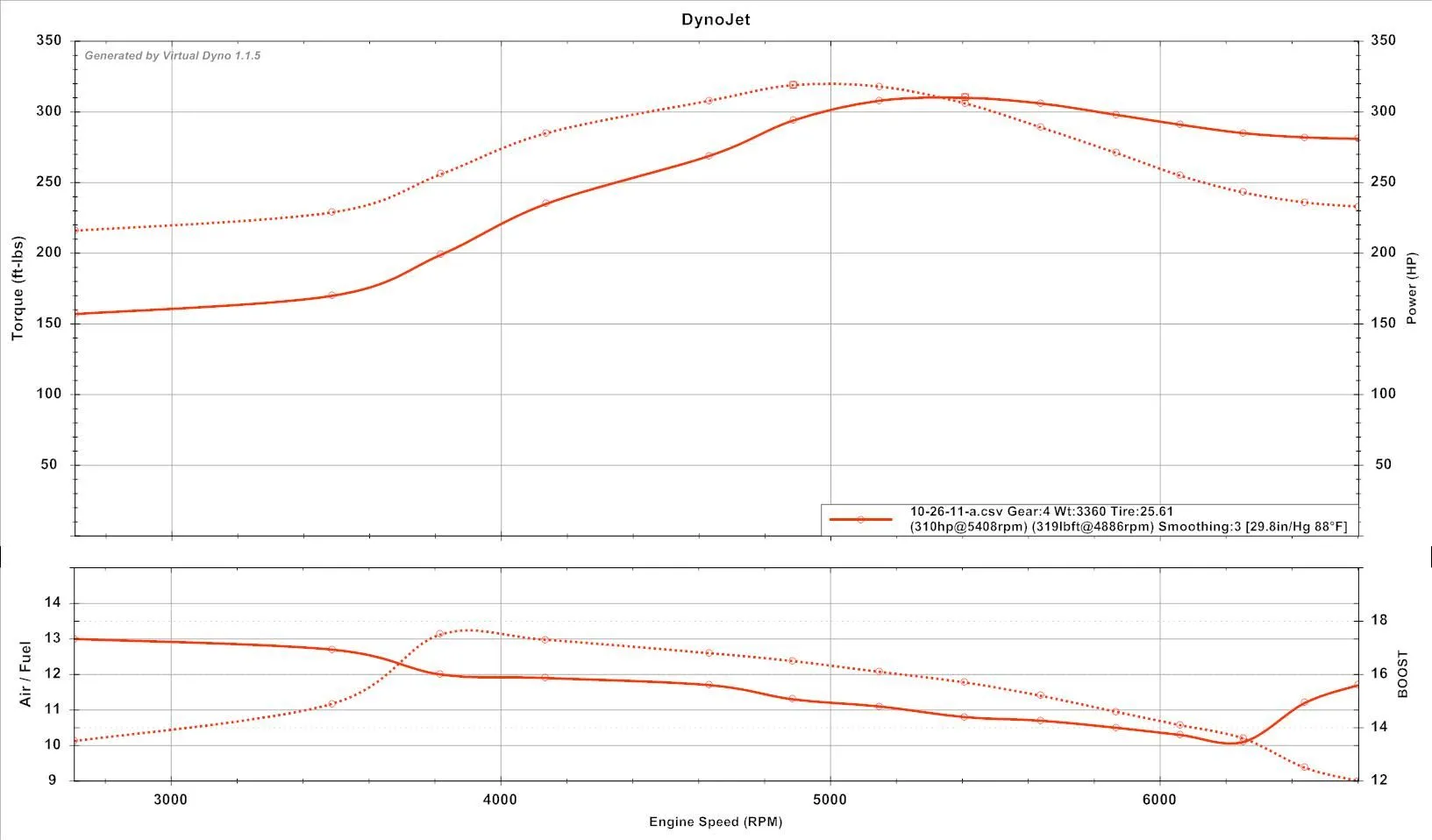

Oh really? Virtual Dyno chart on my HT flashed MS3. I do have a downpipe too, but HT is very friendly to it and smoothed out the 21 psi boost spike I was getting on stock tune. This is with stock TMIC, stock BPV. Only an intake, the dp/rp and HT and one step colder plugs. I actually added a third reso in the rp section to control drone and still got these numbers (peak 310 whp/319 tq with 280 whp still available all the way out to redline). Mods detail listed below in sig:
If your correction factor isn't 1.01 those are inflated numbers.
Otherwise, let's see an actual, repeatable dyno of 310whp with HT.
Well, if we correct to 1.01, which is not what most people are doing, I guess, I must confess . . . I come up a huge 7 whp short. 293/303 on that particular 4th gear log. I suspect that's in the margin of error for a chassis dyno variation from one day to another. No excuses, however, it is what it is. The data is the data. The power being made "up top" is due to pretty damn aggressive timing - 16.5-17 degrees above 6,000 rpm which is possible by tapering boost and keeping AFR's rich on the little K04. How are the AP fanbois doing on VD with same correction and similar mods and AP? Post 'um up. Inquiring minds want to know.
Oh, and Domino's opinion amounts to "Don't confuse me with the facts." I continue to laugh when I see how close the can-o-tune HT can come to the mighty AP, and sometimes exceed (not tying to say it's "better" whatever that means, anyway) when we stick to the stock K04 and bolt on mods.
