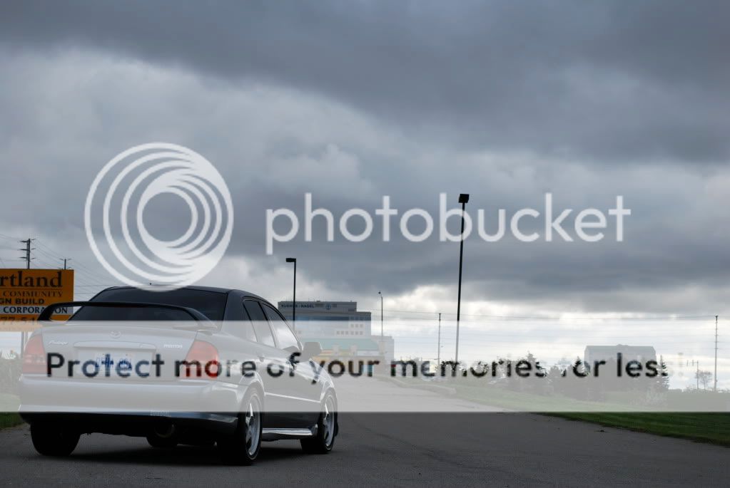

Currently I am running 16x7 +42 offset, want a bit more aggressive. Tire size is 215-50-16.
Thats a current pic, What size spacers should I get? Are H&R's any good?
+40mm offset is about the lowest anyone has gone without rolled fenders. I'd guess you could get away with 5mm spacers, but I'd roll your fenders first. +35mm is the lowest without camber plates if I've read correctly...
On your car, yes, 5mm will push them out, but not VW style (aka past the fenders). The advantage of going with 5mm spacers is I don't believe you'll have to change out your studs.

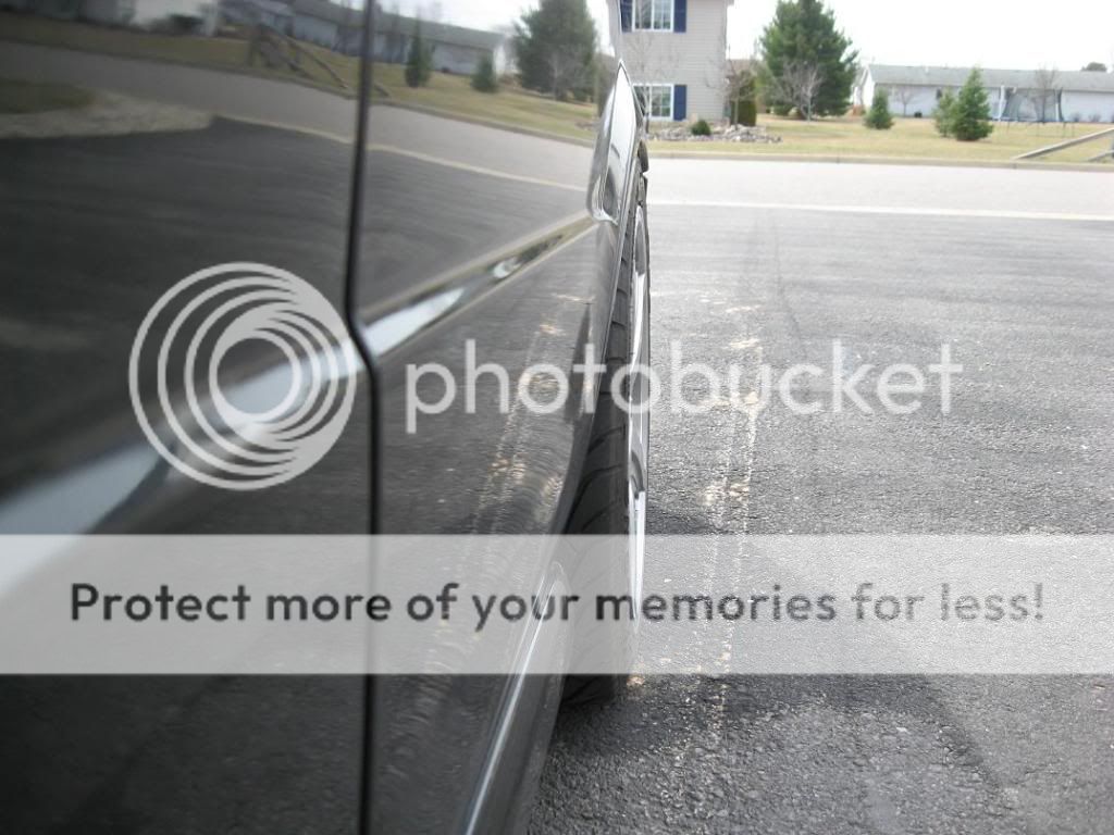

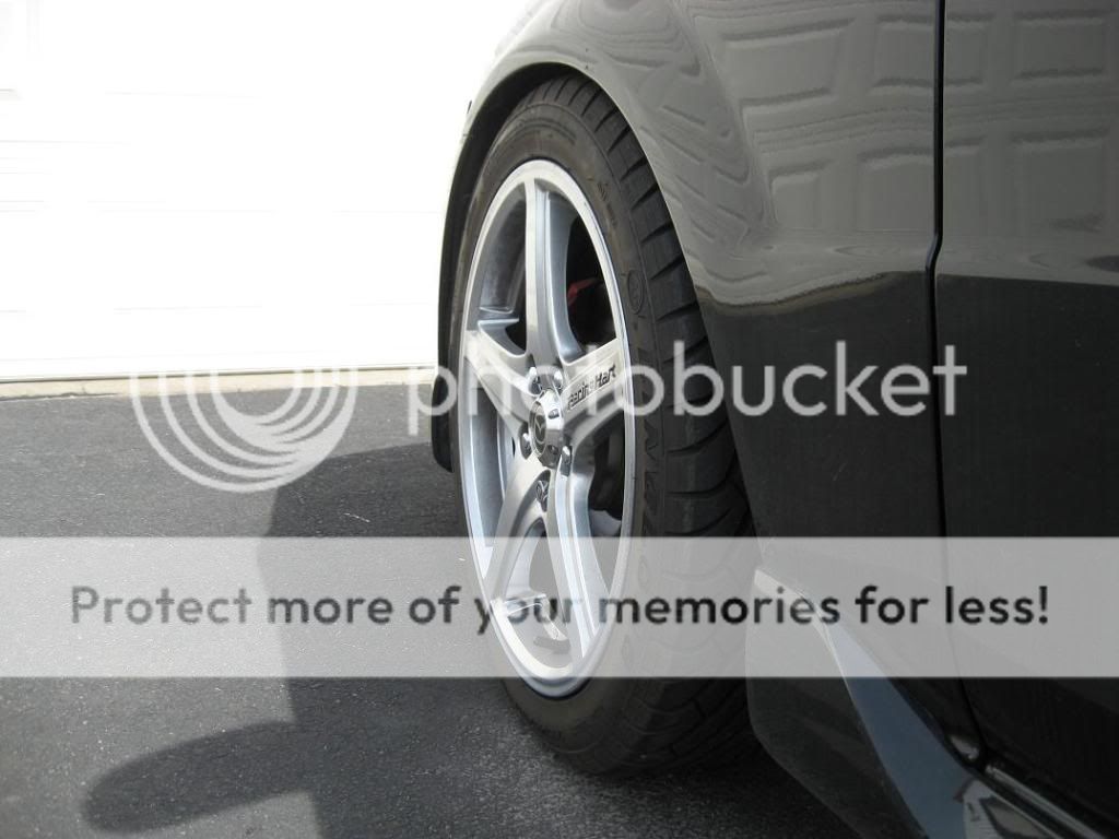

Been following the aggressive and wheel spacer thread so I decided to test some 15mm hubcenteric spacers from my buddy's parts bin.
OMG... I am so excited to get mine now... that's pretty much PERFECT fitment!!!
I know it's not recommended but I think a 25mm spacer up front would flush with the fender. I didn't take it for a spin yet but tried to put some load on the rear to see if it rubs but no luck. It looks like it will clear(dunno)
I know it's not recommended but I think a 25mm spacer up front would flush with the front fender. I didn't take it for a spin yet but tried to put some load on the rear to see if it rubs but no luck. It looks like it will clear(dunno)
