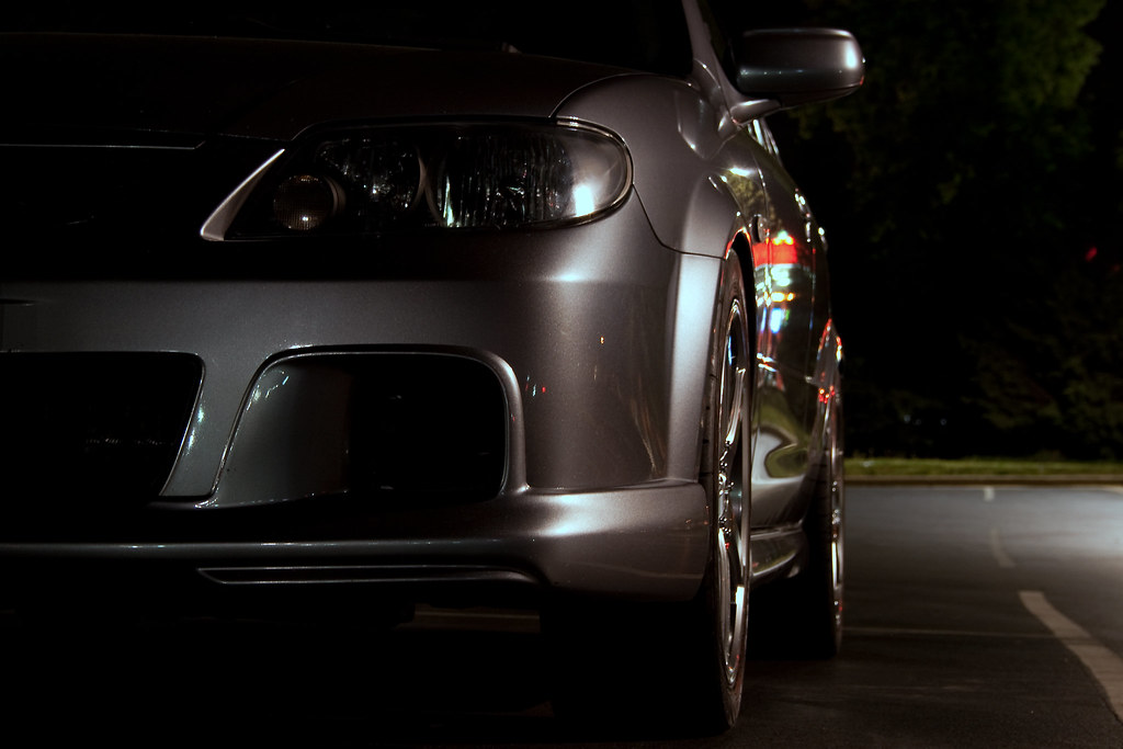

Looks good, Thomas (thumb) My brother picked up the 10mm Ichiba Spacers for the RH's, he was afraid the 15's would be too much. I like em though....
Thanks bro, yeah u need an aggressive fender roll to run 15mm spacers, but then again im slammed on skunk sleeves
Dude, I'm on Ion fronts and normal MSP rears with Illumina struts and my 15mm spacers rub like a b****... I need to fix my roll too, but only by 1 or 2mm.
