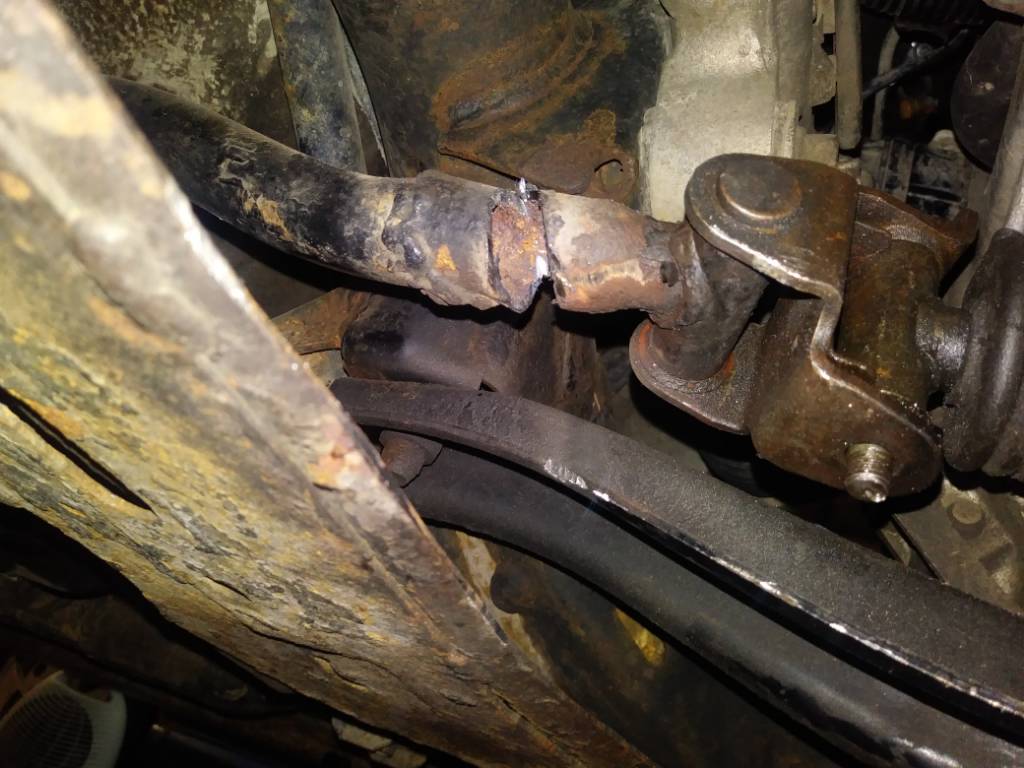

Cut my shift linkage. The pin is just deadlocked. Ugh.
Just thinkin...
Try reefing a Vicegrip on the threads showing of the pin and see if you can rotate it to break it free...
Hehe yeah, it's been a week of pullers, hammers, clamps, grips and swearing, then I noticed the crap weld on it, realized it was cut once before and just applied a cutting wheel ( gently ? ). Very very satisfying to cut and chuck.. when I finally drop the transmission I am going to have a closer look at it.
The one from the parts car actually came out with a puller first try. Go figure.

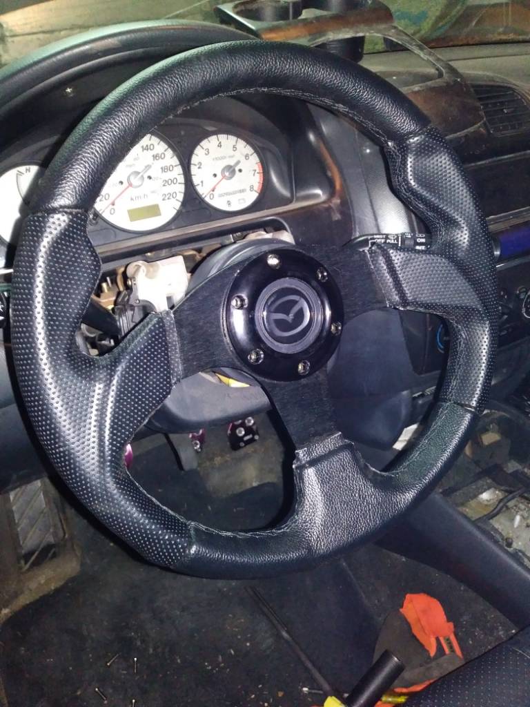

Nice wheel. Complete with Mazda emblem.
