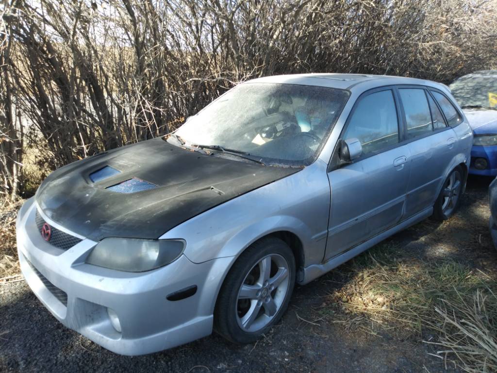

In the past couple weeks I have replaced the two broken rear seat belts, installed LED bulbs in the rear brake lights, replaced the broken passenger hatch plastic with an unbroken piece, swapped the rear spoiler that does not have clearcoat damage all over it and put some foam on it to keep it from rattling, got the car titled and inspected, removed the front plate and bracket, installed a Cobb front plate delete (bolted right on), installed 03.5 MSP front floormats and door sills, found a leather passenger front seat that is not totally destroyed at the junkyard for $30! and swapped it in, installed an old Pioneer double din screen I got from a friend, installed an amp wiring kit, Blaupunkt 750 watt amp and Rockford Fosgate P1 8" sub in the hatch area, installed a mazda6 wagon rear wiper, wired the windows to be always on, cut the wire for the door beep, installed a new AC fan switch and replaced the melted/charred harness connector (AC works on all 4 speeds!), swapped the HVAC/radio panel with a mint one I found at the Junkyard that didn't have broken clips, replaced the broken hazard switch, installed the intermittent MZ6 wiper stalk, swapped tribute washer nozzles and tightened the E-Brake cable.
Next I want to swap the less dented passenger side doors on, install my MSP kenwood rear speakers, get the windows tinted, pop some of the dents out of the body, remove the side moldings, black out the headlights and get HID bulbs.
Still have a huge list of things to do, but the car is becoming more pleasant to look at and drive. I am starting to like it! But I still want to put a turbo on it.
Began tear down. Plan is to clear and clean engine bay. Transmission is going into silver p5 and then a laundry list of repairs on the pair of them.
Got a new OEM primary key cut to work on the P5. It came with the valet key and I didn't like it, plus I wanted to have a back up. Also removed the tint on my new passenger side doors and started pulling the black door vinyl off of them. Realized my LED bulbs are preventing my cruise control from working, so I plan to swap those out soon. Wired up the fog lights to come on with the parking lights. Removed the roof rack cross bars. I just put caps on the rear for now since I had them, will install the roof strips eventually once I feel like pulling the headliner and getting at some of the dents on the roof. Replaced the gauge cluster bulbs since one of them was burned out.
I had to kind of rig up the throttle cable to work with the ZE intake mani since I was unable to figure out how to adjust the throttle cable, and only was able to put one bolt in the cable bracket. The bolt came out last week since the hole was slightly stripped, ended up putting a longer bolt in with some loc-tite and securing the cable better and the car runs so much better. The cable before wasn't aligned properly and only opened the TB about 40% when the pedal was to the floor, now the car will actually go WOT and feels like it picked up 30hp!
