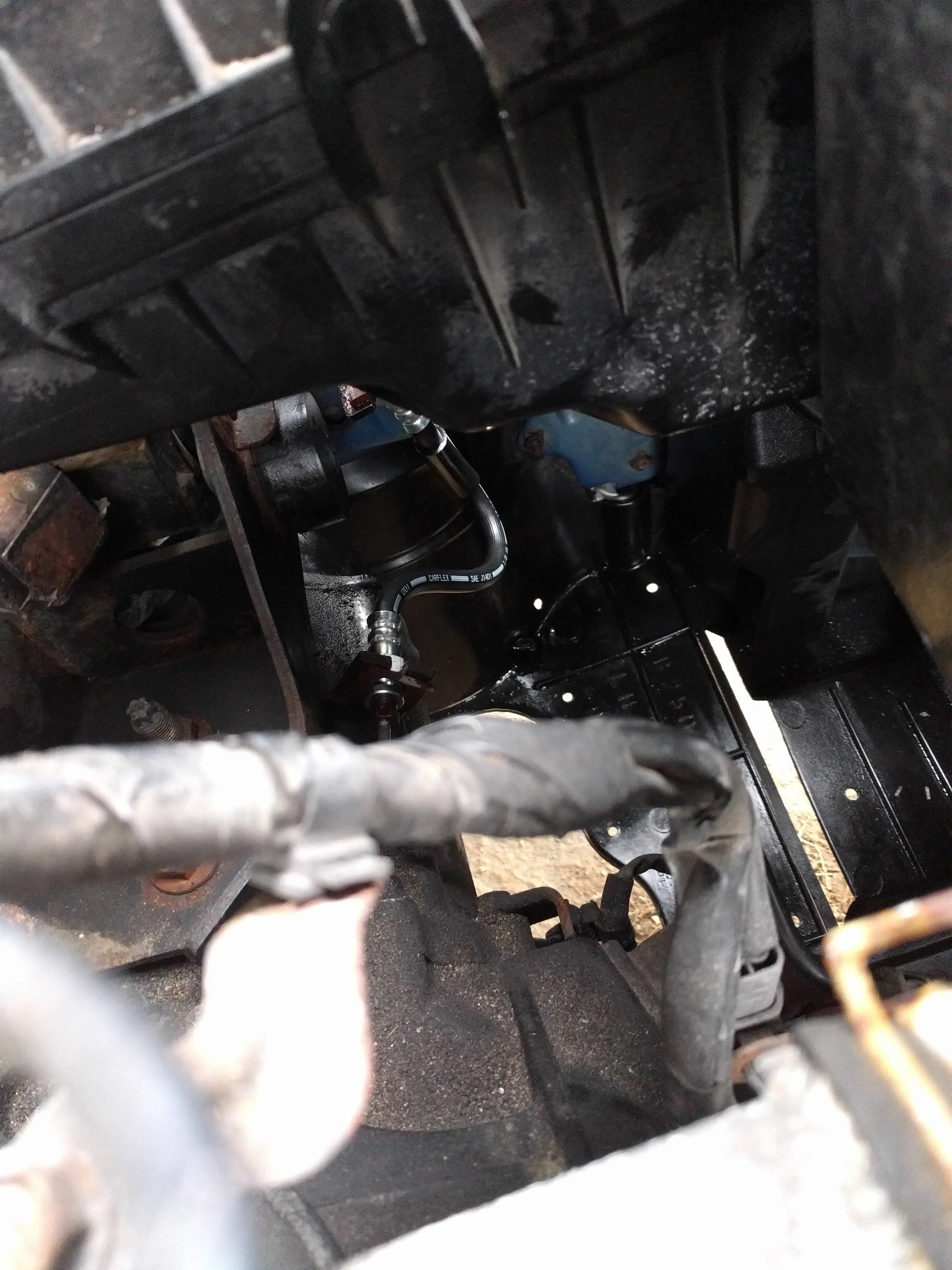

Friday night, company party in downtown DC. Husband picks my co-worker and I up after work in the P5 and about 2 blocks from the restaurant, I hear him pumping the pedal, car not sounding happy, etc. Pull up to the light, he turns the car off, puts it in 1st, and we sort of limp through the intersection, about 1 block from the restaurant now. I ask what's going on and he says the clutch is gone. My co-worker in the backseat is clueless when it comes to cars. We manage to drop her off at the restaurant, and go to find parking. Oh, we were going to do valet parking.... Fortunately, the guy manning the parking deck booth let us park the car ourselves after seeing us lurch up to it. Have dinner, and decide to try to make it home. He thinks it might be the slave cylinder and we're only about 4 blocks from the highway. The highway which will take us 25 miles of the 28 mile trip back home and we'll happily pay the $2.55 toll to not have to touch the brake or clutch for those 25 miles. Using various tricks, limp home and decide to diagnose in the AM. Sat. morning, he pumps the pedal with the hood up, jet stream of brake fluid from under the airbox. Turns out the rubber clutch hose had sprung a leak. Localish Autozone has one in stock, so we order it to pick up after attending another holiday party that afternoon. Picked it up Saturday and replaced it Sunday morning, good as new.
