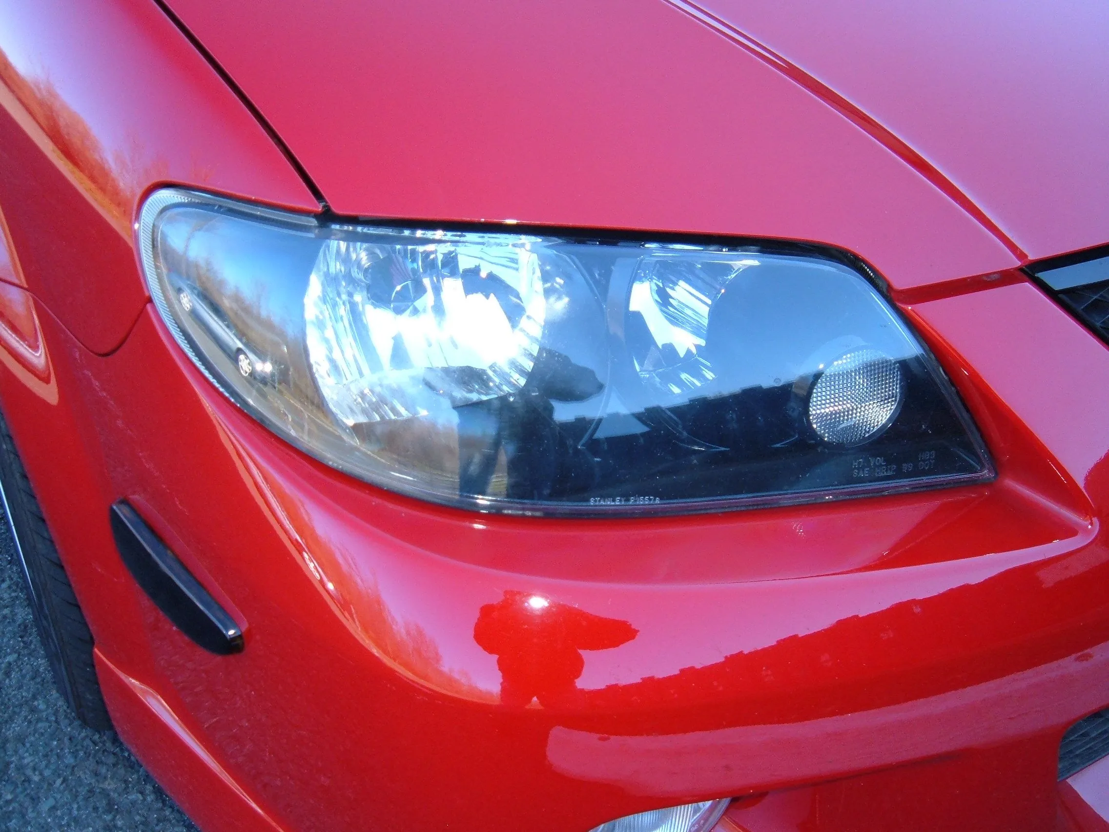

Mmm, so... What sorta paint would I want to use to paint the inside of my headlamps? I'm looking to paint them black or a rather dark grey. Ill probably do this all a little later when I have a retro kit so I dont have to open the assy twice and all. That would b much appreciated :)

Anything high temp will do. Just lightly sand the bezels and spray on. Mine has held up great the last 3 or so years.
personally i have been using a krylon BBQ paint with no issues.
Others have used standard spray paint, but i havn't heard how it holds up
And i'm 5 years going on the krylon in the wife's car
i just used krylon fusion (for plastics) and it has held up great on my stockers and still so far very well on my retrofit
Thanks guys :) tbh, I might bite the bullet and try and do that this weekend too. Just for a little bit of a unique look, even though it'll be sitting in a garage for a while!

This...used satin black on mine and very happy with the results. Just wish the lenses still looked as good. lol
