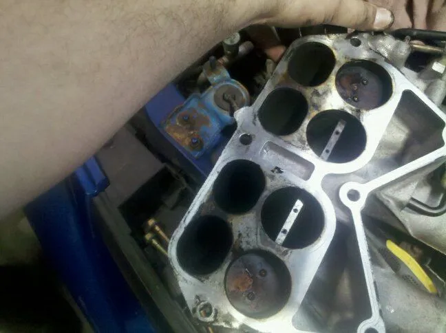

Here's what my intake looked like. Take those bad boys out before it does some damage.

^^^ Well, those are the VCIS butterflies, Chris. The VTCS butterflies are high up on the intake mani.
I've read you should leave the VCIS alone though? I mean, of course unless your screws come out like yours. Not trying to argue with you brotha, just posting what I heard. But as far as the VTCS butterflies, I still say pull those turkeys out.
no biggie. i did the exact opposite. I took out the VCIS and left in the VTCS. I remember reading somewhere, (or we might have talked about it @ the shop) that the VTCS is more for cold starts. Who knows. Heck, get rid of them all. ha ha ha.
