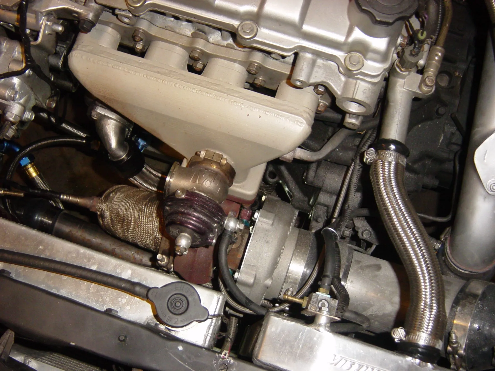

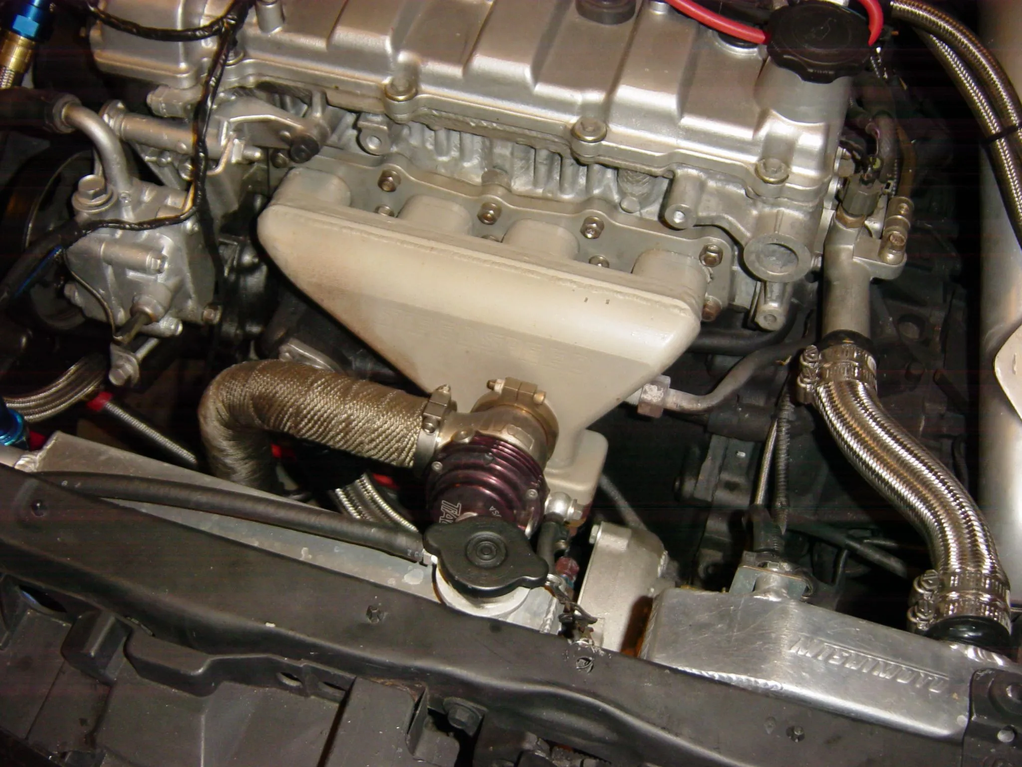

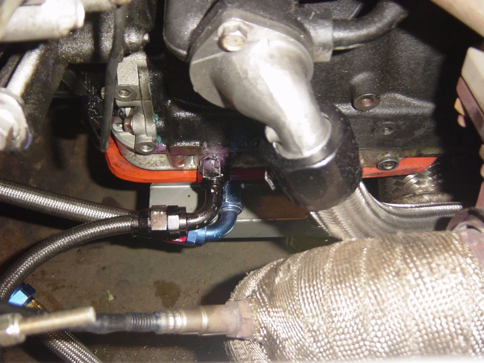

Changed my radiator hose to AN-20 stainless steel hose. What a pain in the ass. I need to get hose end finishers for the upper hose. The double clamps are just for short term.

SS hoses do look good. Remember though, rubber hoses let the coolant breathe while the SS keeps the heat in. Keep an eye on your temps.
I had to use SS because of the way its routed by the Dp. The old one was zip tied to stay out of the way, and ended up rubbing thru and caused a leak. I have been driving it around and the temps are exactly the same. Thanks for the heads up tho.

oh man, it would make your head spin. perhaps mine isnt the right car to do a how to on because of the setup I have. But here are a few things I ran into doing this:
The stock water neck is 1.125" so AN-20 should have been perfect. The problem is that the SS hose doesnt stretch like regular rubber hose. So putting it on was HELL! But I got it to work.
For the upper hose: I used about 10" of hose. AN-20 finishers will not fit. So I am ordering AN-22 to see if that will. I dont have the stock radiator, so measure yours first.
The lower hose: AN-20 finishers will work, but need to be slightly bored out on the open end to fit over the stop tabs. This will allow proper clamp alignment. I dont know the length needed for the stock radiator, sorry.
I purchased 3 feet of AN-20 hose and 3 AN-20 hose end finishers from www.race-mart.com for $85. Its the cheapest place I could find. It seems like a lot of money, but I dont think it will ever leak again.
When cutting the SS hose, it fray's the ends less if you tape it before you cut. I used duct tape. Wrap around the cut mark really tight. Then use a cut off wheel and cut slowly.
