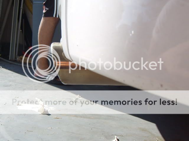

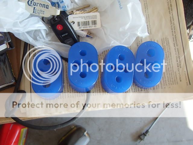

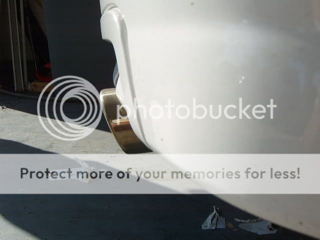

decided to post up the difference between stock exhaust hangers and the corksport ones. first pictures are before..
makes it fit perfectly.
got more pics if interested.
