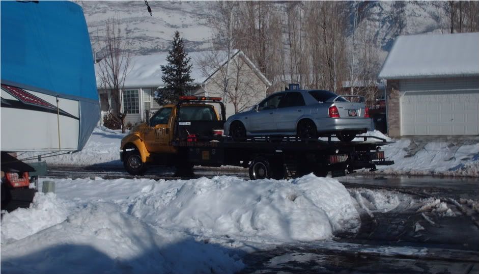

watched it go to the shop today
me too haha i miss driving it haha i should be getting it back at the end of next week unless they find something wrong with the frame or anything when the shop looks at it tommorow

today, I went and looked at it lol. Looks so ssad sitting out back in the car tent. Can't wait for the snow to **** off so I can rip the msp again!
