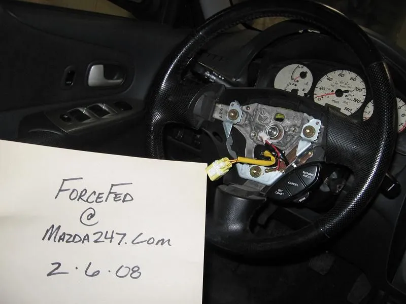

Do any of you guys have any pics of the steering wheel with the airbag removed? I just removed my CC module from the wheel (P5) and I had to disconnect something and sever a ground. Now I don't have a horn so I want to see how the MSPs are configured so I can regain use of my horn.
Not sure why I had this...but here you go. Hope this helps and thank Forcefed if it does!
^^^ I was actually trying to find one of a MSP without the CC. I was able to figure it out though. The electrical connection I removed and the wire I cut were actually providing power to the horn. Well I severed the CC control module wires and spliced back together the power wire and plugged the connection back in and all is good. I'm getting some clicking when I turn the wheel but it doesn't bother me right now.
