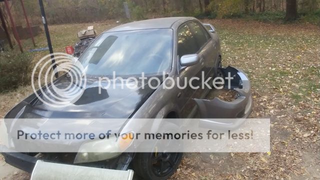

Msp is still sitting. Waiting for me to finish my ms6. Bought a ms3 for the wife. 3 weeks later lost compression on cyl 2/3. Its almost back together. Then time for the ms6 motor.
Also acquired this for the msp about a month ago
Just doing my normal check in.
Omg. Gemini hood
