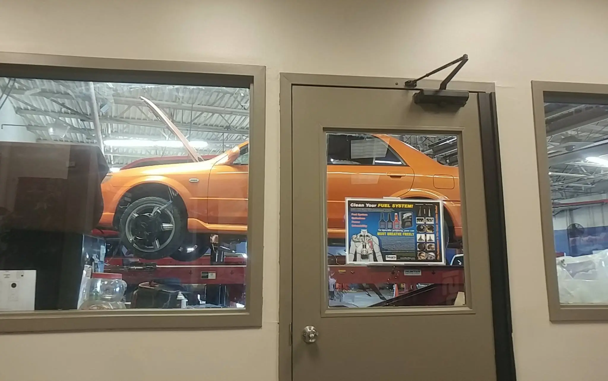

Took 1552 and got an alignment today. I think it is safe to say she is actually now roadworthy! I'm so excited!
