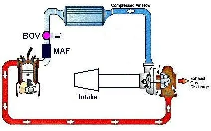

Ok, help me out here guys as I am confused. Im looking at relocating my MAF so i was looking into it today and have gone around in circles.
So, when relocating the MAF it would go (from the TB) TB - MAF - BOV correct? Would you still also use the stock BPV? Or would you remove it and cap the intake line? If so, what about the vaccum line that comes off from the BOV?
Would the set up look like the pic below?

you got it right, get the BOV's vacuum source from the brake booster line, lose the stock BPV and cap the pipe
so what about the T that has one vac line going into the stock BPV? Just take out the T and get a regular connector?
