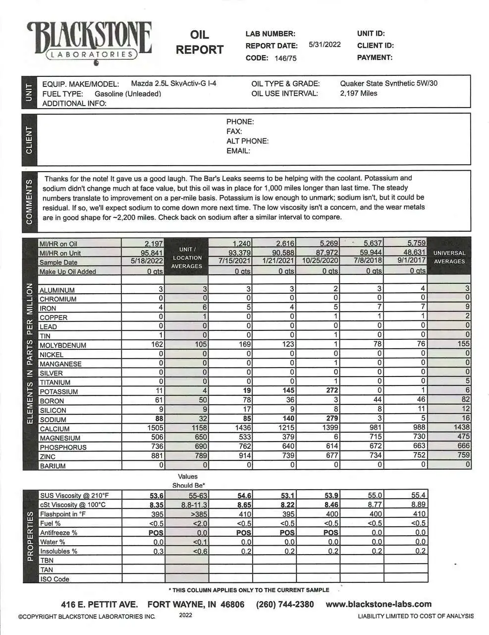

After another 2200 miles, the coolant-indicating numbers are the same, but the oil interval was 1000 miles longer. To me, it indicates that this engine can finish its service life with 2,000-mile oil changes. Blackstone report attached.

From reading your posts, it sounds as if a miniscule leak that is not visible to the naked eye is considered "Severe" by UOA analysis standards.
And that by the time one can see signs of antifreeze in the oil or vice versa that it is probably too late to save.
Never had this happen on any of my previous vehicles but with the potential for these Mazda engines to have this problem,
Sounds like all the more reason to get the oil analysis done on a periodic basis even if it's every other oil change.
Thanks for posting your experience and observations.

I agree with HyFlyer's suggestion that managing the leak with oil changes is an option to be considered. I wasn't able to see your UOA report so I don't know how serious the concentration of coolant is in your oil.

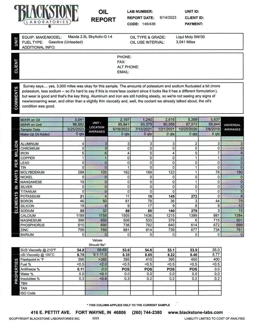

My latest report is attached, a total of 7,000 miles since using Bar's Leaks. It seems that Potassium in the teens (ppm) is out of the danger zone for bearing wear. Not sure about Sodium as I'm not there yet. As Blackstone guessed, the fluctuation in K and Na is because I used Mazda coolant to top -up after the flush but the shop obviously used another brand (It is important to fix this since mixing different brands can result in an undesirable pH - ie: rust inside the engine).
Your experience level is evident in your posts, so I know you'll keep the oil change intervals very short, at least until you have a fix in place. I hope my posts/data help you through this situation.

Unfortunately my last report showed higher potassium than yours ever got (in the 400's), but sodium never got as high as yours. My iron levels have been running higher than yours since I started getting reports in 2019, but that's likely from excessive idling time from my wife sitting in the school pickup line for an hour every school day. I hate that she let the car idle for so long so often.
I have a different vehicle that has high Iron for a similar reason (remote start and warm-up in the driveway during cold mornings). I've seen identical results at the end of each of the last 2 Winters - 31ppm iron. The universal average for that engine is 18ppm.
If your numbers are significantly higher than that, it is likely the coolant in your oil is causing premature bearing wear not school-line idling.

I was getting 14 to 20 ppm on iron for as long as I've been getting the oil tested. 25 this last time which they said was likely due to the coolant not lubricating bearings as well as oil does.
