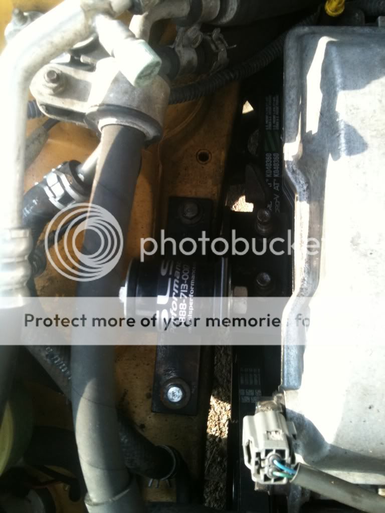

Well the timing belt snapped the other day and had to have the car towed, they messed up my Chargespeed lip a little.. And I installed the SLS passenger mount, I keep forgetting to make signs for the front motor mount I'm selling

Let me be the first to say. Start saving for another pass side mount and throw that sls s*** in the trash. I had one fail on me big time.
Looks like no engineering went into that mount at all. If you did a simple FEA analysis on the computer of that thing, it would probably show huge deflection.
