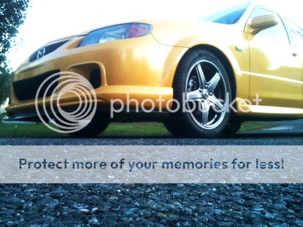

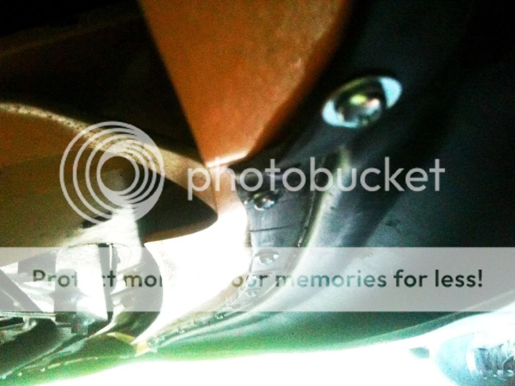

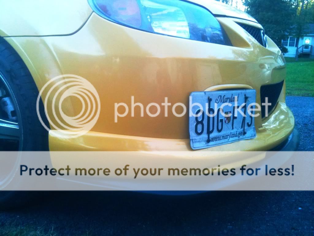

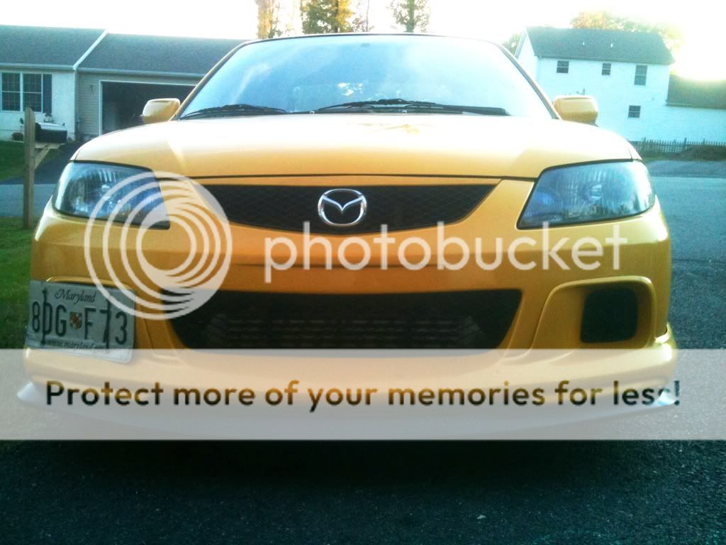

Fixed my heat/ac controls today, long over due. Here's some pics of my new Chargespeed lip destineal asked for.
AKA never falling off, FTW!!!
