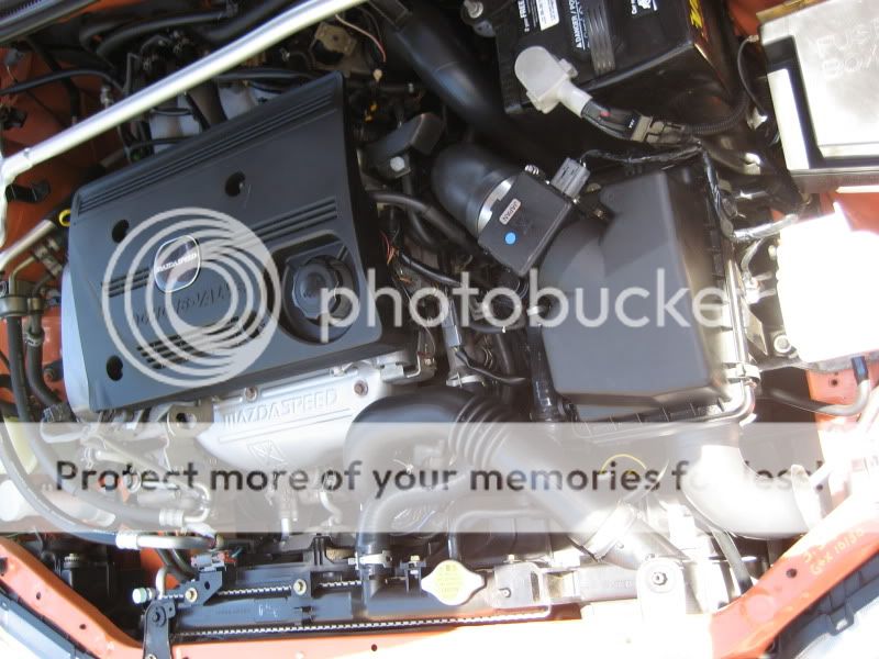

I have mine installed, and this is the way it has been like for the last year, and I didn't move it since stock and the honey comb side is on the filter side, and the arrow is also pointing toward the turbo(direction of airflow), but the actual honey combs are on the side going into the filter/fender
here is a pic of my first msp before I did the smic/cai/hardpipe install, everything is stock completely, and no one since then had touched it but the mechanics doing reg. maintenance at mazda since before I bought it.
(in this pic, the honeycomb is on the side towards the airbox)
