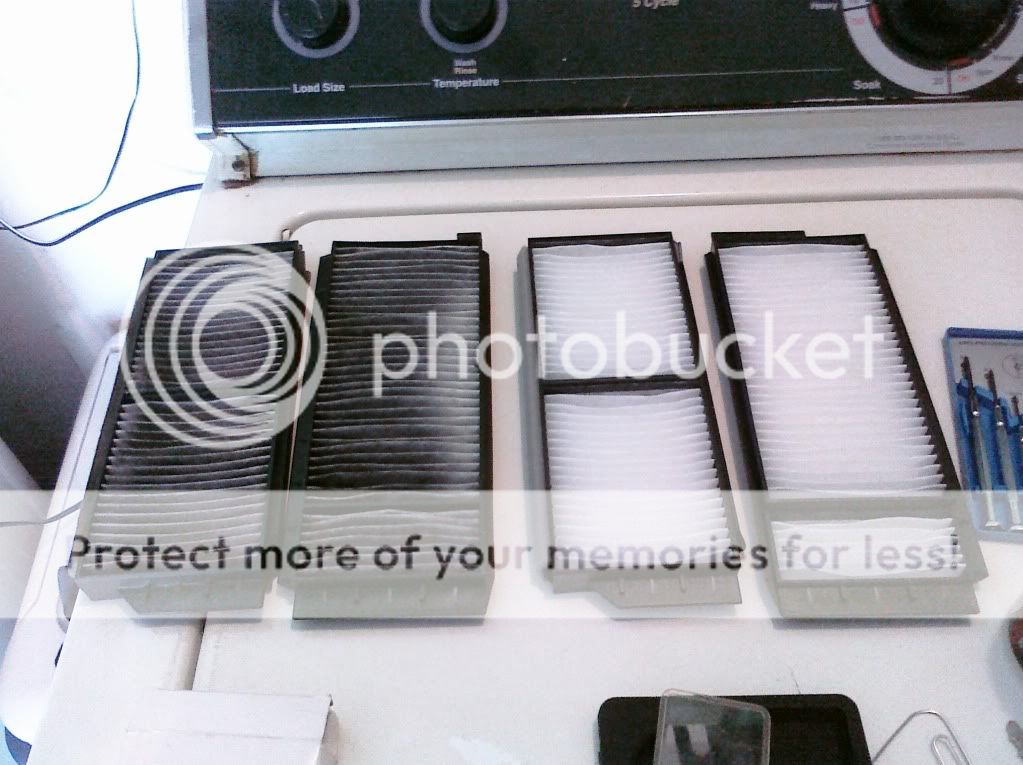

Changed my cabin air filter (@ ~31K miles):

how'd you do with the removal/installation? did you already know what you were doing or did you get some help from "how-to" or that youtube vid?
I've got a FSM, so I already knew what was entailed...
There's a decent video floating around too, but aside from it entailing about 5 too many steps and the fact that you have to work in an uncomfortable, awkward space it wasn't too terrible, I guess. :p
http://www.youtube.com/watch?v=GKhVXslh6Is
cool. i got the manual on adobe (which totally blows, id rather have it physically in a book with paper). i actually just did it myself a few weeks ago and the worst part for me was getting the new ones in because of the whole stacking crap
i was initially confused when i saw ppl posting pics of 2 filters. but then when i removed 1 and the other one fell down i was like "ohhhhhh....crap"

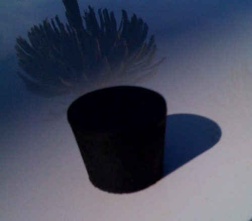

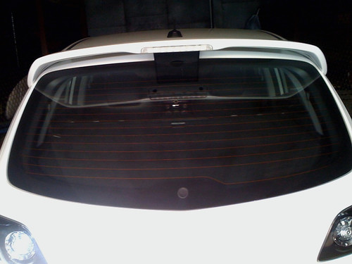

found a plug for the wiper delete at my local hardware store. 1 1/4" rubber "cork." fits perfectly and cost me $1.65.
(sorry for the bad cell pics, but just wanted to give you the basic idea.)
