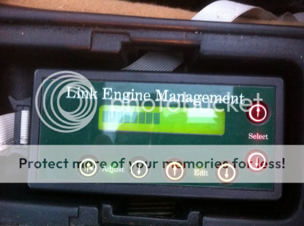

plugged in my LINK ECU keypad to attempt to set the ECU to read the new AEM wideband but the keypad lit up like this and that is all she'll do
