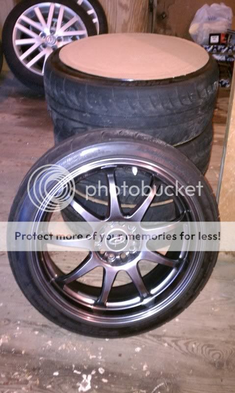

I drove up to Vermont this morning to pick up Julie's new shoes from a fellow forum member:
Rota P1s in hyper black with some useable Potenza rubber. I should be able to get through the summer with them. I was gonna wait to put them on when I finally install my H&Rs, but I'm not sure if I can wait... :p

RPMs. Or, spend the coin and get the AutoExe ones. I ran H&R springs and was plowing in the winter.
I had the money and should of got AUTOEXE H&Rs are too low especially with the front Lip from Autoexe/next mod..
Im gonna end up buying those probably later this year from Corksport. But Im gonna get wheels first im thinking 19x8 with 225/40 that will increase my OD and raise my car about .3-.4 inches which would help alot because im barely scrapping in the front
