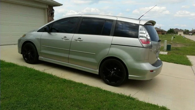

is that the optional wing for the sport model
looks a bit different than the stock spoiler.
took the thule rack off for the season, not going to be any home projects during the winter that I need to carry anything large.
