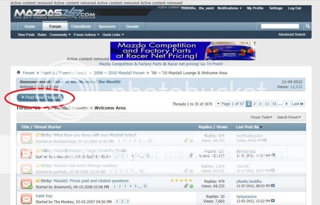

HI Im new here and I am not totaly sure how to navigate to post a question or start a thread, so if anyone can help I'd appreciate it. Also, while I am here I might as well ask if anyone would have the torque for the oil cooler on a 2009 mazda5. I had to make my own gasget for it till I can afford all that I need to make a perminate fix. $$$$$$ =(
Here is where you post a new thread. Just pick what forum you want to post in and click this...
...as for torque specs, sorry, I got nothing.
