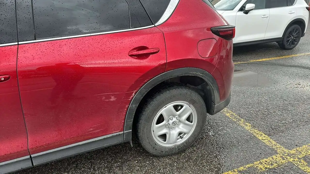

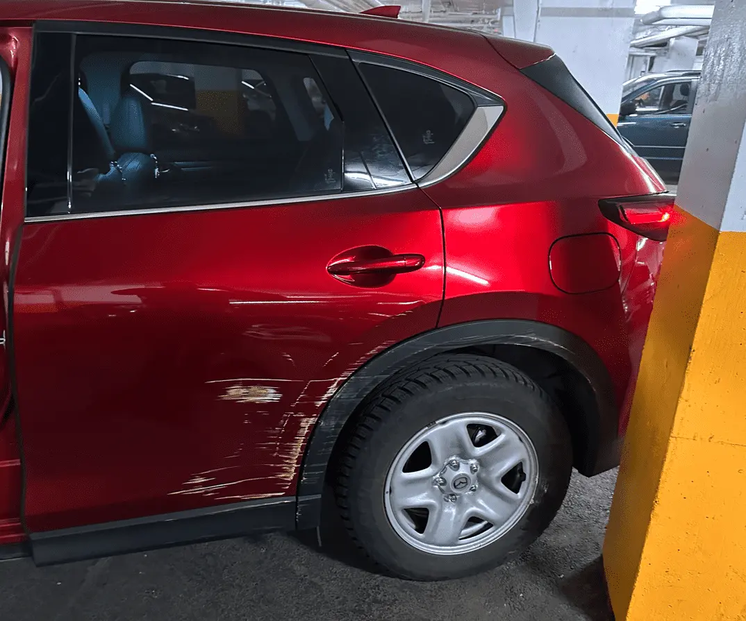

Hit a column while pulling out of my parking spot. I was understandably really mad at myself.

Looks like something I did recently involving a similar incident in a parking garage, and you better believe I berated myself over it. How much did that run you to fix?Hit a column while pulling out of my parking spot. I was understandably really mad at myself.

The overall cost was $2500 Canadian, I just paid a $500 deductible.Looks like something I did recently involving a similar incident in a parking garage, and you better believe I berated myself over it. How much did that run you to fix?
Ah. Insurance. My deductible is sadly at $1k to stay semi affordable in my area. Not worth that much to me to fix. A few hundred, sure.Yeah, they did! They apparently painted parts of the rear fender and the driver door to match the colour.
