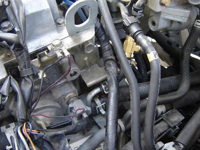

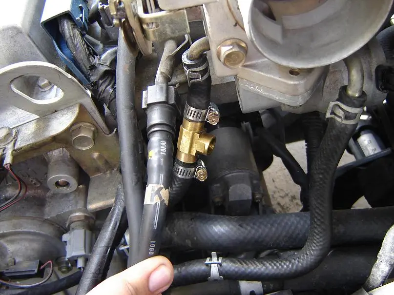

here are the pics of my set up. thanks for the help everyone.

So you just went in the TB line instead of the heater line... that works too! (I don' thave that line as it keeps the TB cooler to keep air charges down...)
yea i was about to say...i was going to attack a different line and that couldn't be right. but yea, i might do that too but if teflon works fine then i dont see why i would need to.
