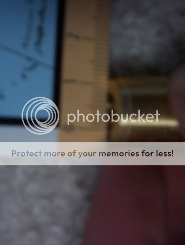

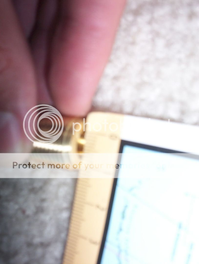

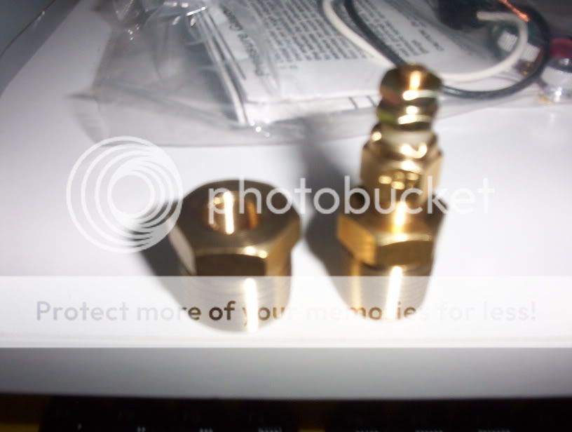

alright thats fine. i can wait for pics. i measured the inside of the sensor so i could get the measurements. those millimeters dont sound right. i got like 8mm out of 1cm. here are some pics. i'm not sure how they got those numbers. i also found there is -27 on the gauge sensor.
i measured the inside of the sensor. and got those readings. so i dont know what size that would be on the greddy temp adapter. and yea, that is higher than i thought. but i found they are having labor day savings for 20 bucks so thats only 3 dollars right there.
the sensor itself is 1/8NPT which is close to about 3/8" diameter and is about .405" .. but the therads are technically 1/8-27 NPT. and I thin the hose size would work out to like 18-25mm roughly for the inner diameter of that hose.
so then what greddy adapter would i use for that? 30mm? i dont see anything smaller. damn, i better find a one or a bigger one so i could use the bigger adapter that came with the sensor in those pics. all these numbers :confused:
