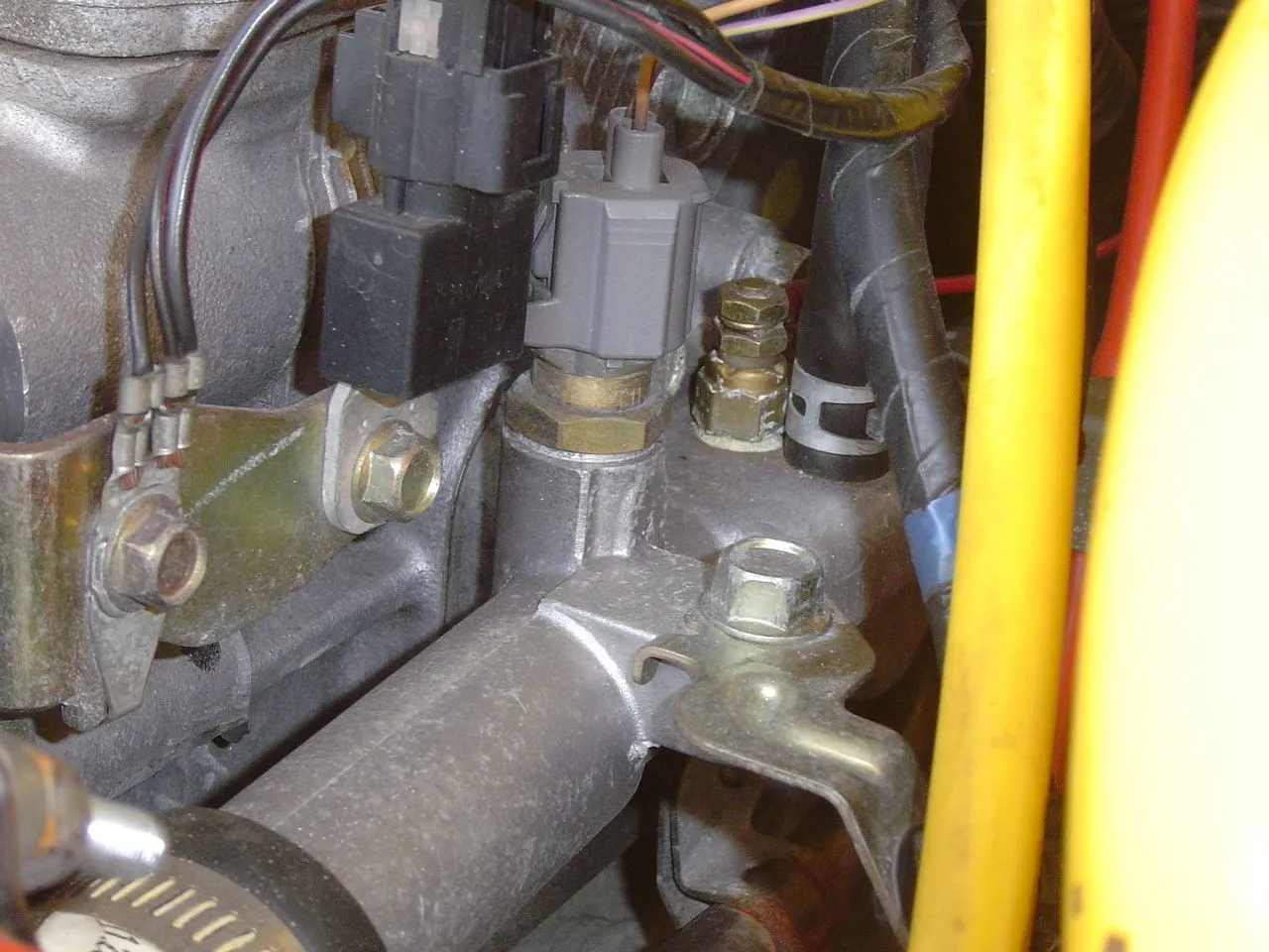

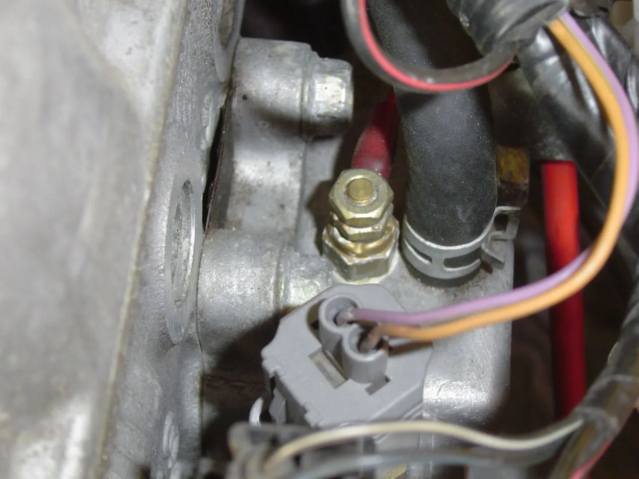

Thanks for the tips, BT, I think I will be doing this this week. Can you post a picture with the location of where you tapped into the housing? Or at least hijack one of these pics and photoshop an arrow on it? THanks!!
Here's some pics of the sensor for ya.

ty bigg tim. i'm about to cut into the hose now, just waiting for it to cool some more. them be some mighty good fluid fingers (thumb)
