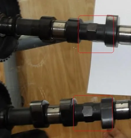

I've just noticed that my set of cams doesn't have the part circled in the pic, is that going to be a problem with the install?
If you're referring to the "hex" head then yes, they enable you to put a wrench o nthem and turn them to align the timing belt. Not that you can't do it without, but it's not the best way...
Thats what im worried about, its going to be a pain in the ass!!!
