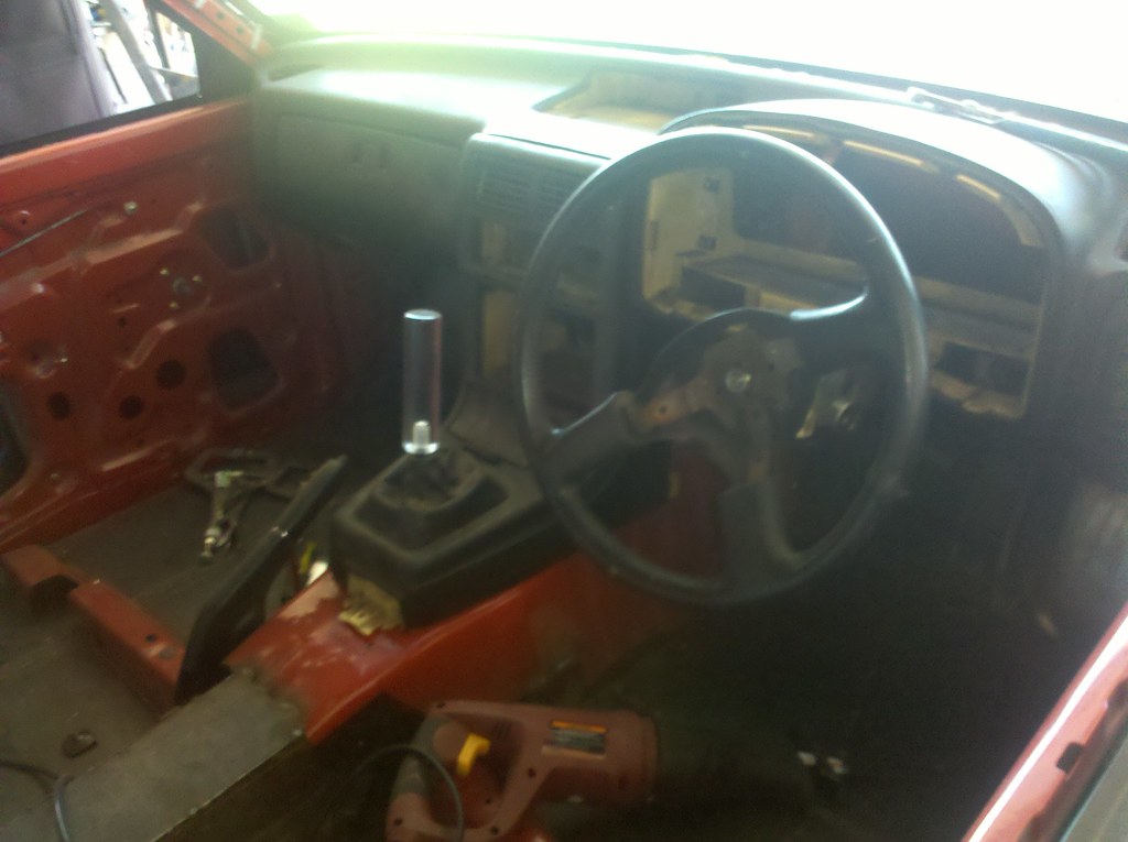

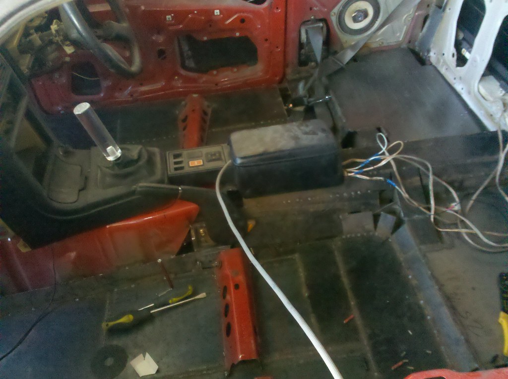

been getting a couple hours here and there between jobs to do work on the truck!

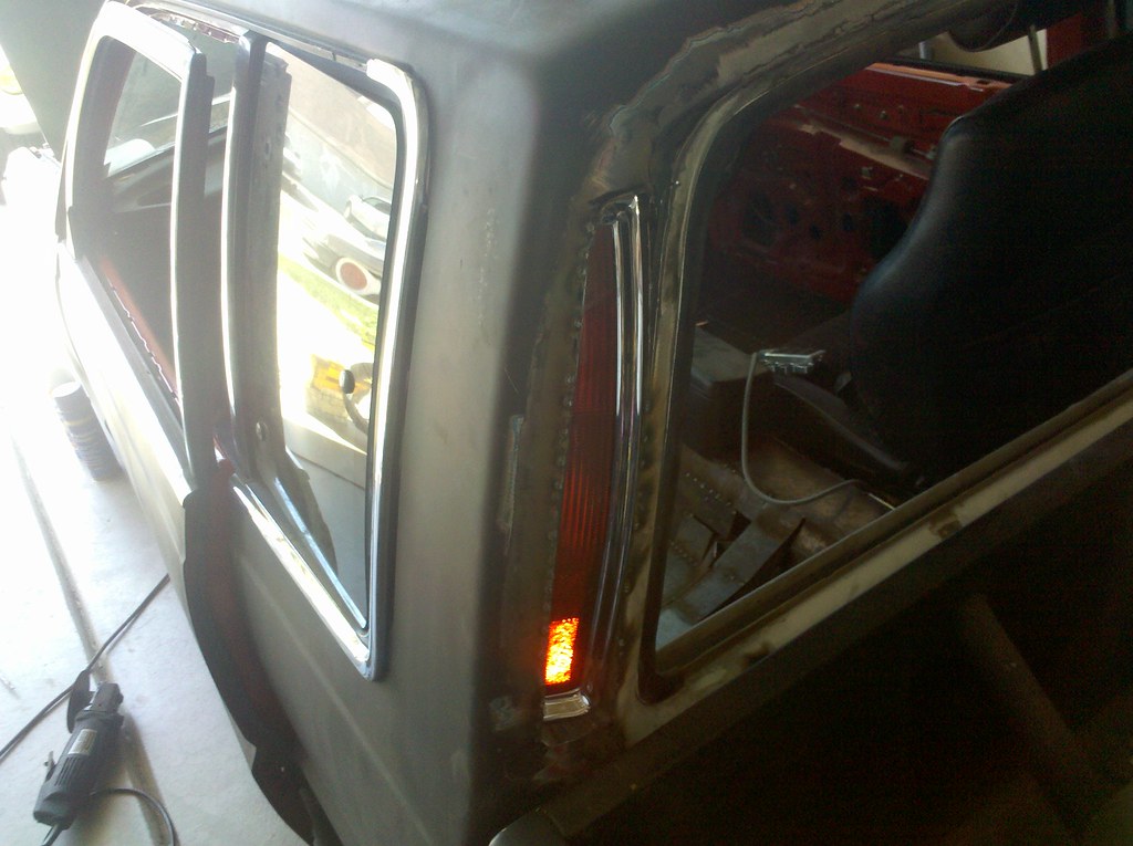

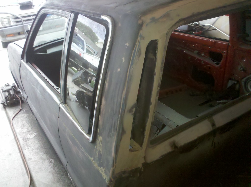

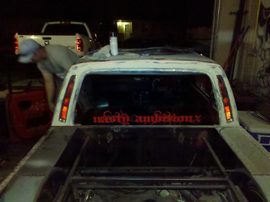

ive been fighting the steering for the last couple of days, and a couple knuckle prints in the door of the house later, i decided to move on to something else. im pretty much over working on the cab of this f***ing truck, and i dont wanna mess something up cuz im angry, so i moved on to getting the taillights in and done...
so i tacked in the buckets and then trimmed them the rest of the way and then stitch welded them up...
just needs some finish work and itll be ready for mud!
so, i did the passenger light, then i moved to the driver side, and s*** wasnt going my way(imagine that) so i said f*** it and move onto bigger and better things!

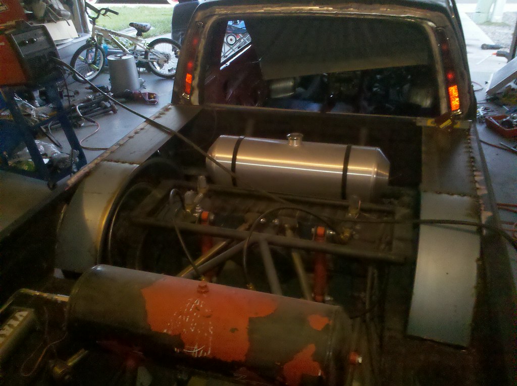

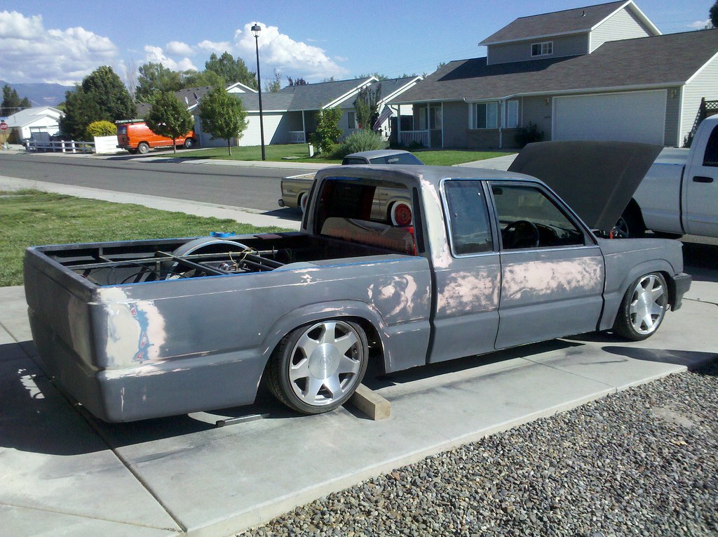

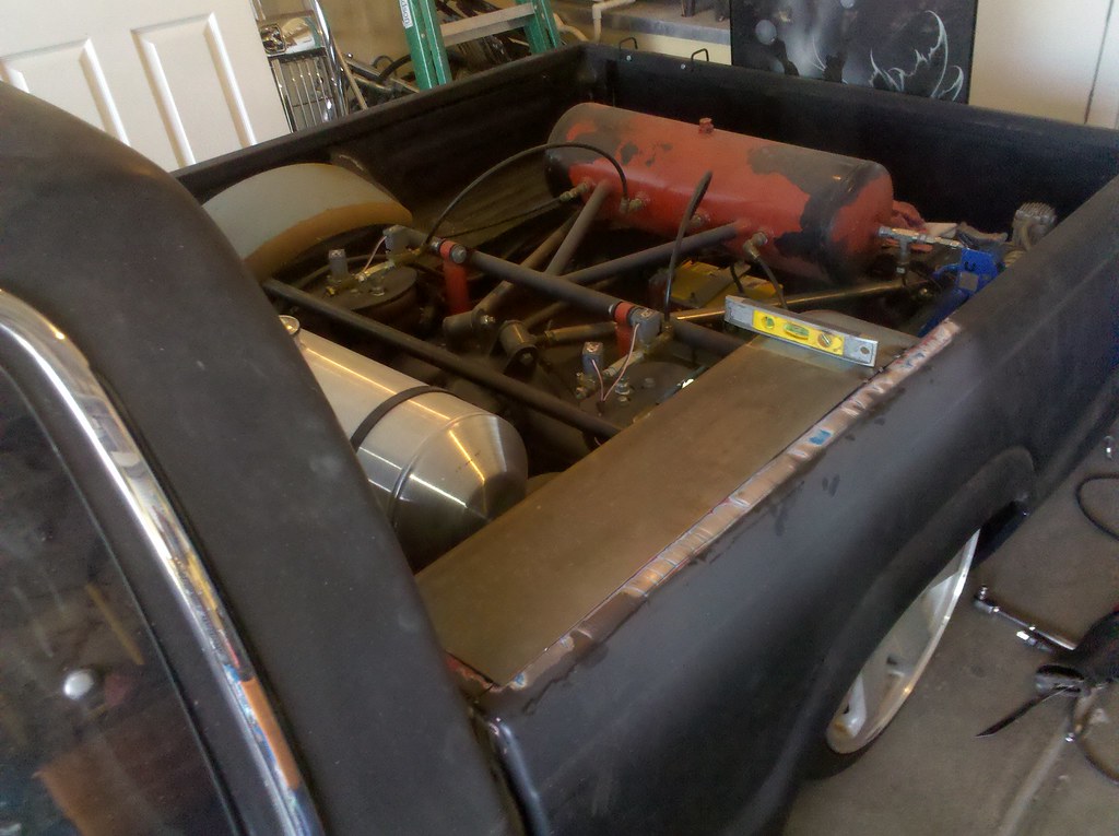

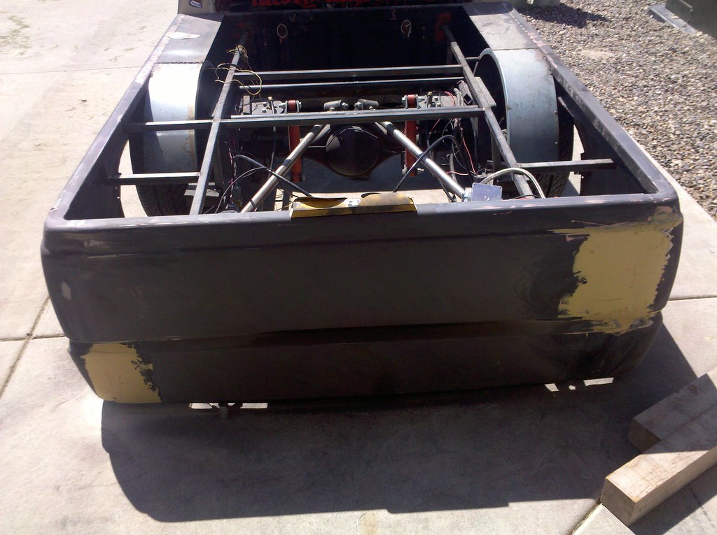

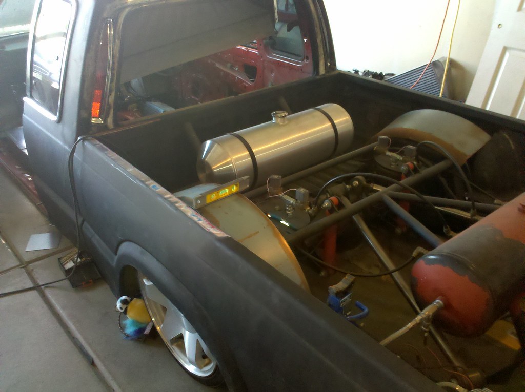

my buddy has been working on tubbing his bed and all that fun ish, so i got the bug to start on my bed. its nice to start a new project, even though i havent finished many lol, especially because its a lot of cutting and welding, whic is what i really enjoy doing, so i decided imma redo my whole bed setup and so it begins!
the arduous task of cutting everything that is unwanted out of the bed begins!
i hve been thinking of what i want to do to my bed for sometime now, and so it was finally time to put my plan into action. u will always end up changing things up a bit as u do them, since it looks different in real life than on paper, but u guys will get the basic idea of it. i am getting rid of the aluminum fuel tank and getting a poly race fuel cell and also using a smaller air tank and hiding my valves for my bags...

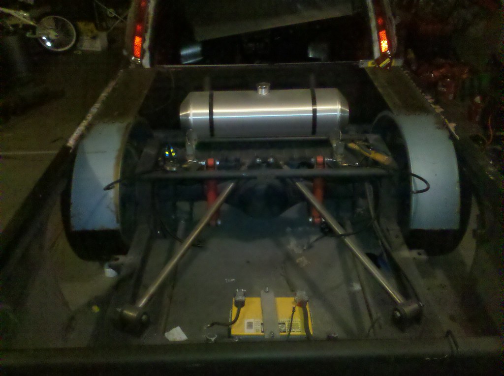

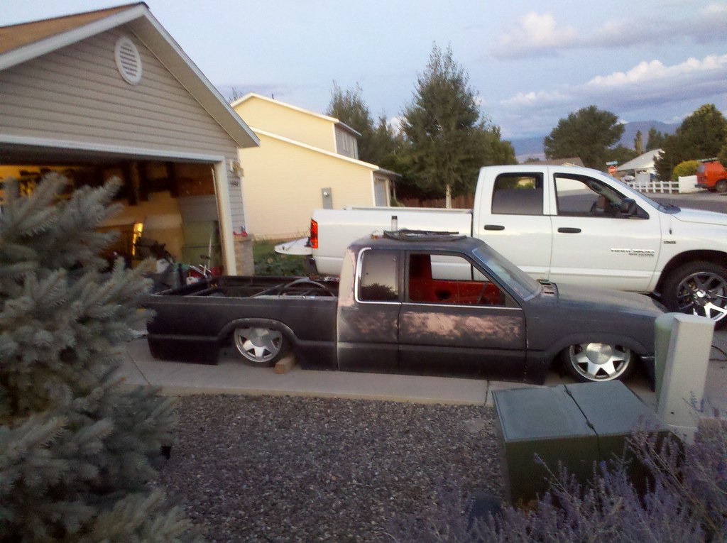

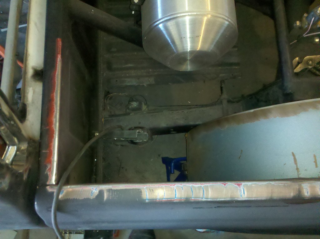

i see bare frame! gonna have to fab up some new bed mounts!
measure measure measure...
the first side is easy, but replicating it on the other side is the tough part!

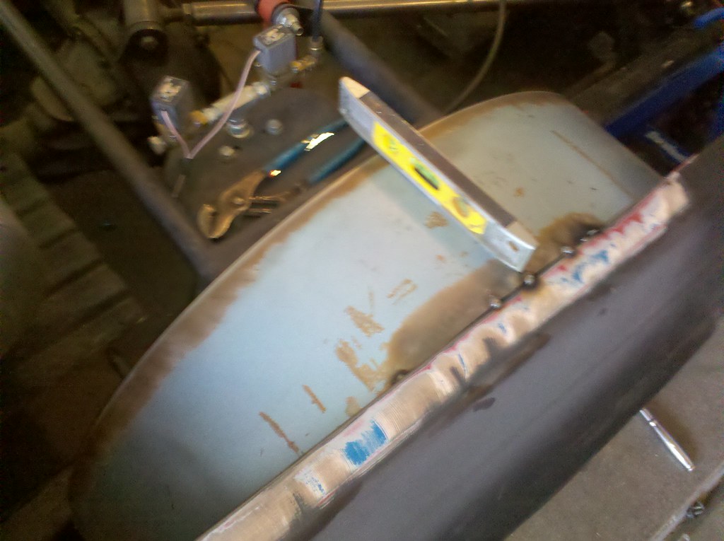

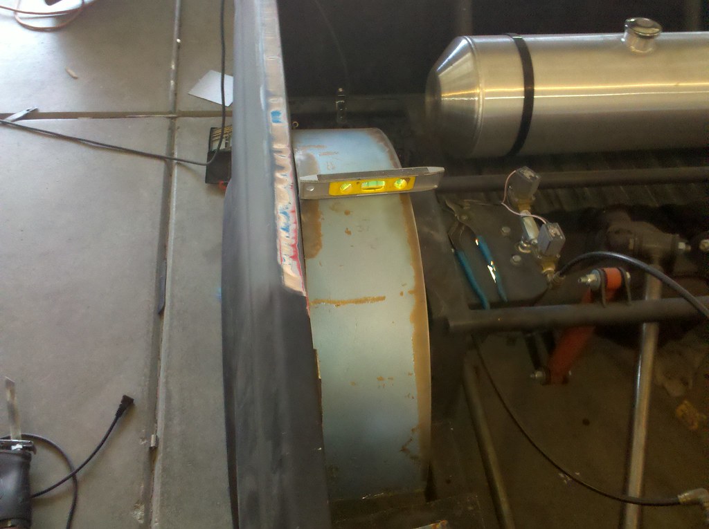

tacked in place and level as phawk!

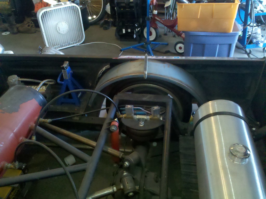

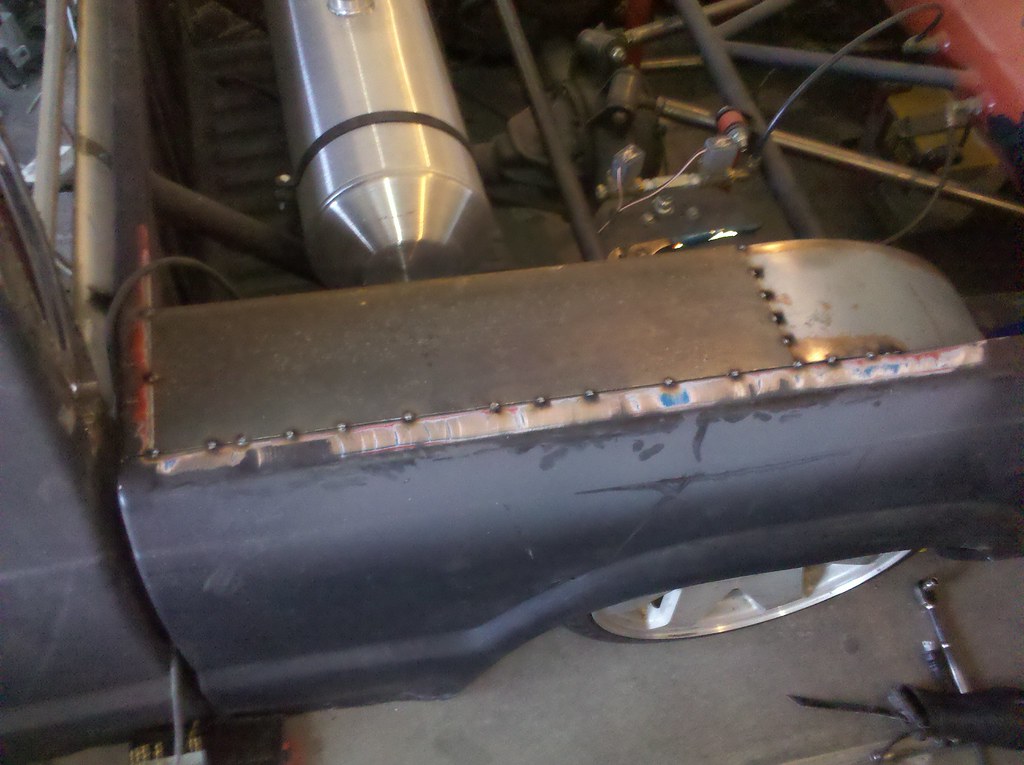

so basically the rear fender tubs are going to be the reverse of the front tubs in the engine bay...
u get the idea!
tacked..

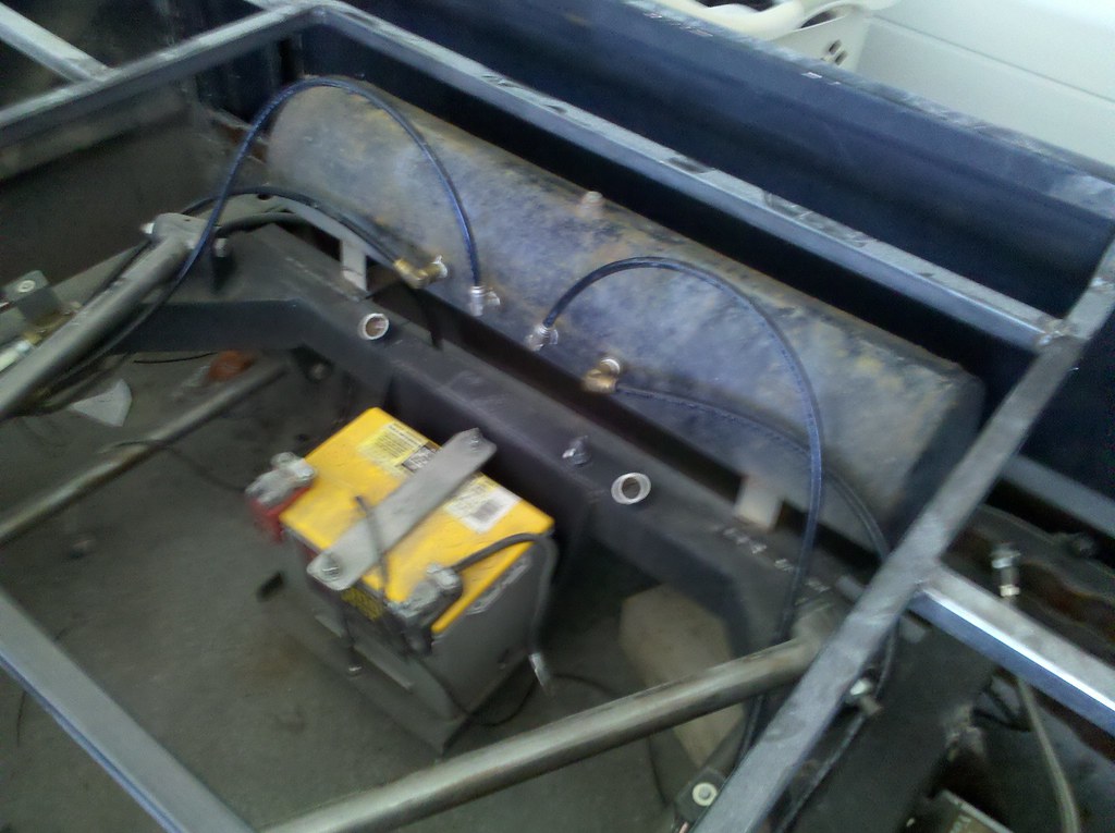

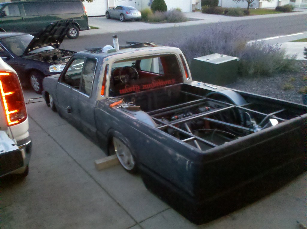

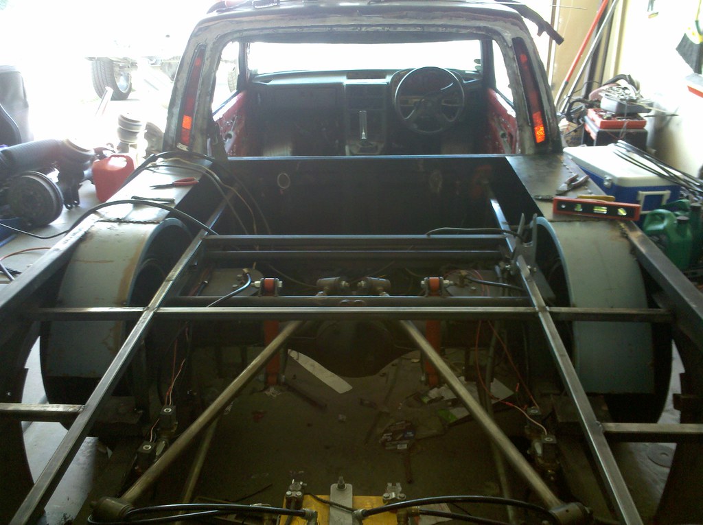

there is going to be a lot involved with this bed including building a whole new bed frame under it using 1x1 square stock for rigidity like i did on the floor of the cab...
all tacked in on both sides...

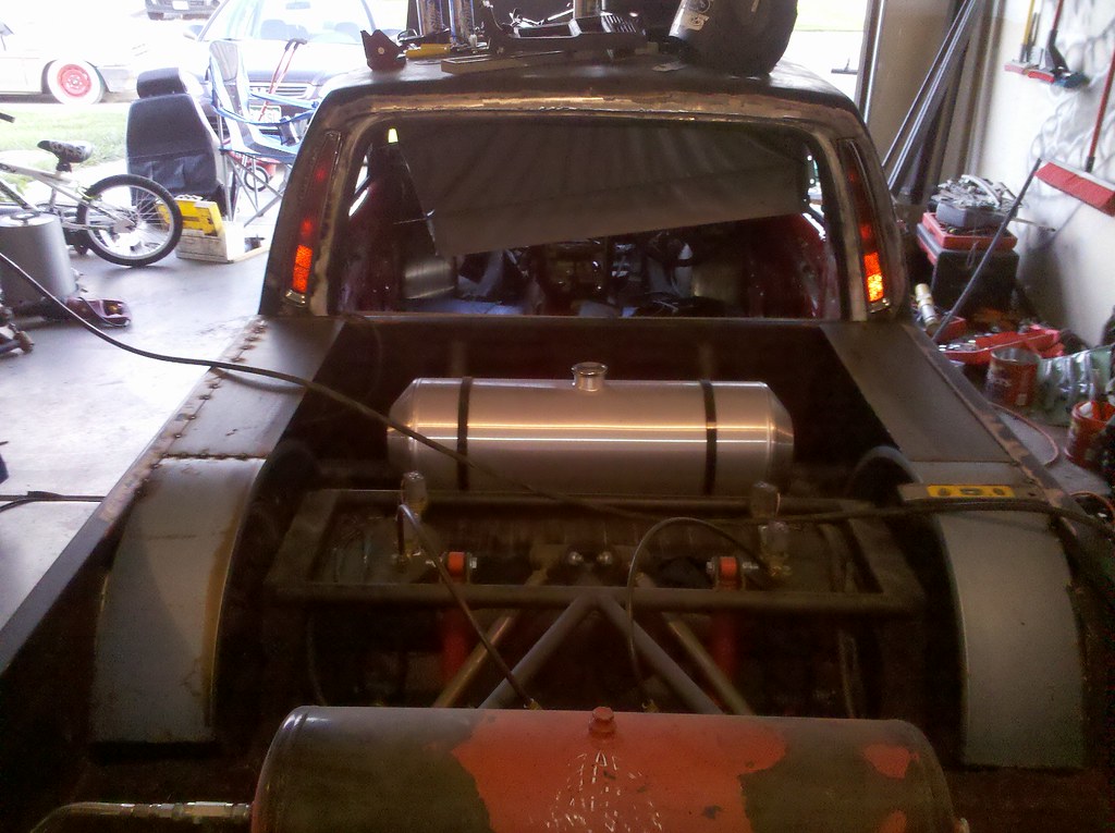

ruh roh raggy! air tank gone!
gas tank is also gone now along with the valves off the top of the bag mounts. everything will be relocated and hidden! u guys r gonna love this!
