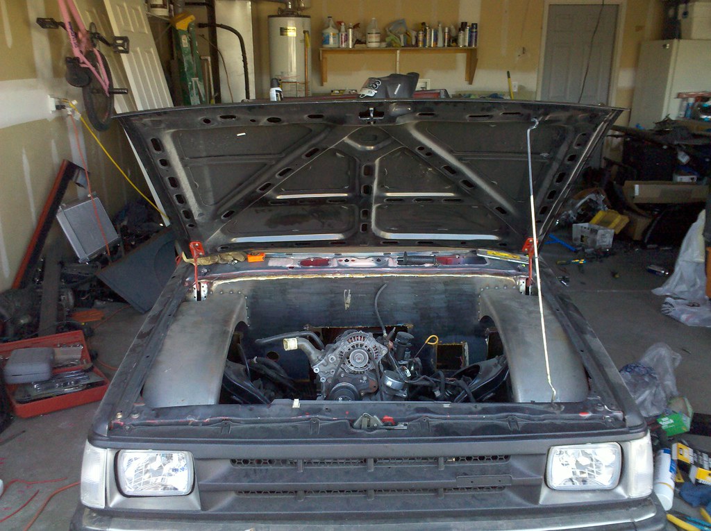

I like the way the engine bay cleans up with the inner fenders, if will great when painted and finished up.
-Derrick

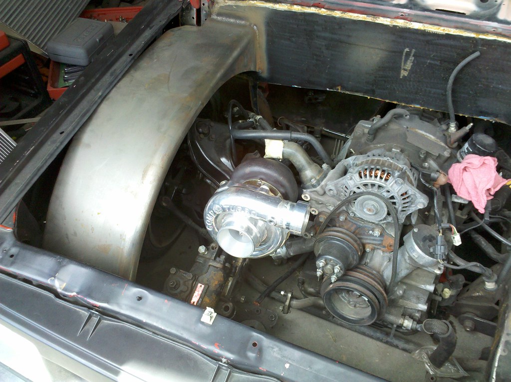

With the engine bay partially mocked up I can see why you were concerned about space. Have you gotten the whole intercooler/radiator setup figured out yet? Remember, these spinning triangle engines are very sensitive to the cooling system. I highly recommend an unobstructed path for airflow to the radiator and if you're adding an e-fan I also recommend making a shroud for it if you intend to idle in one place for extended periods of time.
-Derrick
thanks a lot. ya its starting to come together. now if i could only get some days off...
ya, space is killing me right now. i have an intercooler and a radiator, but im not entirely sure either of them r going to work. oh well. nothing like buying expensive parts and then not being able to use them. but if its not in the cards, then im just gonna have to figure something else out.
i am very familiar with the problems of heat and rotaries, and will be running electric fans also. and i was planning on fabbing a cooling plate/shroud for the radiator, but thanks for looking out!
once i get the turbo mounted, then i can work with piping and such. its gonna be a tight b**** in there especially with the steering on the same side...

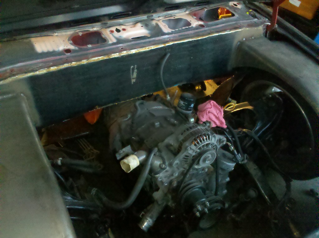

so i decided to cut out the portions of firewall that i had holes in from previously mounting my steering so i can start fresh and not have as much body work to do when it comes that time, so tape a line and cut them b****es out!
god i am just making more work for myself...

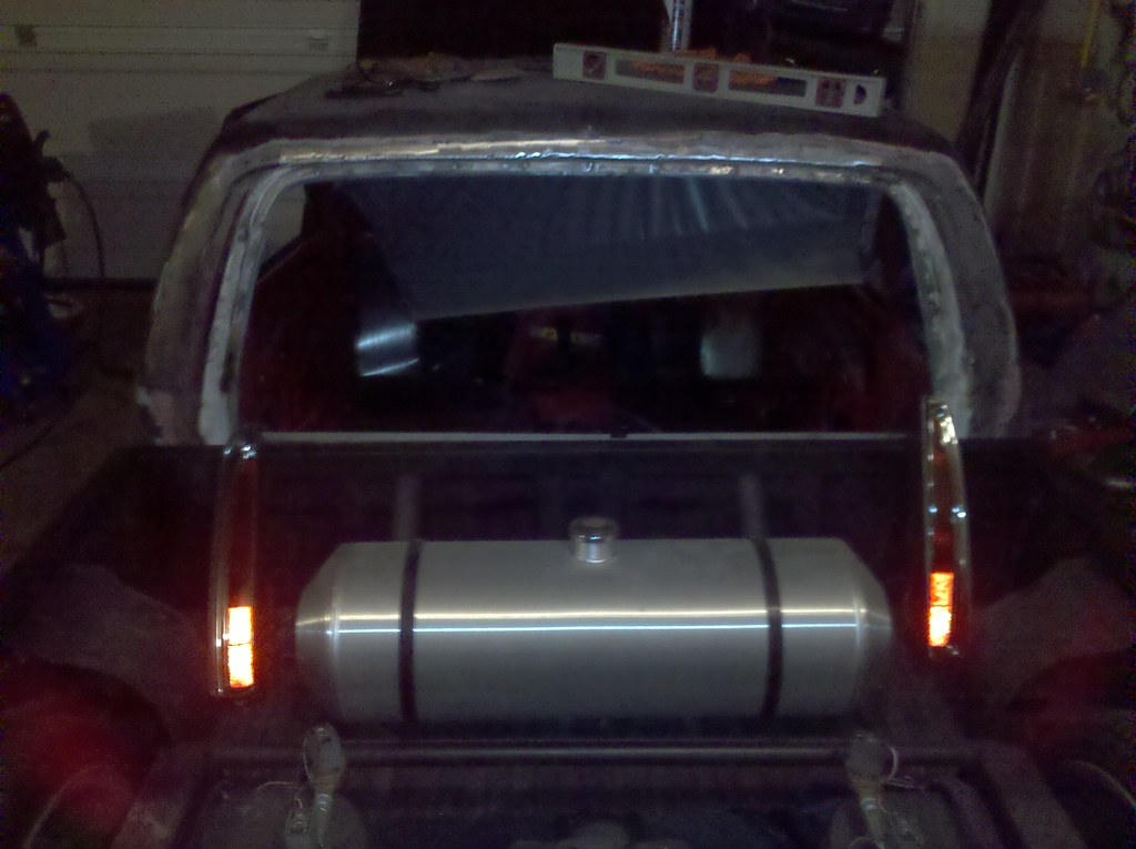

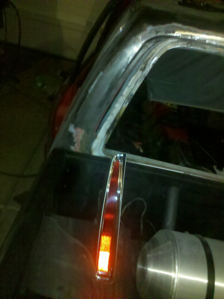

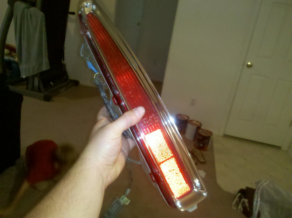

so heres some 94-99 cadillac deville taillights. i always swore i would never use these tails since they have been done to death on minis and fullsizes alike, but i have a different plan for them... since the toyota rear window was two inches narrower, it left me some free space on the back of the cab wall to something unique( i know what ur thinking, my truck isnt unique enough right?)
so i took some measurements and did some comparisons of the caddy lights and they will flow perfectly well on the back cab. thing is is the caddy tails are meant to be sunk in about 4 inches, so i am going to do some custom work and make them flush mounted. thoughts?
anywho, i think itll look nifty...
you get the idea...

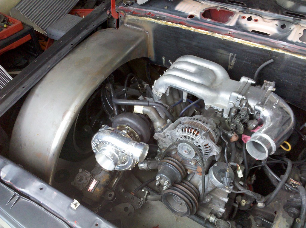

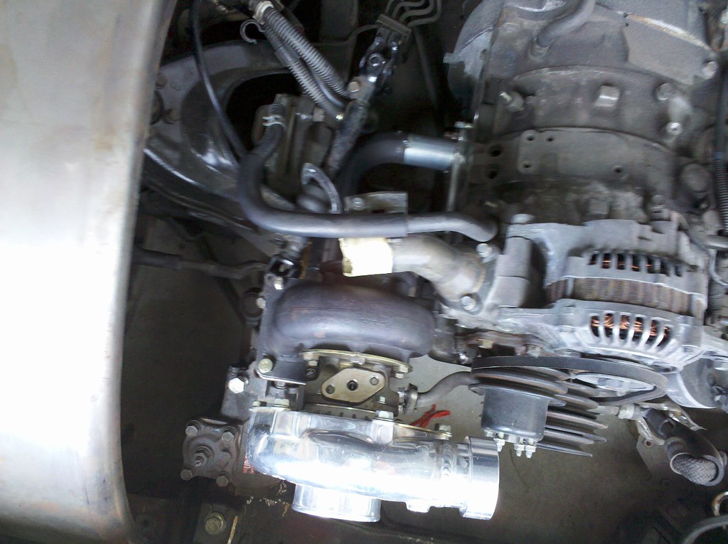

I HAZ A TURBO MANIFOLD!
ok, so he finally came over and everything test fit good! so he is taking it for final tig welding and to mount my wastegate. he promised it would be back in my hands by the end of the week!
and i hope u guys r proud, i actually snapped a few pics this time!!!!!
i am so excited, i am still shaking from seeing it all mocked up! now i can get on finding a new intercooler and figuring out my radiator and all that fun shizzzz!
fitted with intake manifold! yaya ! ! ! ! ! ! !

and how are we supposed to guess whats going on in your head? but seriously those tails are gonna look sick unfortunatley i have no clue how you will get them flush and damn i was starting to think there was no manifold. im glad you are moving along.

Mmmmm! I can had Turbo Manifold??
I really like those Caddy Lights! Should make for a unique setup!
ya, itll be funky, thats for sure..

on how i am goin to flush mount the tails, its a secret lol. jk once again.
i will share my secrets...
first i will cut the hole for the buckets to sit in. then i will put the lights in the buckets and set the buckets in to the point where the light sits flush. then i will tack the bucket in. then i can weld it from the inside and then all i will have to to is trim the excess off and then finish it off with a grinder. voila! flush fitting caddy tails!

Normally I'd say that caddy lights are played out, but I've never seen them in this configuration so it's going to look awesome! And as far as I'm concerned, your truck is one of the great builds out there. Not many people can think out of the box and put it into action and you're one of those people so don't sell yourself short. Oh and we're expecting a 1st class win when you finish up the truck and enter it into a show.
Have you looked at the "v-mounts"? Due to space you probably can't get away with the setups I see on a lot of FD's but I image you could do something with the radiator/intercooler so one isn't blocking the other. Something perhaps like how the radiator/oil cooler is setup on the FC? Then again, that would require you to move the oil cooler or do something different (dual oil coolers in front of wheels?).
