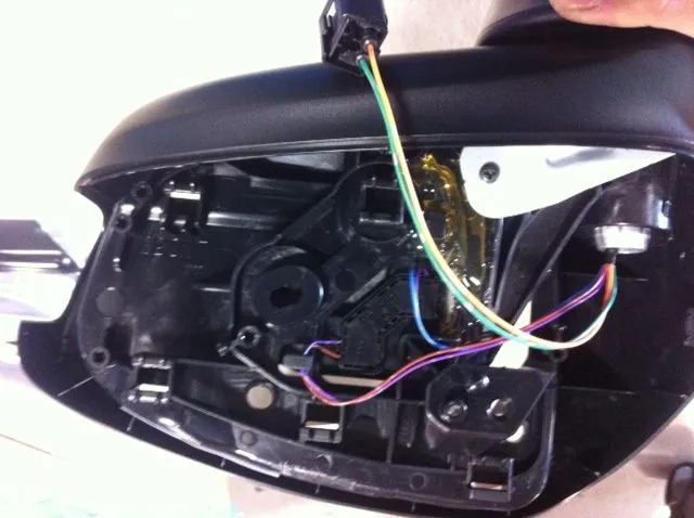

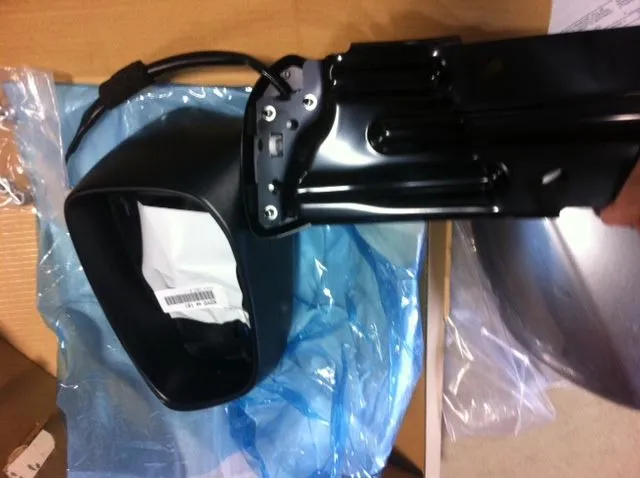

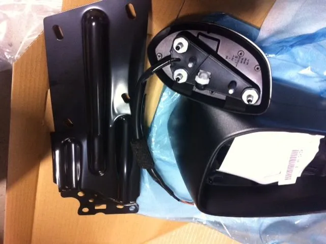

I'm at the dealer will post pics later
New mirror assembly
New bracket inside
I hope it works......yes no more vibrating mirror !!!!!
attached photo of the inside bracket and note the new mirror assembly they put some kind of glue behind it now. old ones didn't have that.

Ticket 018831
part KDY0-69-181
plus 1-2 hours of labor, first year production will always have things like these, just hope that is all, so far no big issues with drivetrain. is just weird that R side have no bracket and no issues, I wonder if it is due to some kind of engine harmonic or vibration, the tranny is the L side.
