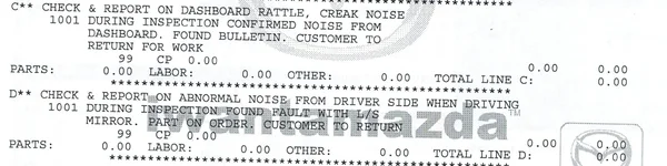

I had my first visit to the dealer three days ago and complained about the rattle in the dash and the shaky driver side mirror. Dealer ordered part to fix both issues. Apparently, it'll take 3 days to get the part in. I have to return to the dealer this coming Friday to get the part installed. I didn't get the chance to obtain the TSB but it looks like it's already out based on the service invoice I got (see attachment).
Did you happen to get the name of the parts for both? I am going to my dealer tomorrow and would like to give them as much info as possible regarding these items.

Unfortunately, I didn't get the chance to get the Info of the parts. I will get the info when I return this Friday and will post back.
Update: I returned my car for the dash rattle and side mirror fix. Turns out, the part for the side mirror is in backorder and will take 4 to 8 weeks to arrive. With regards to the dash rattle, it was fixed and there was no part required. I spoke to the mechanic and he indicated that the issue I have was different than the TSB I found here for the dash rattle. He had to take the dash down and insert a foam in place where there was a metal contact (don't ask me where). The rattle is gone. For the side mirror, dealer will call me once the part arrives.
