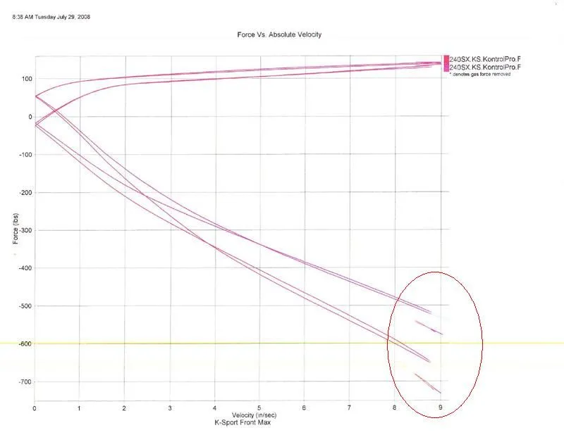

Here are some graphs that you requested
Ksport Fronts on Max Setting
K-Sport on Min Settings
K-Sport Rear on Max Settings
K-Sport Rear on Min Settings
Overdampened shocks can cause a harsh/bouncy ride.
You can see from above, the shocks are clearly not even remotely close to matching. I guess the quality control back then could be that bad? Who knows..

on the first chart, what caused the break circled in red here?
10"/second is the peak velocity, so the ramp up to get up there is how it calculates the other displacments as the crank shaft on the dyno moves 180 degrees at a time for the full 360 revolution. If we were to run it at 10"/second then yes, it would be constant on rebound/compression.
10" per second is the standard rate for us because we feel that is about as much as a car would see on the street/track. I know Koni NA tests 10"+/second.
It's from the gas pressures from what I've heard. I'm not 100% sure myself.

Another paper caught while printing. Sorry :(

eureka! ok, so essentially this is not a CONSTANT velocity plot, but a CONTINUOUS velocity plot. the angular velocity of the crank on the dyno swings a full 360 degrees from zero to compressive 10" / sec, back to zero, up to rebound 10" / sec and back to zero again. measurements are taken continuously rather than at discrete intervals (or discrete intervals are so short as to be negligeble) is this correct?
this would mean that the velocity plots you posted are ALSO continuous velocity, right?
probably right. at the angular velocity required to accelerate through 10" / sec, there probably isn't enough time at V0 for the pressures to stabilize, so there is still a latent force in the damper.

very helpful, jeff. thanks for posting this information. to make sure i'm reading your graphs right (it's hard to tell pink from purple!), for each damper there are two sets of lines. the first compression trace is on the way TO 10" / sec. the second compression trace is on the way BACK from 10" / sec to zero. ditto for the two rebound lines. is this correct?
for comparison purposes, since i can't tell a color difference between the two lines, consider the first graph you posted. one set of lines has its origin at about 50 lbs at V0. are all four lines here for the same damper? thanks again.
so the 'smiley face' displacement plot actually plots force vs. displacement through 2" during which velocity is varied from 0 to 10" / sec, right?
