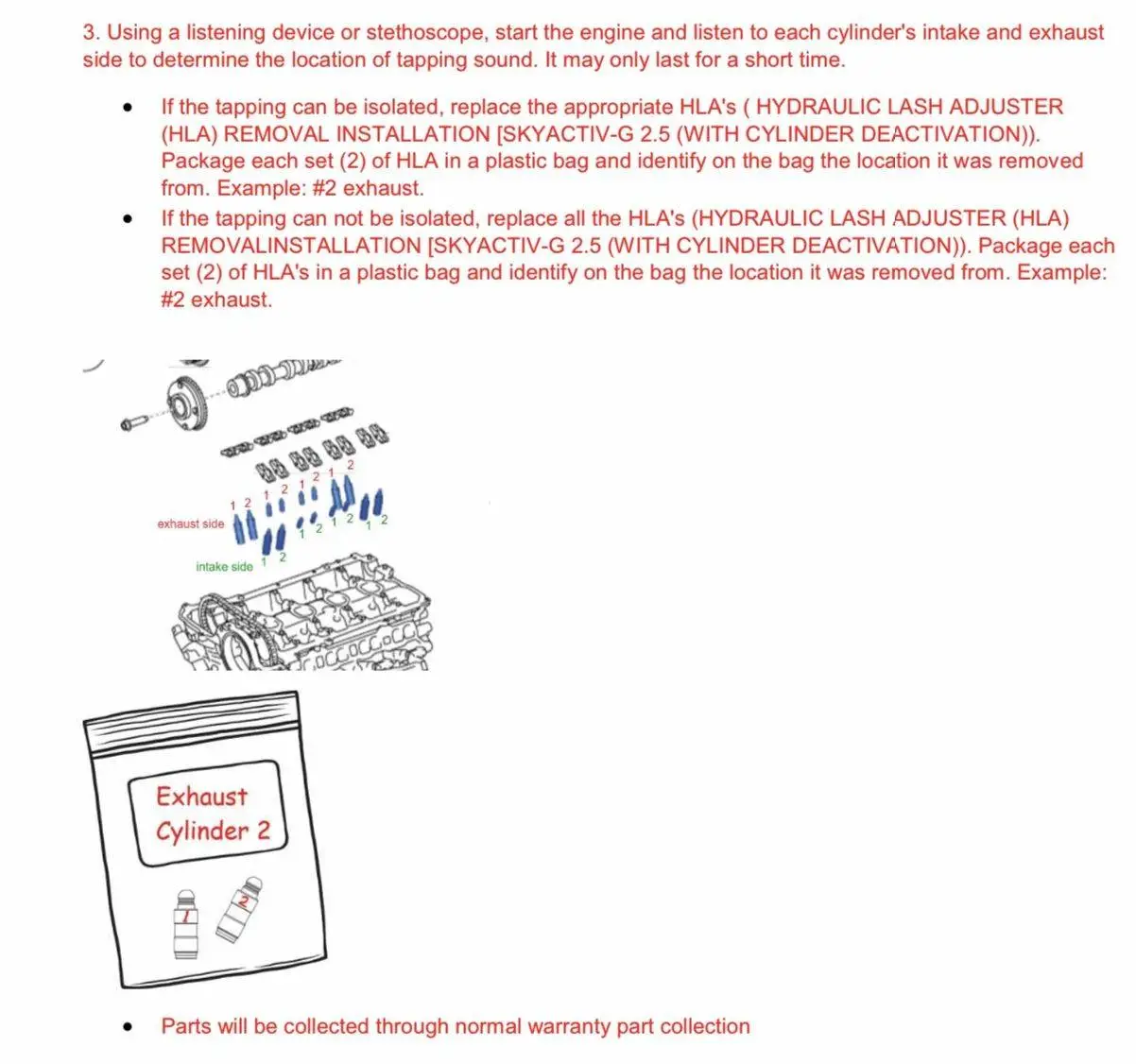

I had to do mine twice as well. After first repair, we smelled burning oil in the hvac all the time. Since Mazda warned us it might still smell from residual oil burning off, we didn't think anything if it at first. A week later, and I saw a decent amount of oil on my garage floor. Lifted hood and oil had sprayed everywhere under the hood! Like it was under pressure. I think it has something to do with the hla's and cylinder deactivation. They replaced my hla's for free shipping with a new gasket. Part number for hla ended in 100A which, according to dealer, means updated design. We'll see what happens. Now I've got this to contend with https://www.mazdas247.com/forum/index.php?threads/transmission-issues-loss-of-power.123875201/
⋯ They replaced my hla's for free shipping with a new gasket. Part number for hla ended in 100A which, according to dealer, means updated design.
There’re 2 different hydraulic lash adjusters / valve lifters for cylinder #1、#4 and cylinder #2、#3. Unfortunately there’s very limited info on these parts online. I found valve lifter PYFA-12-100A which should be the one your dealer was referring to, but can’t tell if it’s for which cylinders. Would you mind to post the parts info on your repair invoice?
