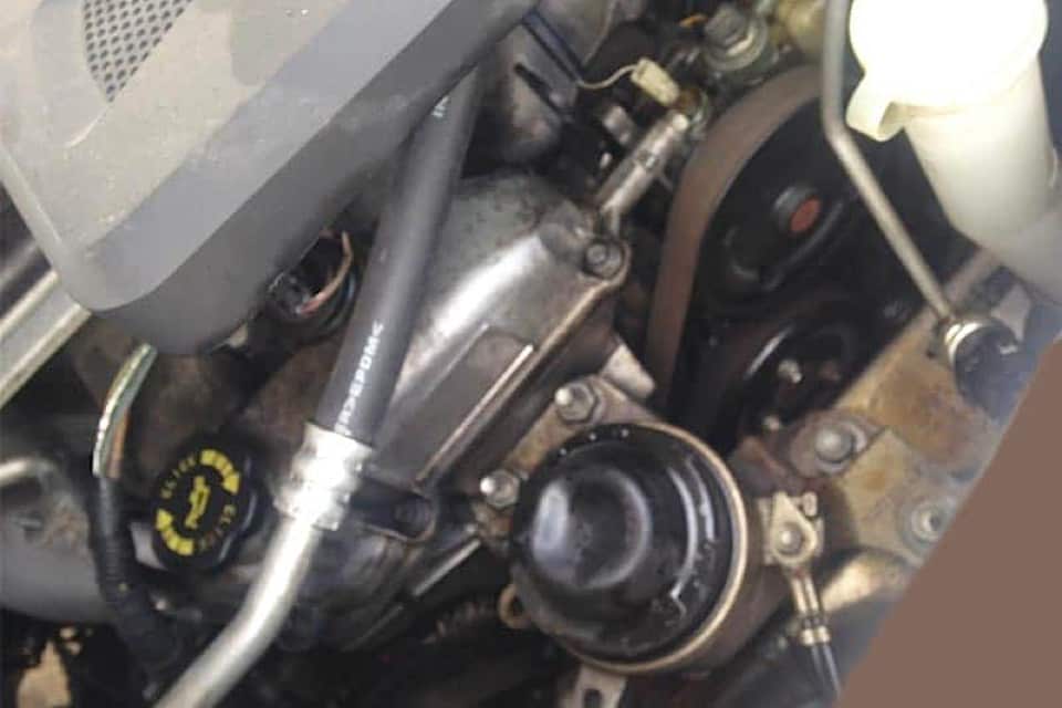

While driving (under 2,000 RPM), excessive stretching of the timing chain can cause a knocking / rattling noise.
Walkthrough on fixing it yourself:

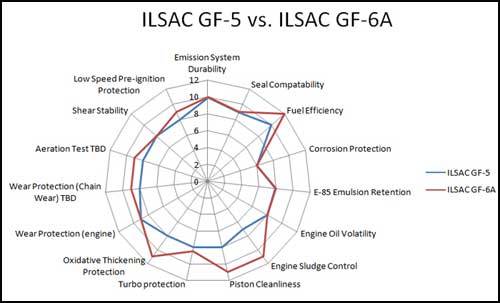

The new GF6/SP oil specs that went into effect earlier this year include reducing timing chain wear
Thanks for the update,I wasn't aware that this was addressed with a new spec.I wonder what they did to the oil and moreso,WHY they did this.Has there been a large amount of timing chain wear issues with the thinner oils that this was needed.I haven't heard.
Idemitsu 0W-20 SP / GF-6 oil claims the following improvements over GF-6 standard:
  • 30% more protection against engine wear
  • 26-46% reduction in oil consumption for longer life
  • Up to 24% improved fuel economy
  • 90% more resistant to viscosity increases
  • Three to four times more protection against cold startups
  • 91% reduction in low-speed pre-ignition (LSPI)
  • 6% cleaner engine
It doesn’t mention more timing chain protection though.

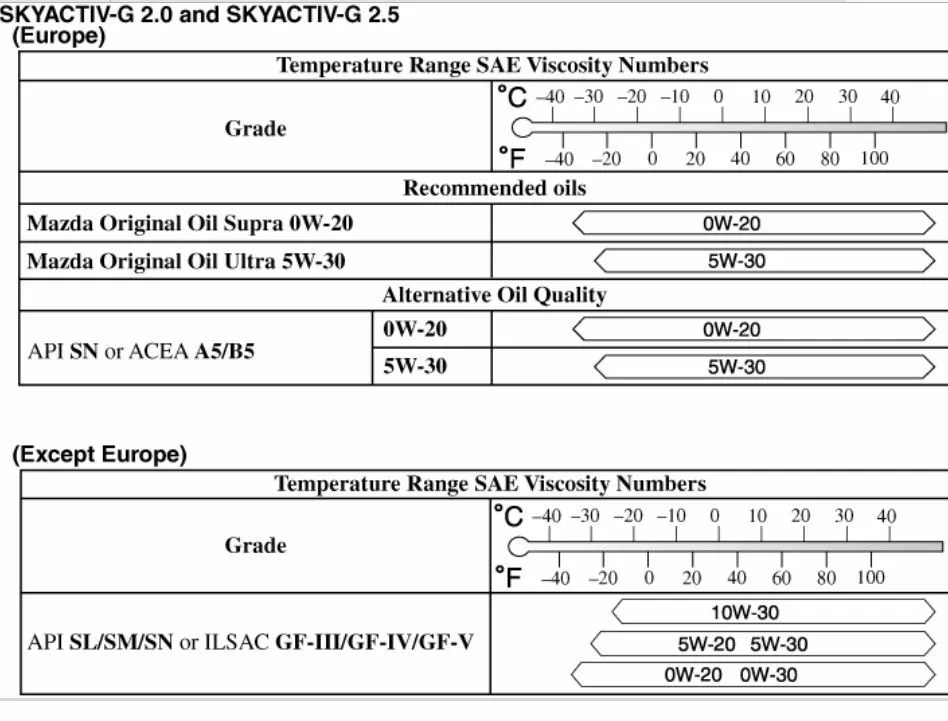

Yeah there’re plenty talks that watery 0W-20 oil would fail to protect timing chain in the long run. As for using 5W-30 on 2.5L, based on Mazda’s official viscosity chart we should have no problems of using it unless your winter temperature is below -25°F!
