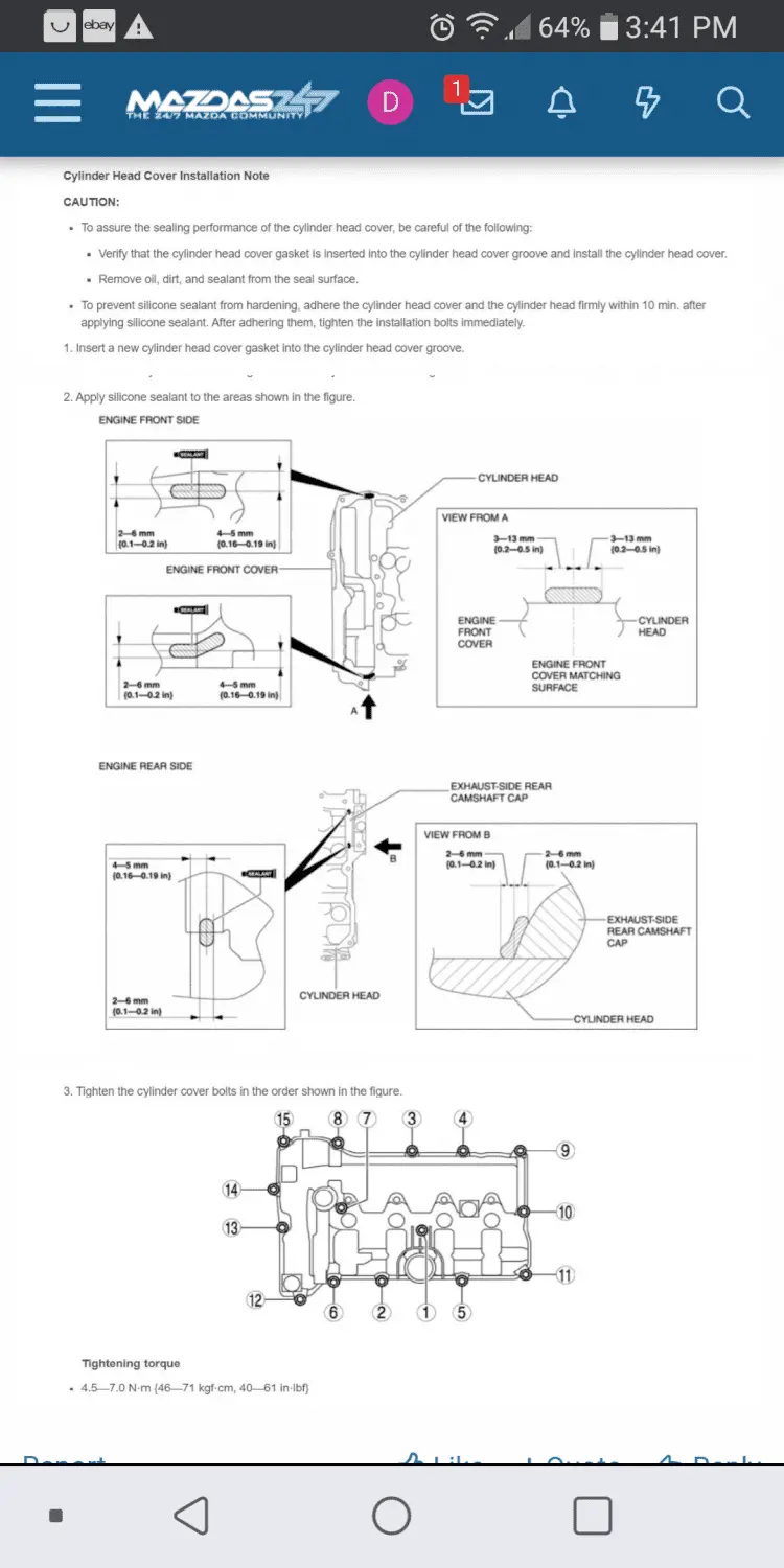

According to some mechanics, there are few spots on the valve gasket that you'll need form a gasket material on it or it will leak.
Jay
The image below shows exactly where the rtv goes.

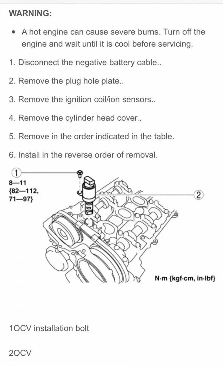

And yes, replacing the OCV is straight forward with one bolt once the valve cove is removed.

Its very easy to swap out the OCV, hardest thing about it is removing valve cover but you'll have that off already.
